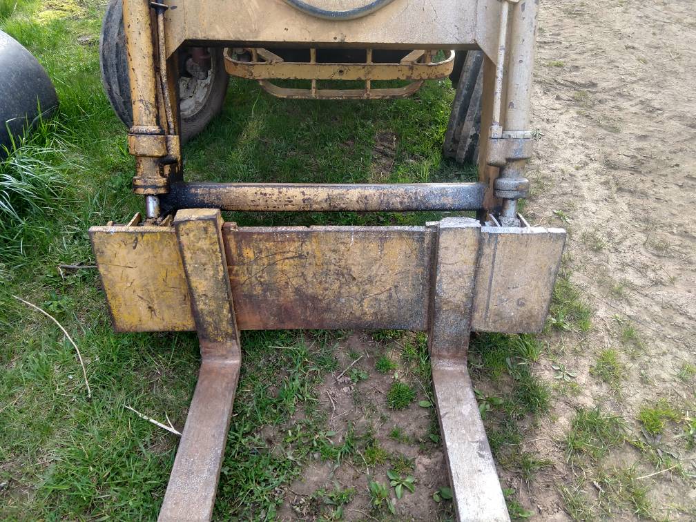

Have you had that fork setup long?
Need to make a set of forks for the front of our tractor and I'm planning on using bale spears like that, but wasn't sure if I could get away with them on the bottom (probably welded to a piece of 4x4 tube, or a piece of heavy C channel) or if I needed to go through the plate.
Aaron Z
I only made the forks during my "Covid-cation" recently but they've passed a couple tough tests.
The first was with that 10' pipe "Amish Crane" arrangement Amish Crane, Creek, Big Tree Stump - OrangeTractorTalks - Everything Kubota and the second was taking the weight of another tree trunk on one tine. Having seen the deflection (and return) of the bale spears under those loads I'm very confident about the long term survival of both the spears and the welds.
It took a while to decide how to attach the spears. The idea was to keep them very low on the frame so they could scoop under brush without dragging other mounting components. I did have serious concerns with just welding the round bushings to the flat bottom of the tube frame. One was that I didn't think I'd be able to get enough support with beads between the round and flat surfaces. Another was the bushings are about 2" longer than the width of the tube they're welded to. Seemed like the bushings deserved more connection than the 3" dimension where they cross the tube. Both of these were addressed by reinforcing each bushing with a few pieces of 1/4". Each side of each bushing has a piece that's cut the width of the square tube and a bit longer where they are welded to the bushing. Then each bushing also has a triangular piece that is welded to the front face of the square tube and the top of the bushing. Here's more on the build:
