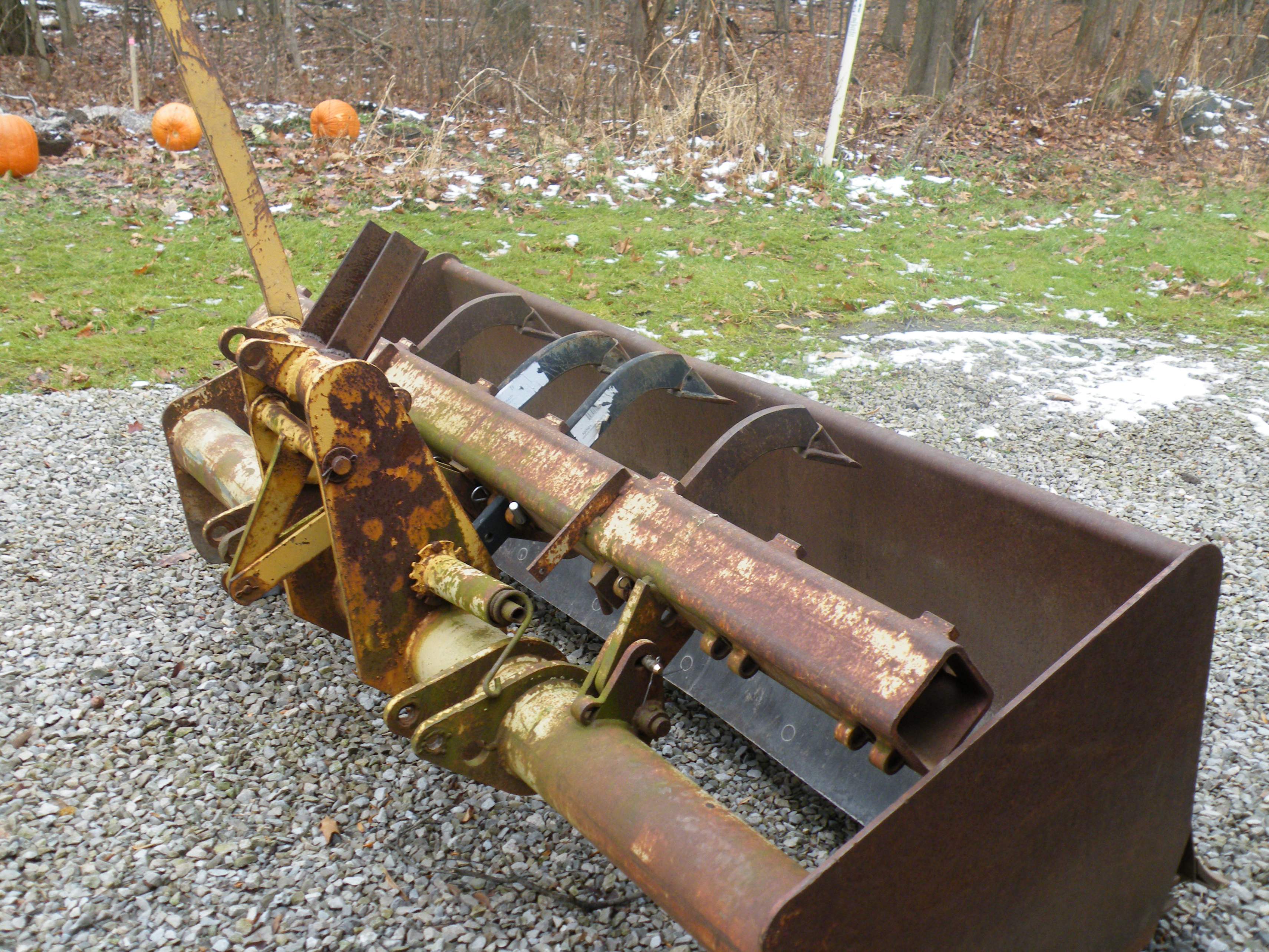

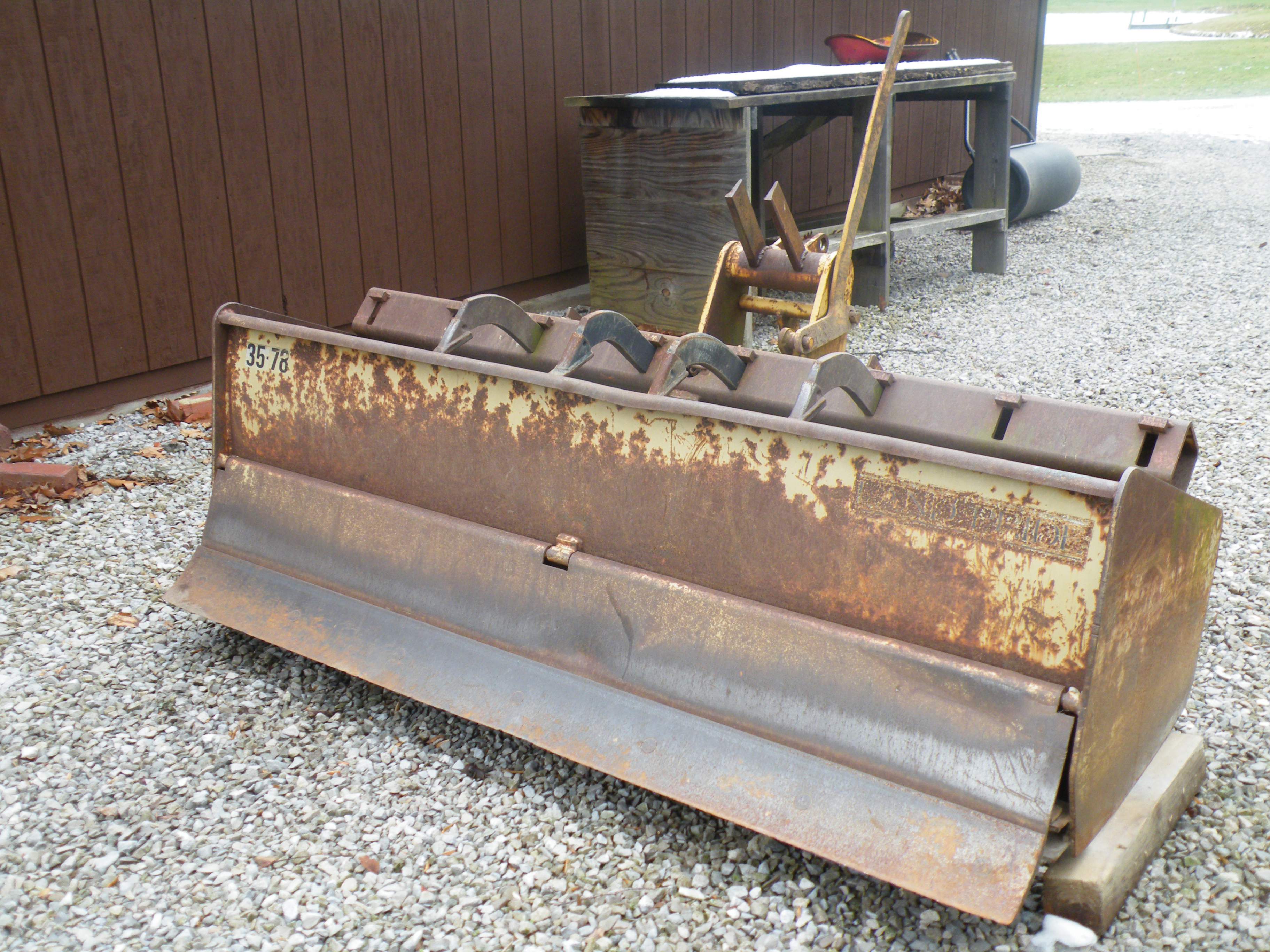

I have a 3578 at 1000Lbs.

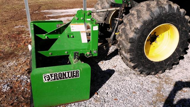

yes, a hydraulic top link, or maybe top and tilt, is on my list next from Brian.
I would have got it now but this deal came up and didn't want to miss out.
The blade is like new and I got it for much less than half of a new BB2072.
I know, ya want photos, this is the only one I have right now.
Grabbed it yesterday after hooking up to the tractor for the first time.
