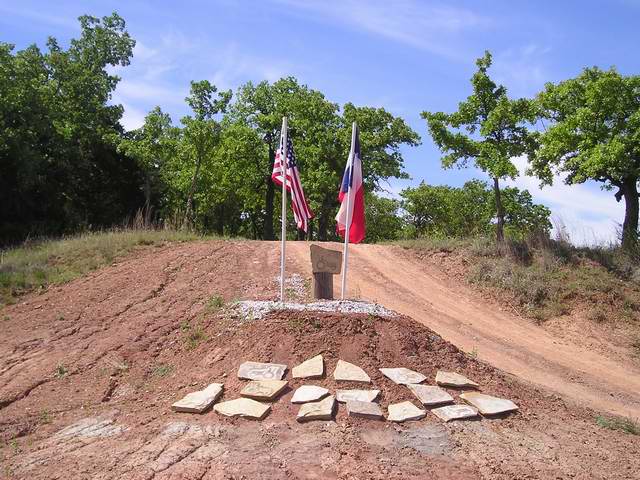

Cobra-R said:
I have a TC40 hydro with a factory cab, I drove mine up a hill in high range (empty) and it too slowed down to aprox 5 mph(it pulled the engine down and started smoking some black smoke), I am concerned that there is something wrong with it like yours.
I may be able to give you some comparative info that could be helpful. I'm attaching a picture of a small hill on my property that I cannot climb with my tractor in high range (rabbit or turtle) if I have the loader on (empty) and my boxblade on the rear. If I have the loader off and a mower on the rear, I can just barely climb this hill in high-turtle if I feather the pedal just right to get the most torque to the rear wheels. The engine may smoke out the exhaust because it is normal for a diesel to smoke a little under load.
I can climb this hill in either low rabbit or turtle without a problem, even with the loader on and a scoop full of dirt. I have other hills that are steeper and require low-turtle if the bucket is full, but those are really "suicide" hills. I have twice found hills (in my pond) where I could not climb them in low-turtle with a full bucket (double-full of wet mud) because the wheels would spin even with the rear differential locked.

Thanks Jim. I tried it on a road, and although not as steep, it was very long incline, the tractor continued to slow down more and more. I clicked it to turtle and the engine immediately recoverd and the tractor held it's speed firmly. I had the loader and a aerator on the tractor with tha a/c running on high. :D Sounds like there is nothing to worry about, thanks again.
Brian

In 10,000 years, there are going to be archeologist wondering about the tractor-centric society that was found in north-texas. There is going to be some head scratching going on. :)
Chris
