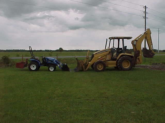

   / do not buy too big of tractor! #20
</font><font color="blue" class="small">( ...Lots of heavy work to be done by the larger tractor, but once it's done I'd have little use for it.)</font>
I told my dealer that what I really need was an incredible shrinking tractor. He relly tried, but closing his eyes and wishing real hard didn't work... /forums/images/graemlins/frown.gif
So, I bought small and am contracting big as needed with the savings. The attachment shows my tractor and one I'm renting on weekends for a reasonable fee...
