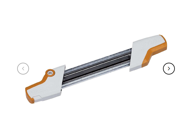

I use the Stihl sharpening tool. I was skeptical at first but after I bought one, and watched a video on YT, I love it!!!! It's fast, easy and gets the chain very sharp. It also maintains the height relationship between the cutting teeth and the raker teeth (aka heigth gage). Watch a video on it and you'll understand better. It's about $30 and you should get some spare round files but they are only about $3 each. Highly recommend this tool. I have the electric chain sharpener you get from Northern Tool but this far easier.

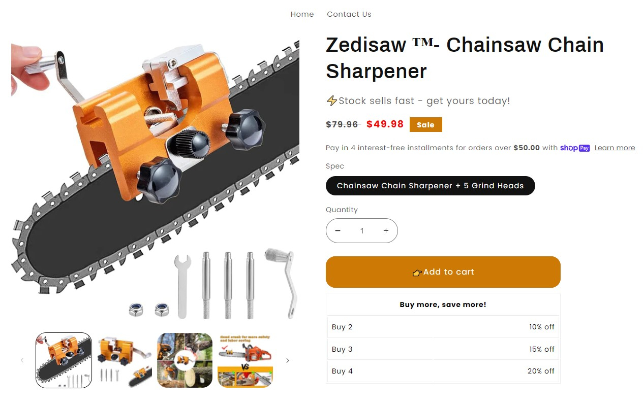

Seems that there is a flood of these sharpening tools for sale on i-net last few days, do they actually work..... Concept looks good, just can not believe its a quality produce for the $29 to $49 price sellers are asking, down from $79......
Other question is has many "sellers" seized on these as a "scam" to get you to order and they never deliver?....

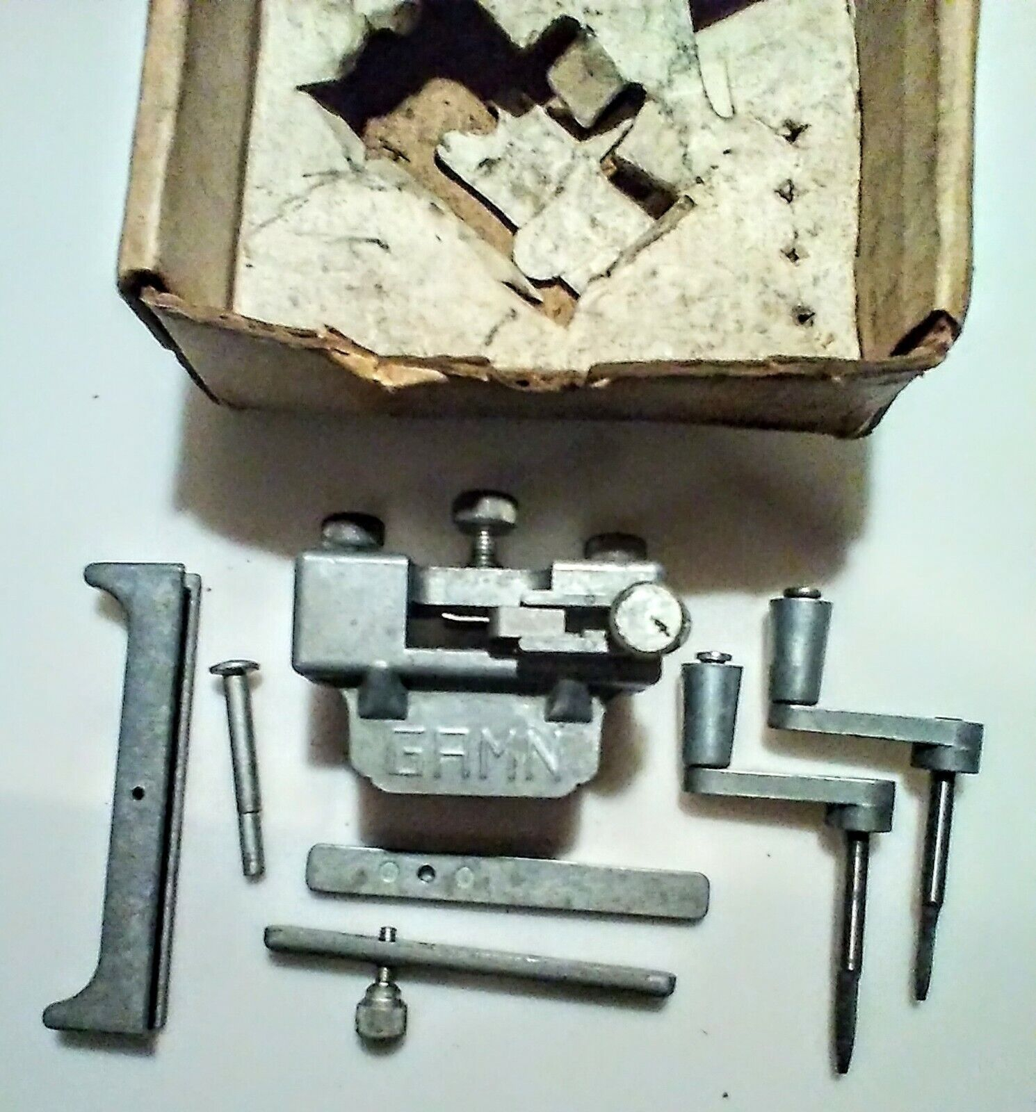

This is actually a Chinese Knock Off of a GAMN Sharpener patented in the '80'. I had a GAMN that did work, but I put the Carbide burrs in a battery drill and cut the teeth. At least this didn't burn the teeth. I don't know about these knock offs. Patent must have run out! Picture shows one on eBay currently.

So, I bought one on a lark- it works, barely and is certainly not an improvement over either a file with a guide or my Dremel chainsaw sharpening attachment.
Minor correction- the “ratcheting” feature is an improvement over either of my other sharpening tools.

I use the Stihl sharpening tool. I was skeptical at first but after I bought one, and watched a video on YT, I love it!!!! It's fast, easy and gets the chain very sharp. It also maintains the height relationship between the cutting teeth and the raker teeth (aka heigth gage). Watch a video on it and you'll understand better. It's about $30 and you should get some spare round files but they are only about $3 each. Highly recommend this tool. I have the electric chain sharpener you get from Northern Tool but this far easier.View attachment 773721
Yep, couldn’t agree more. It’s fast and works incredibly well.

I've tried a lot of sharpeners, but the only one that has given consistent results is the Stihl 2 in 1.
