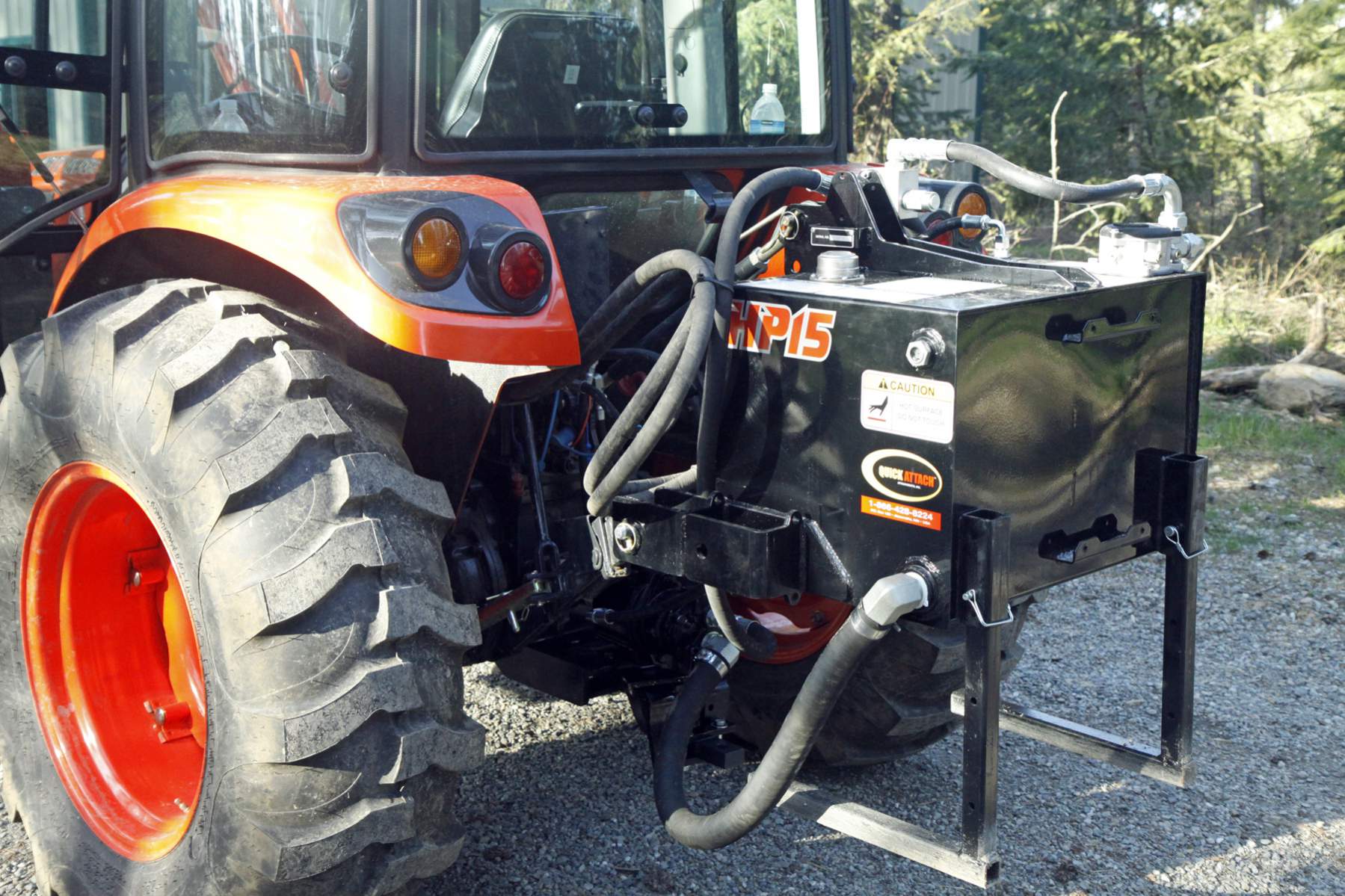

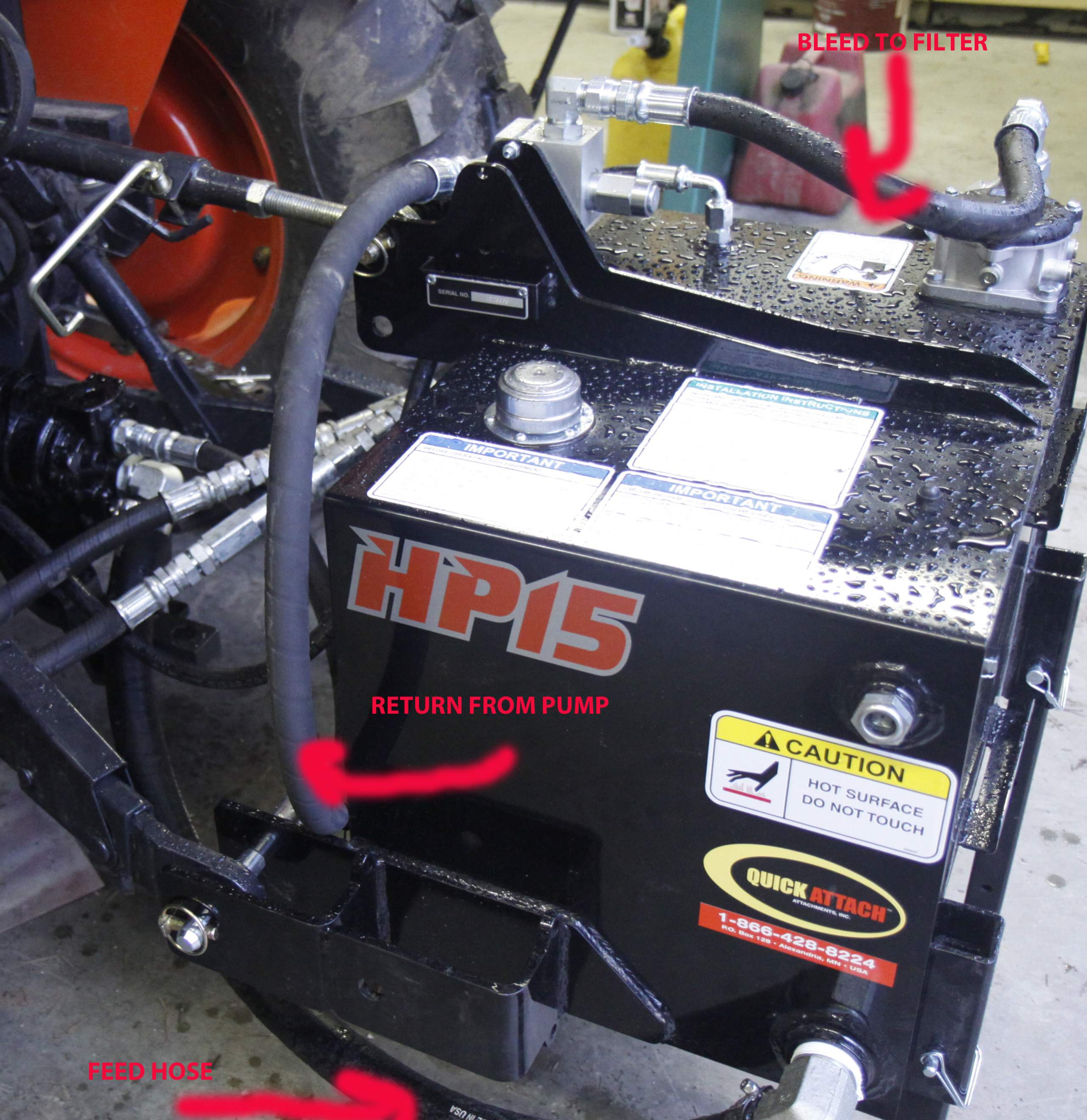

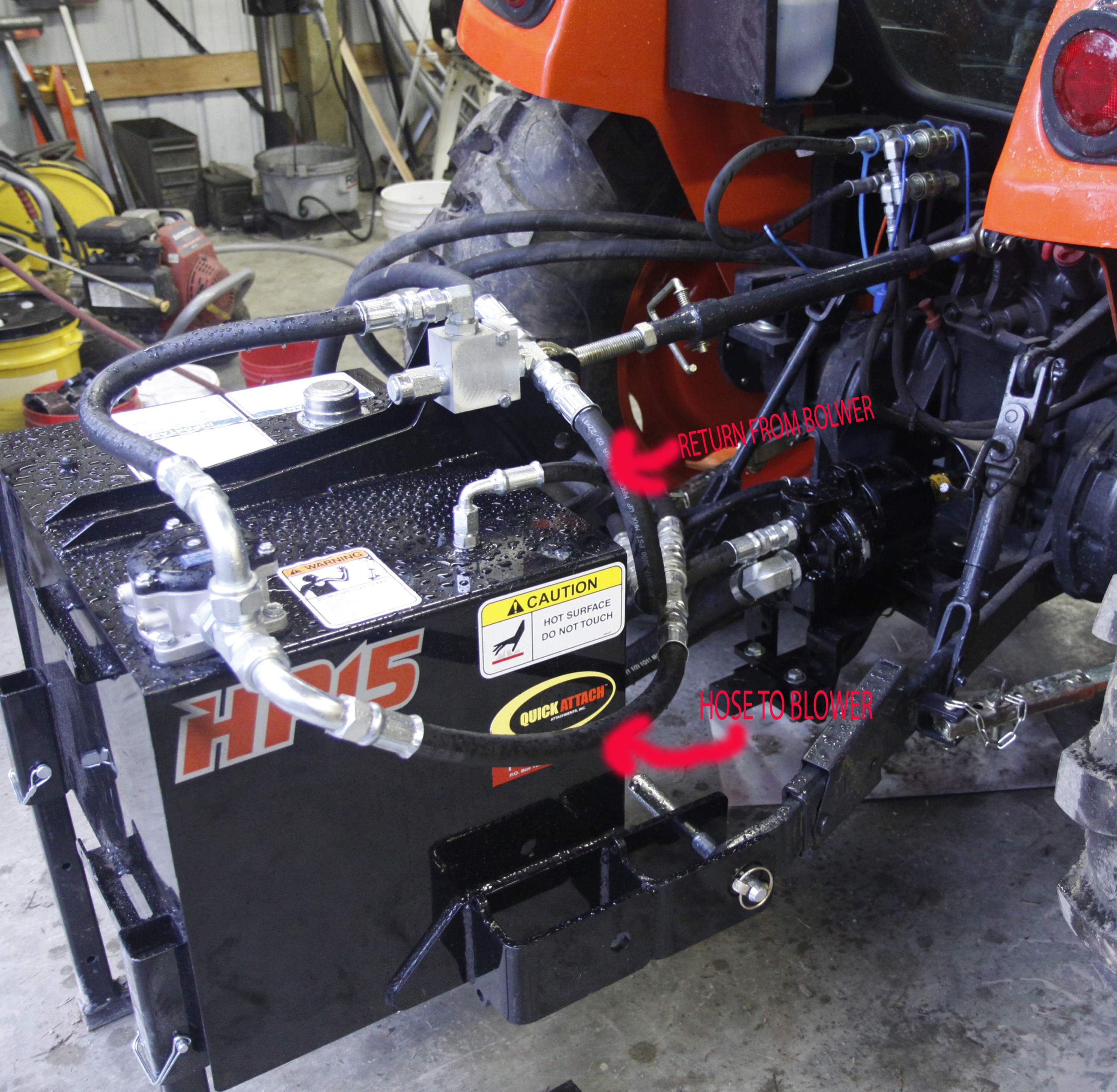

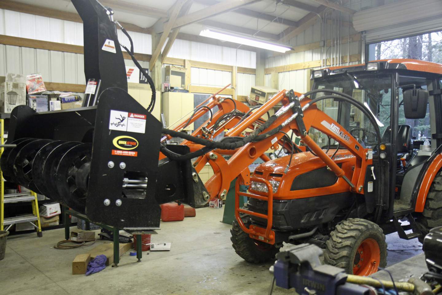

sure do. very spendy though. Mine cost about $11,000 complete. mind you a heavy built USA made rear blower runs 5-6K.
Skid Steer Attachments | Mini Skid Steer Attachments | Tractor Attachments | Bobcat Attachments | Quick Attach sells them, as do a few others. You can get a truck mounted front end blower that has its own engine and have it made to fit tractor loader also.
LEFT TANK SIDE.jpgRIGHT SIDE TANK.jpgfinal rear powerpack 1.jpgsnowblower installed.jpg
View attachment 372366View attachment 372367View attachment 372368View attachment 372369
wow, i cant even imagine spending 11k to put a snowblower on something, much less a compact tractor. more power to you; but thats insane!
