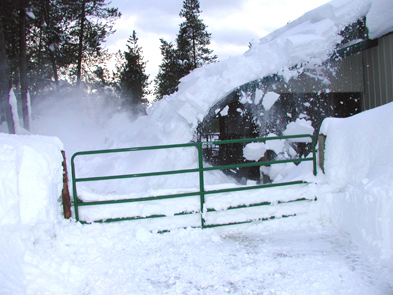

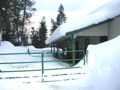

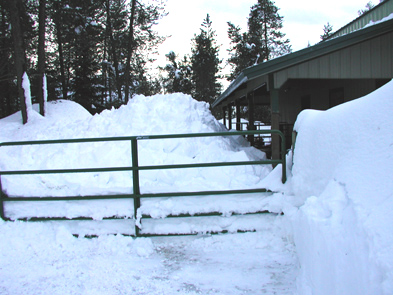

well that might work, but when my bulidings shed i can have 5+ foot banks.....ive had them as high as the eaves. I used to have to drive in with bucket and backdrag, TURN AROUND and blow. TURN AROUND repeat...repeat..repeat.
nowdays i raise it up to top of pile and drive back and forth while lowering blower.
What used to take half the day can be done in less than 30 minutes.
