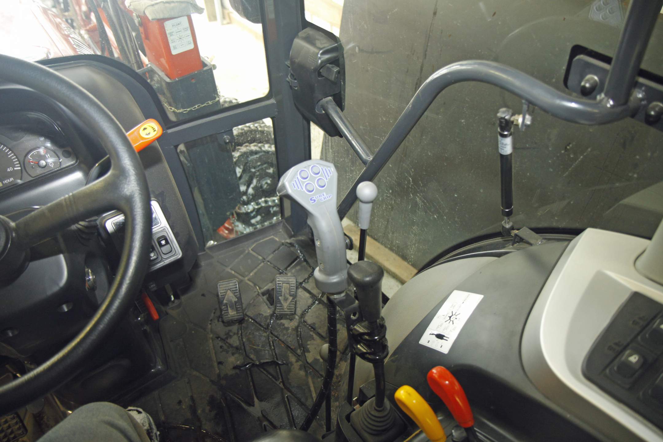

How does that setup work? I know the PTO drives a pump but how do you turn th blower off, disengage PTO?
   / Do they make this type of snowblower? #13
the pto controls everything. it also has 4 built in electric over hudraulic valves that control chute rotation and chute up and down for distance of throw. Since its hydraulic theres NO shear pins.....none.
I just love not having to mess with those things. I can blow snow for 3-4 hours in a heated cab wearing t shirt and bunny slippers (well....i could but dont wear the slippers).
i never have to touch the snow.
the control of the chute is done thru a hand grip unit<img src="http://www.tractorbynet.com/forums/attachment.php?attachmentid=372528"/>
So to disengage the blower you disengage the PTO?

yes. which is a toggle switch for me
