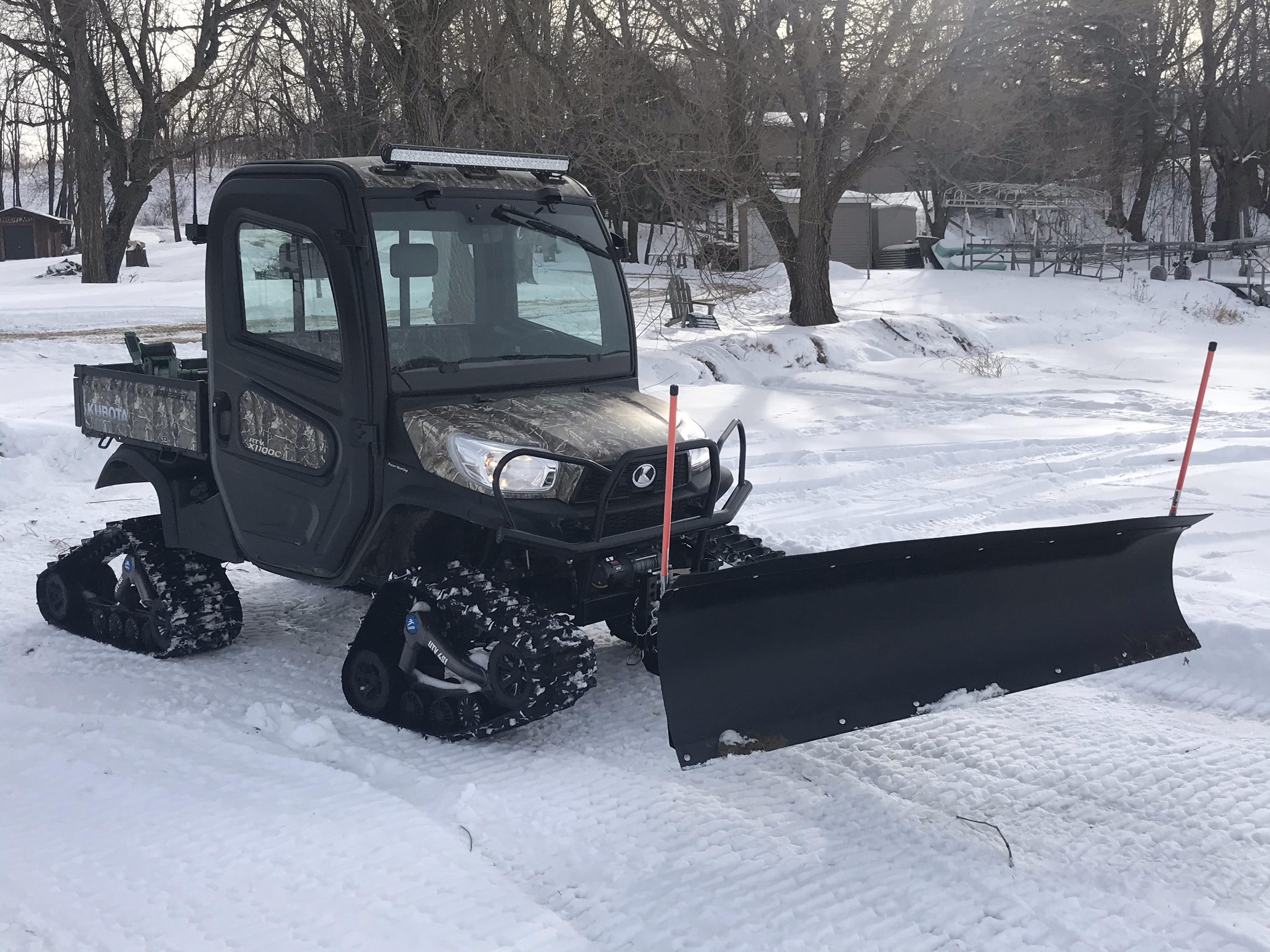

I'm three years into my RTV1100 for plowing. It's certainly a skill to push snow, hats off to those who do it well. I've had good luck with mine, I'll upgrade the plow when I move further north into retirement. For now it works great, for $600 with extended push bars to make sure the tracks are clear and connects to the front hitch receiver. (I bought a scratch/dent return, I think they're $750 or so.) It's a Denali 66" Pro model. An electric hydraulic system is available for directing the blade, but I passed on that. Hasn't been an issue, but I'm sure it would be hard to live without once you have it. Slow and steady I can push a lot of snow. With the tracks I go up and over the existing mound of snow and simply keep extending it further out past the driveway into the yard, and not upwards. I've had no issues doing so. Plus having heat and the radio, I don't mind going a bit slower.

That's a nice rig. Slow and easy is much less likely to damage things anyway. Unfortunately that business of making a living usually puts some time pressure on the seat time. But, I'd love to try a rig like yours out some time. You and ArlyA have me wanting to try some tracks now to see hat I might be missing. I wonder if they would fix Indusrtial Toys trouble with his Mule?

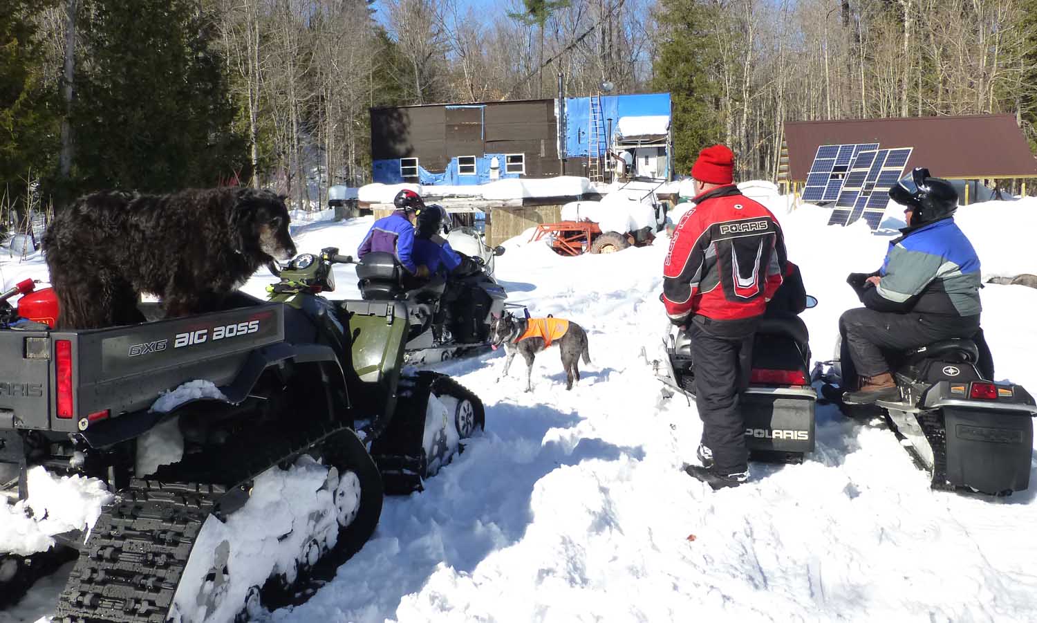

Milk, tracks* or pods, which is there real name are spendy but I'd not push squat of snow without them. Not sure I'd even have a blade without them but most of my snow pushing is on the yards grass or packed snow. Nonetheless, the 6ft blade has been good addition for us. We do not run the pods after snow is gone.
We did do two days of joy riding with the machine in snow this past winter. Below the links are to the events.
Here is one. Here is another we did at a old cat rondo old cats
*tracks are the rubber part with lugs. Pods are the entire unit you add to give you extra flotation.
In this photo, we are parked on 4ft of base.

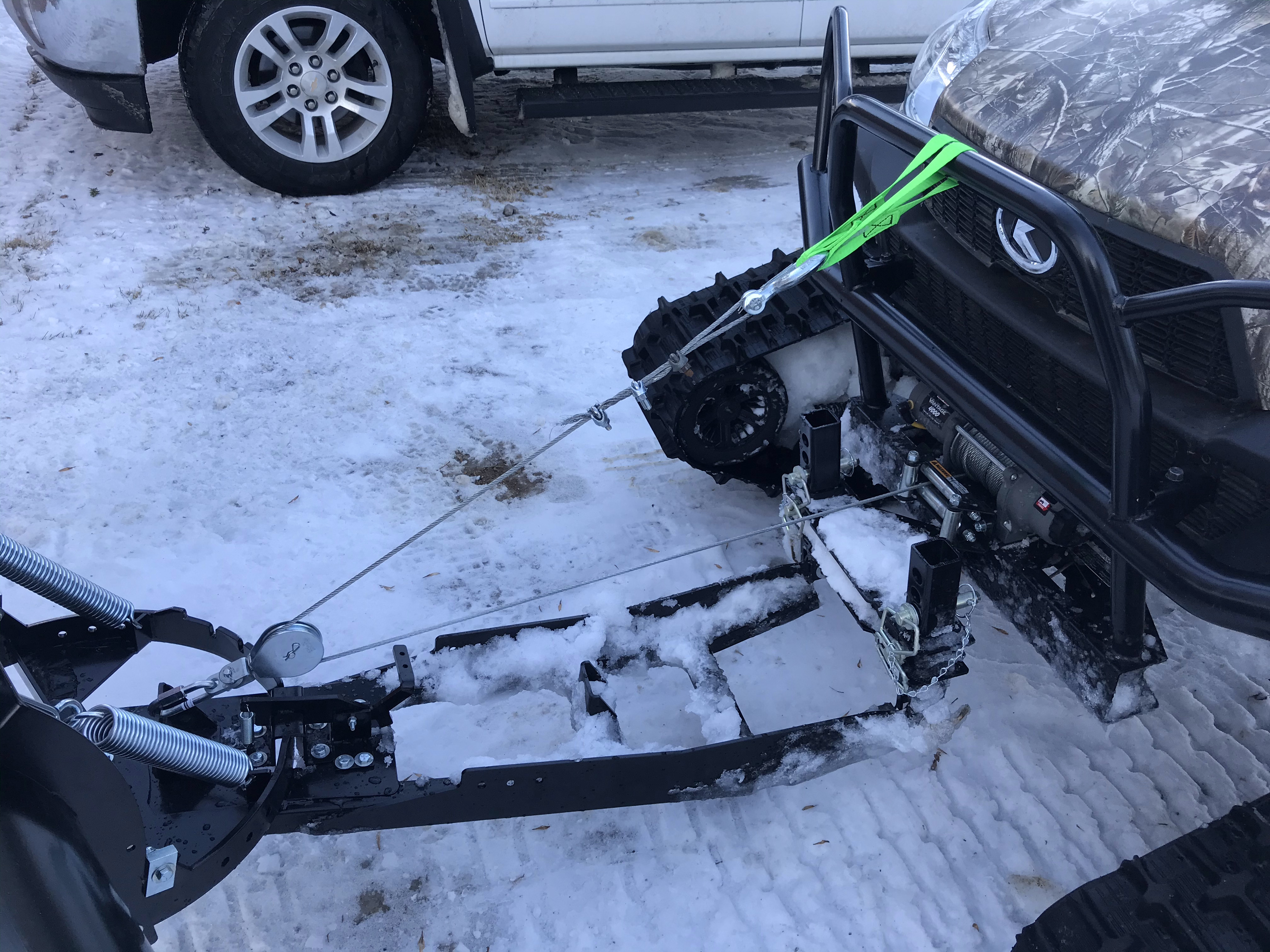

On thing I'll add, since the photo was taken and breaking the winch cable plowing, I added a block & tackle. It's a big difference for winch style plowing, I think. More control, by slowing the lift and drop by half speed and a true lift rather than pulling back to raise the blade. Easier overall on the winch too. I switched to a synthetic cable as well.

If I were you, I'd get the plow mount further back on the UTV to shorten the entire package. Then, the lift point for the plow would be closer and more direct to the lift point.
