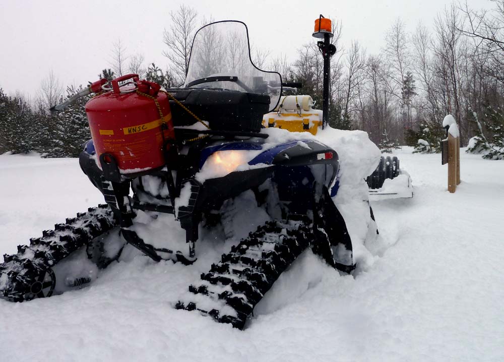

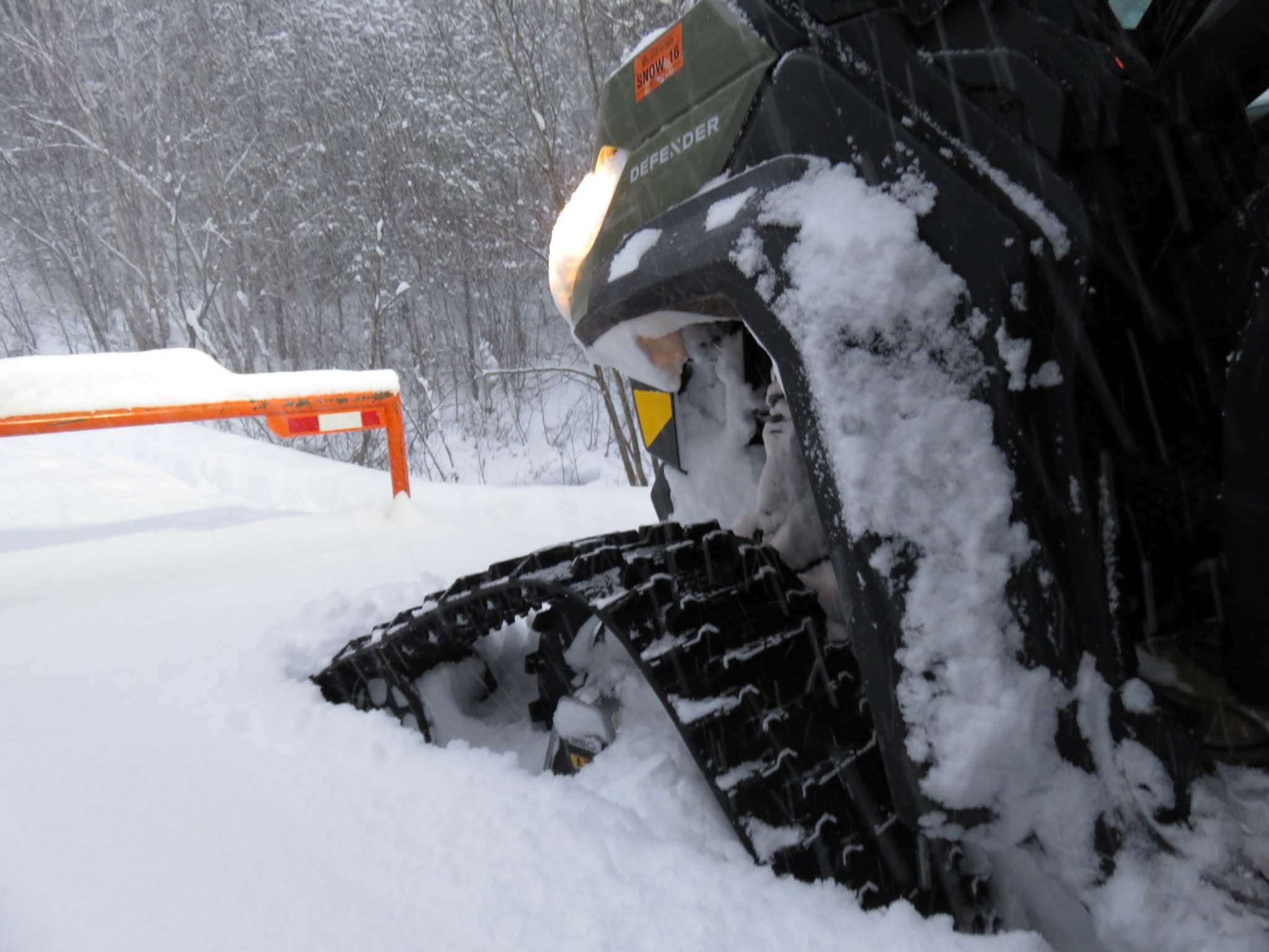

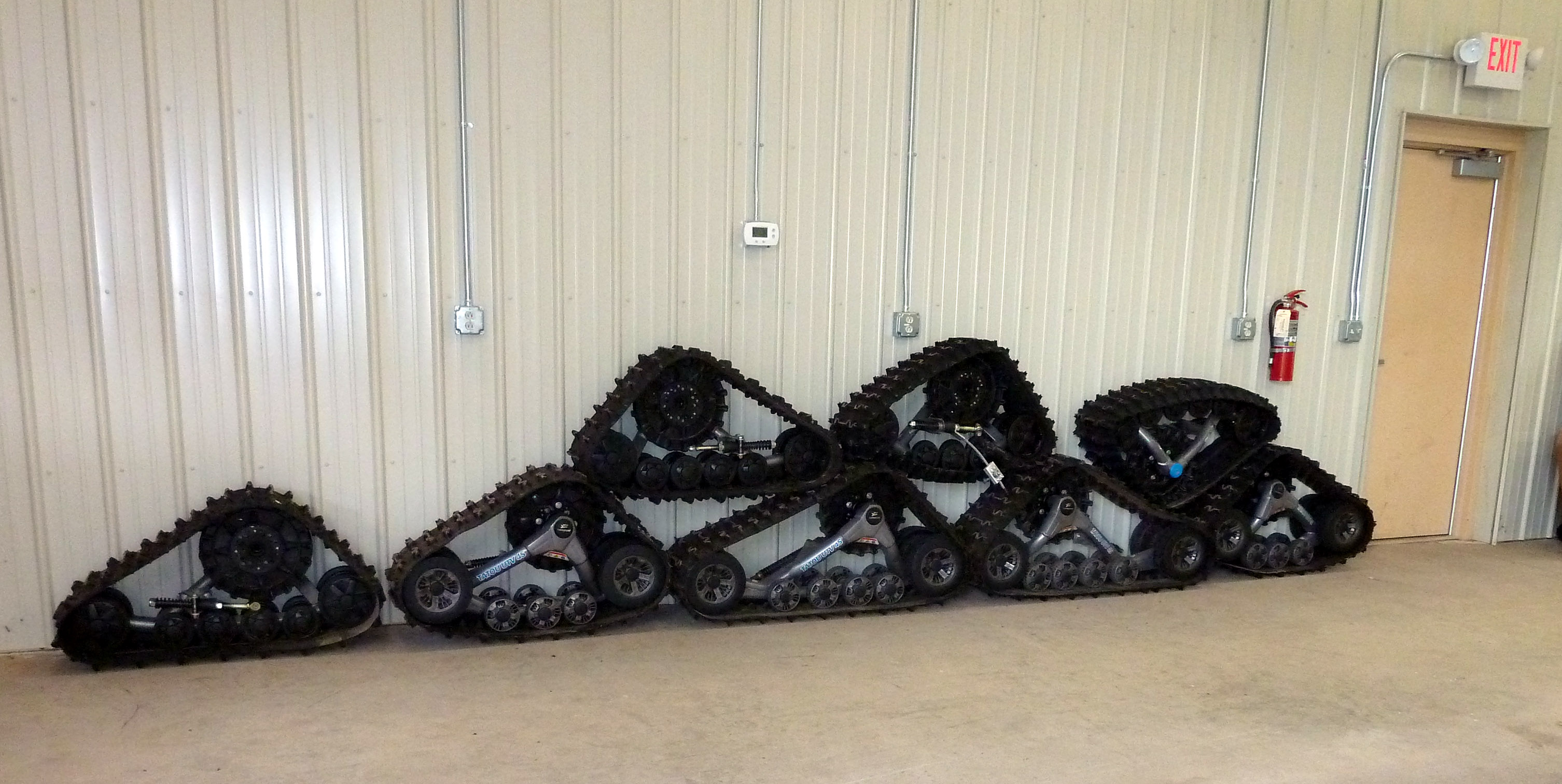

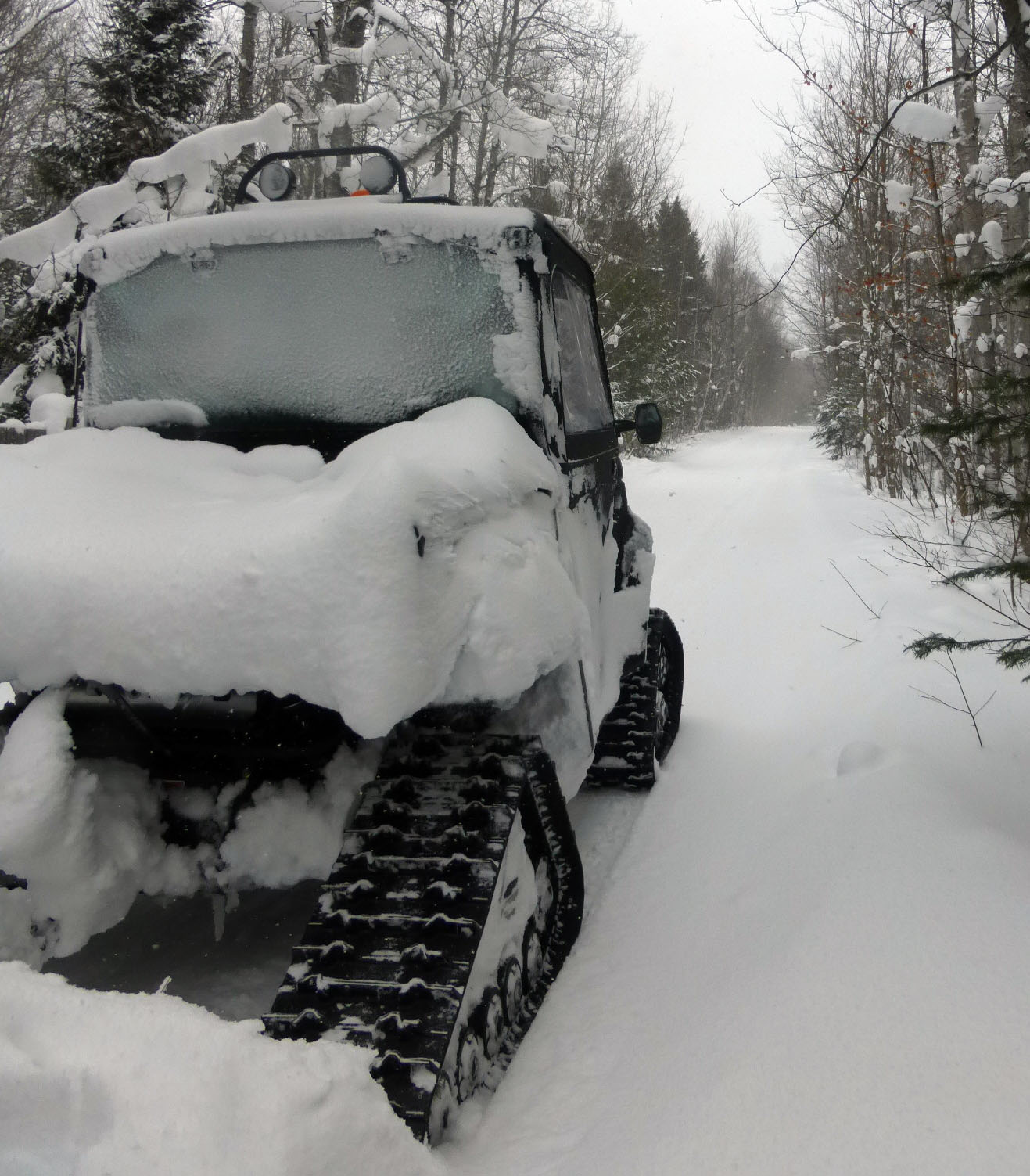

Let me address a few pod/snowplow misconceptions which i have some experience with since I've got thousands of hours in running UTV's and ATV's with pods at my former job. We pretty much wore these machines out in 5 to 7 years of snow use.
Yes pods cost $$$ and I can't recommend there use on anything but snow. No matter what the manufacturers might claim.
Changing from summer to winter is not that bad of a job.
Plows used with pods must have a longer push frame in order to clear the blade. You have to use one of those! I had to build my own because i couldn't locate one for my dated 6x6..
Most pods have gear drive that will reduce you to 70% of the original rotation. In simple math, if your machine originally went 10 MPH, with pods it you'll do 7. Pods take lots of power to push through deep snow. I'd have our 1000cc 80HP -+ engine right to the floor at times but pushing snow with a blade takes fewer ponies.
Lastly, they rock at floating over, or pushing snow and we'd not give up using ours. I love it for pushing that snow.
