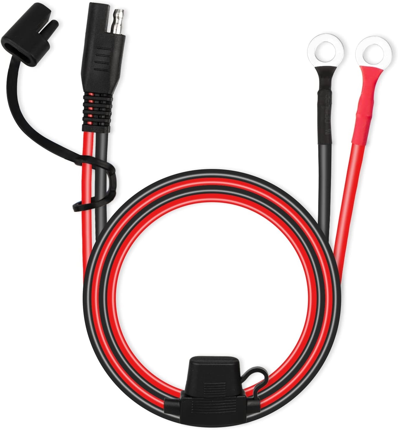

I really should install some sort of extension cable to my tractor...the battery terminals aren't very easy to get at, and the loader arms get in the way to connect to the starter.
That's what I did. All of my rigs have ring terminal to SAE connectors installed on them because the battery maintainers have SAE ends. The ring terminals go to the battery terminals and the SAE end is attached somewhere out of the way but still easy to get to. So no lifting the hood or messing with battery clamps. Here's an example:
