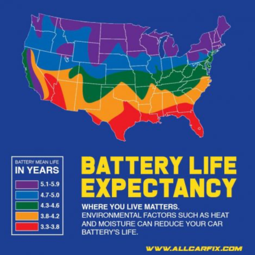

Heat is bad for vehicle batteries.
Cold environments are actually good for longevity. It’s only detrimental if you leave the battery highly discharged in sub freezing temperatures.
If you keep your battery in a decent charged state, there’s nothing wrong with leaving it out in the cold.
Cold is also up for interpretation, I would say cool temperatures is ideal but if left in the cold some fail safe should be done like disconnecting the battery and periodically charging it, to ensure it is kept full charge and doesn't freeze. Like you said it is good for a battery to be left in the freezing temperture but it need to be fully charged and making sure it doesn't loose its charge, since the freezing point of a fully charged batterie is -60C, a partially discharge battery could be as low as -23C...-23 is a typical winter day for use.
