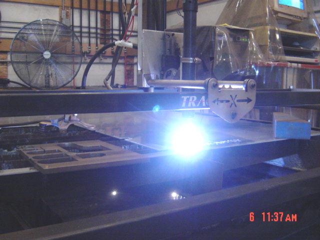

About the only time I ever used my rotary table, I made a new torch mounting bracket for my machine plasma torch. I needed a radius slot, (you can barely see it in this picture). Wow I never dreamed machinist have to have such eye to hand coordination! :confused2:

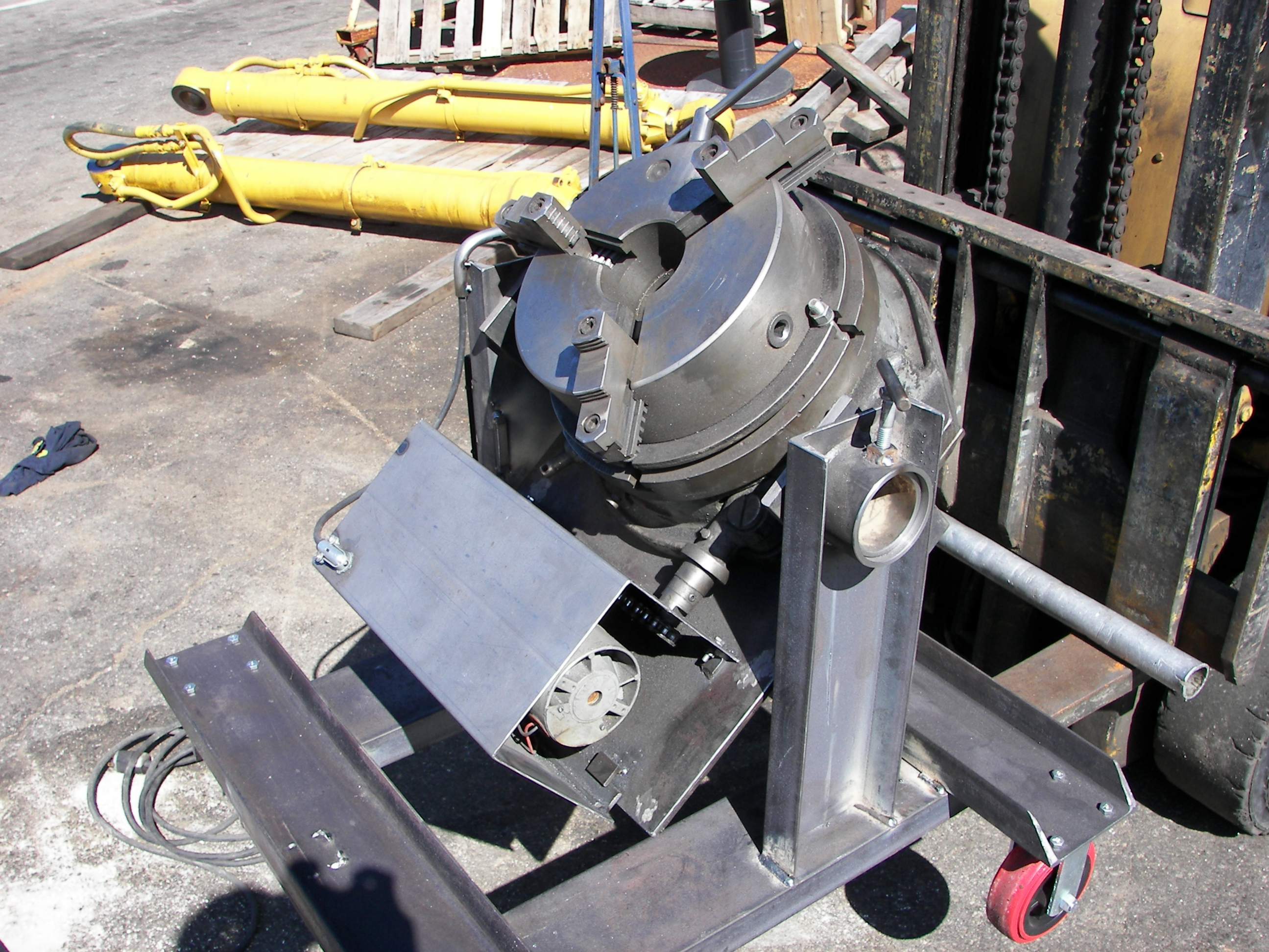

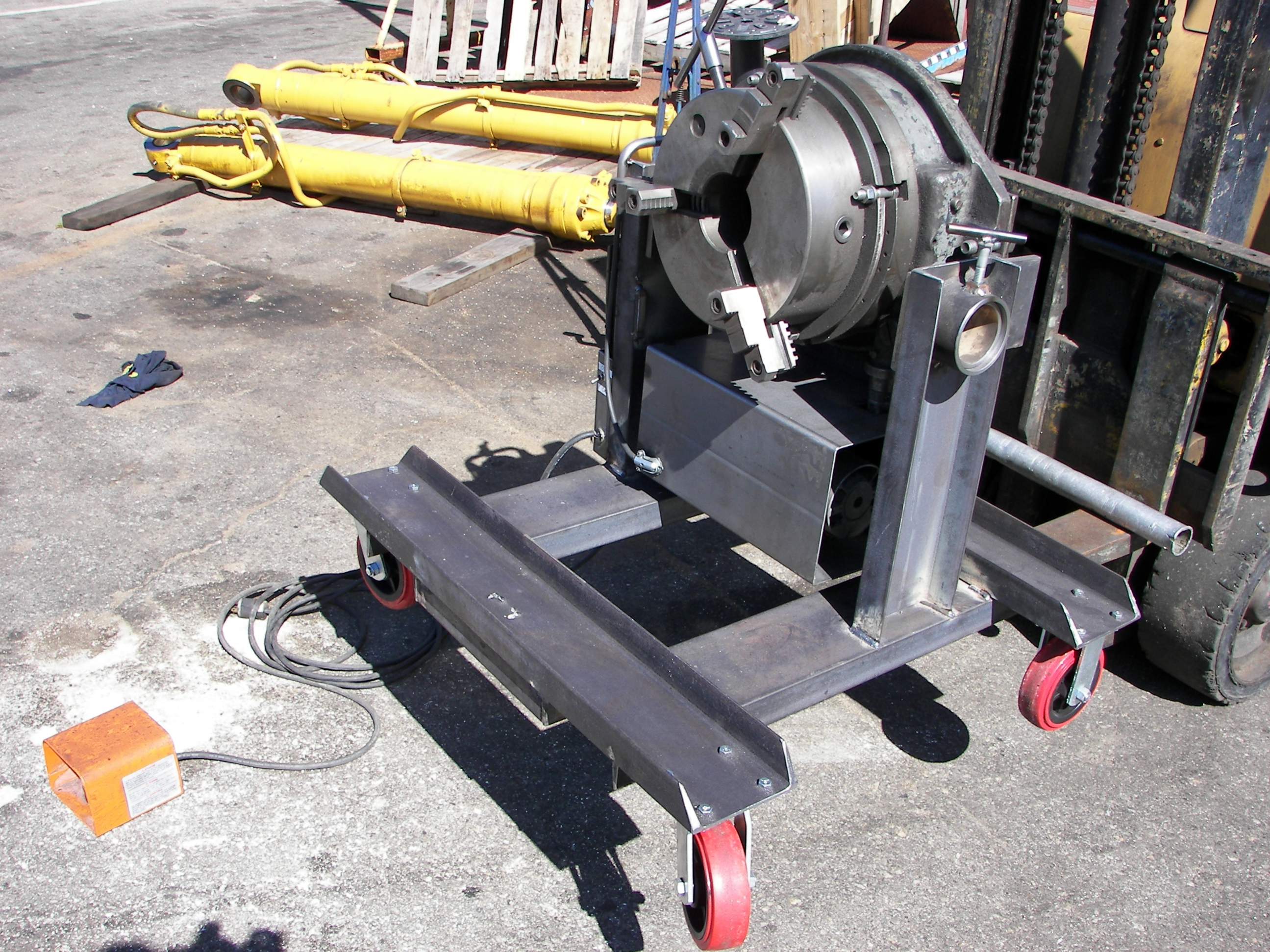

Here's one of my rotab's put to a different task....can you see it?
Just add 90vdc vari-motor w/speed reducer, frame and spare old 12" lathe chuck
welding positioner?
