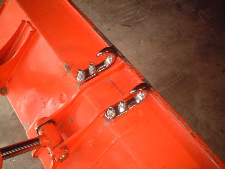

I copied what Phred posted. Ordered hooks from Harbor Freight - - drilled holes, no welding.

Junkman,
My installation looks like yours with the exception that the 2 outer hooks are angled in at a 45 deg. angle. 3x3 angle, and 3 weld on grab hooks. The dealer did my install before delivery and they removed the level indicator because they said it was useless any way. I don't know if it works or not because I never had it.
I do like the grab hooks much better than the regular round towing hooks.
A good friend of mine has a 4310 with hooks welded directly to the bucket. His bucket is all bent up and looks terrible. To the point that he is thinking of replacing it. I have pulled some huge trees out of the woods my BX and my bucket is still straight as can be. Although It is loosing paint rapidly.

Dan and others..... If you are going to be welding hooks on your tractor loader bucket, try to use the flat bottom hooks and hold them approximately 3 1/2" from the ends of the bucket. I don't want to go into detail quite yet, but I will say that I have to remove mine and relocate them for the project that I am working on. Hopefully within a month I can let everyone in on the secret. Thanks for all the responses and pictures. This will go a long way to helping us in design parameters.
