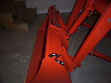

Here ya go! Sorry to take so long but I didn't have a picture and couldn't find my camera. The dealer welded these on at my request.

Two hooks. They are on the top of the bucket in line with the bucket supports/arms. Welded the hook to a 2 inch square tube first, then the tube to the bucket. Posted a picture on TBN once, will try to find it again for a link.
