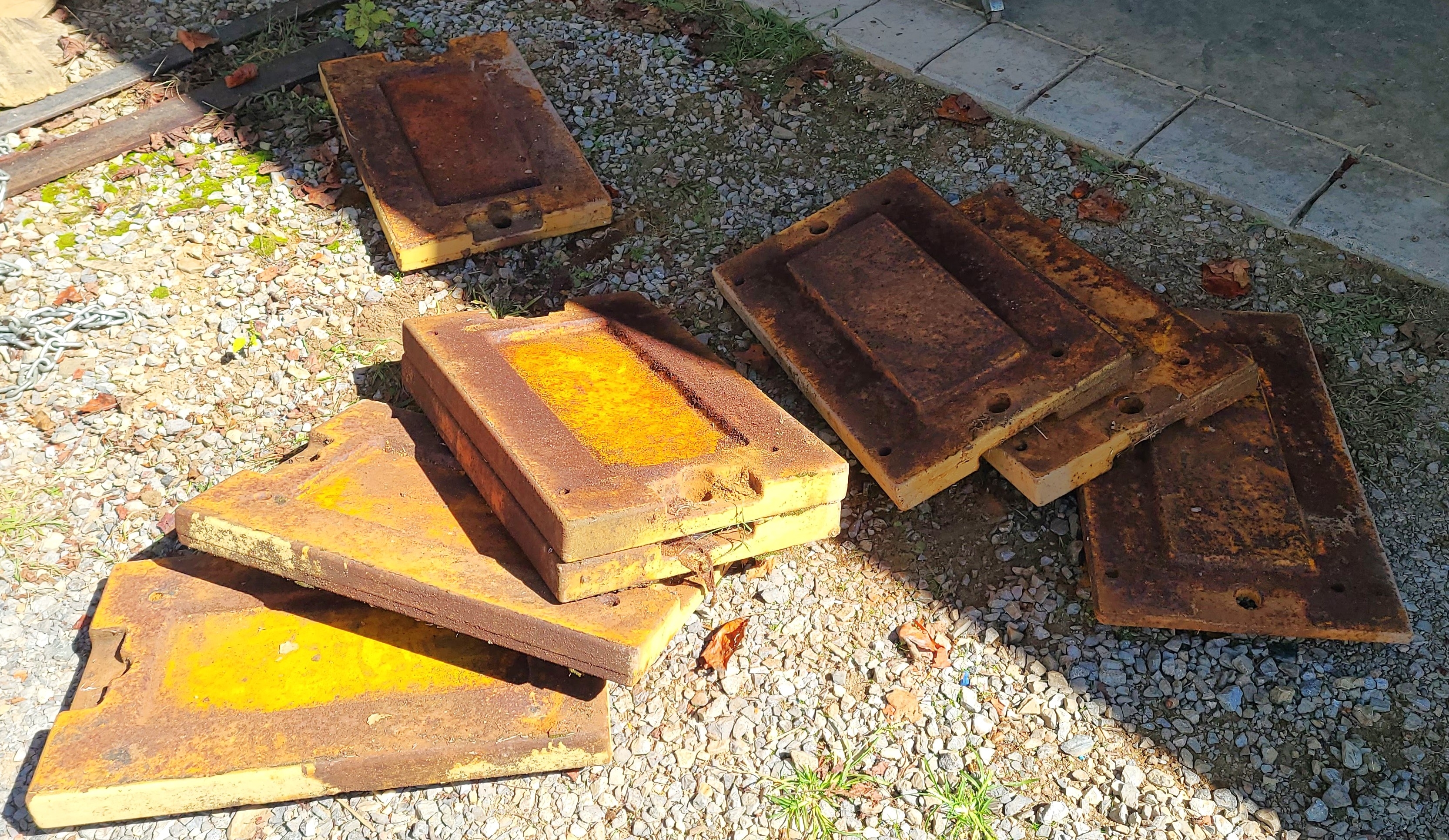

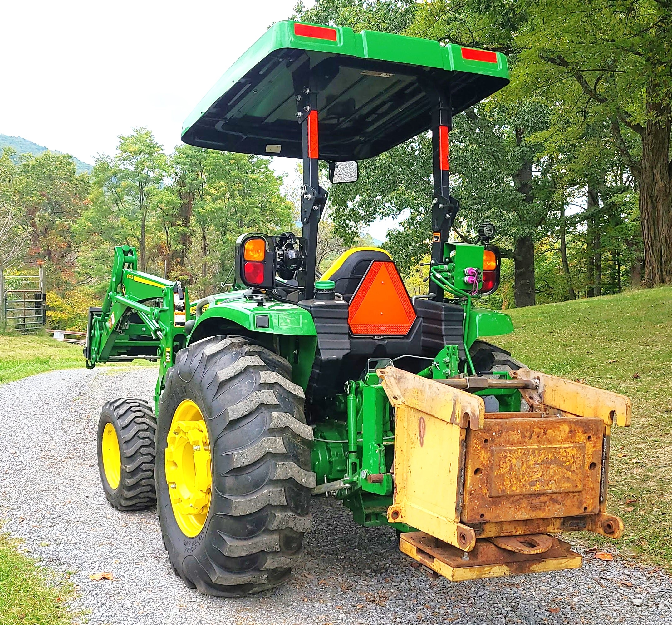

My newest tractor did not have the weight of my old 584 IH,,
SO,,,
It got 6 large wheel weights,, rear tire fluid,, and a DIY weight box
The weight box was built out of some of the weights from a John Deere track loader counterweight
I only used 1,000 pounds of the weights,,
The tractor stays rear anchored,, and the box is a great place to carry a chain,,

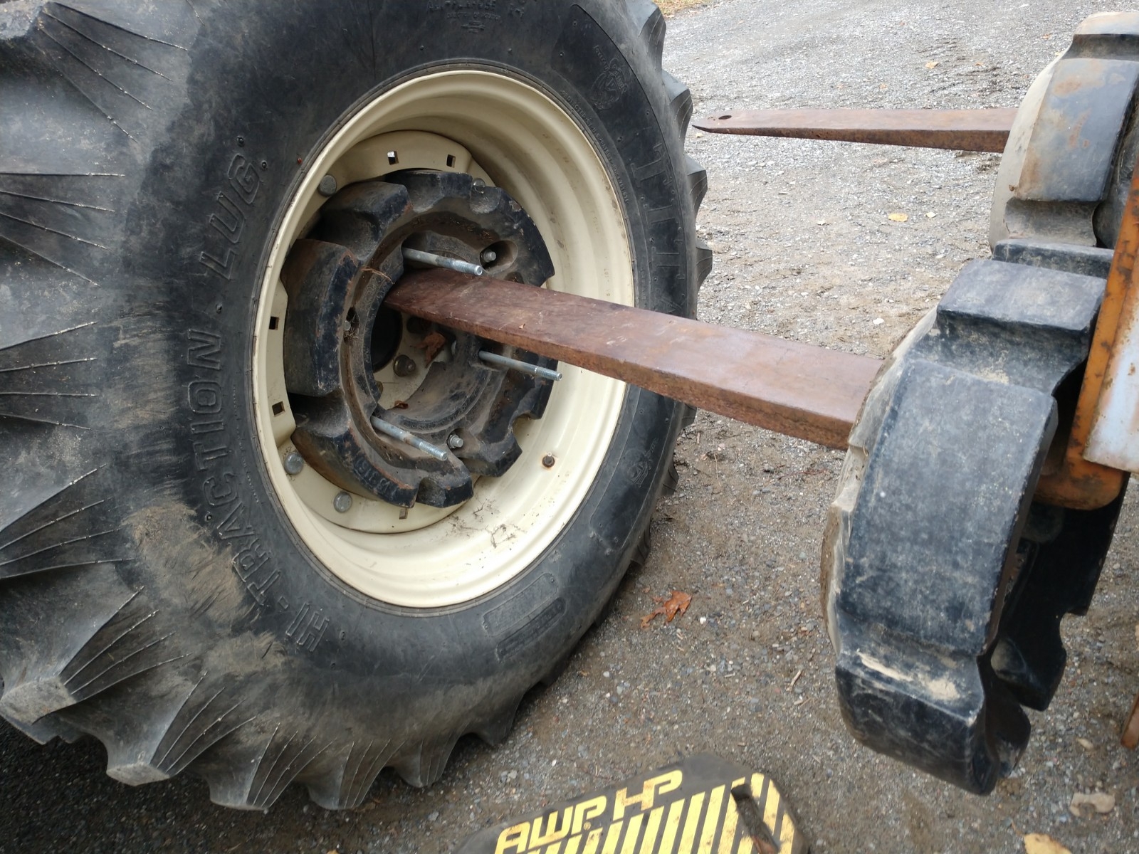

I do NOT like filled tires, over the years it has almost always cost more then iron weights. That said my little Kioti 2620 with the R14 tires does have rimguard in the tires.
I much prefer iron as I have on the Branson 8050, 600 pounds on each rear tire,
I have considered getting a couple more but it gets by well with what it has.

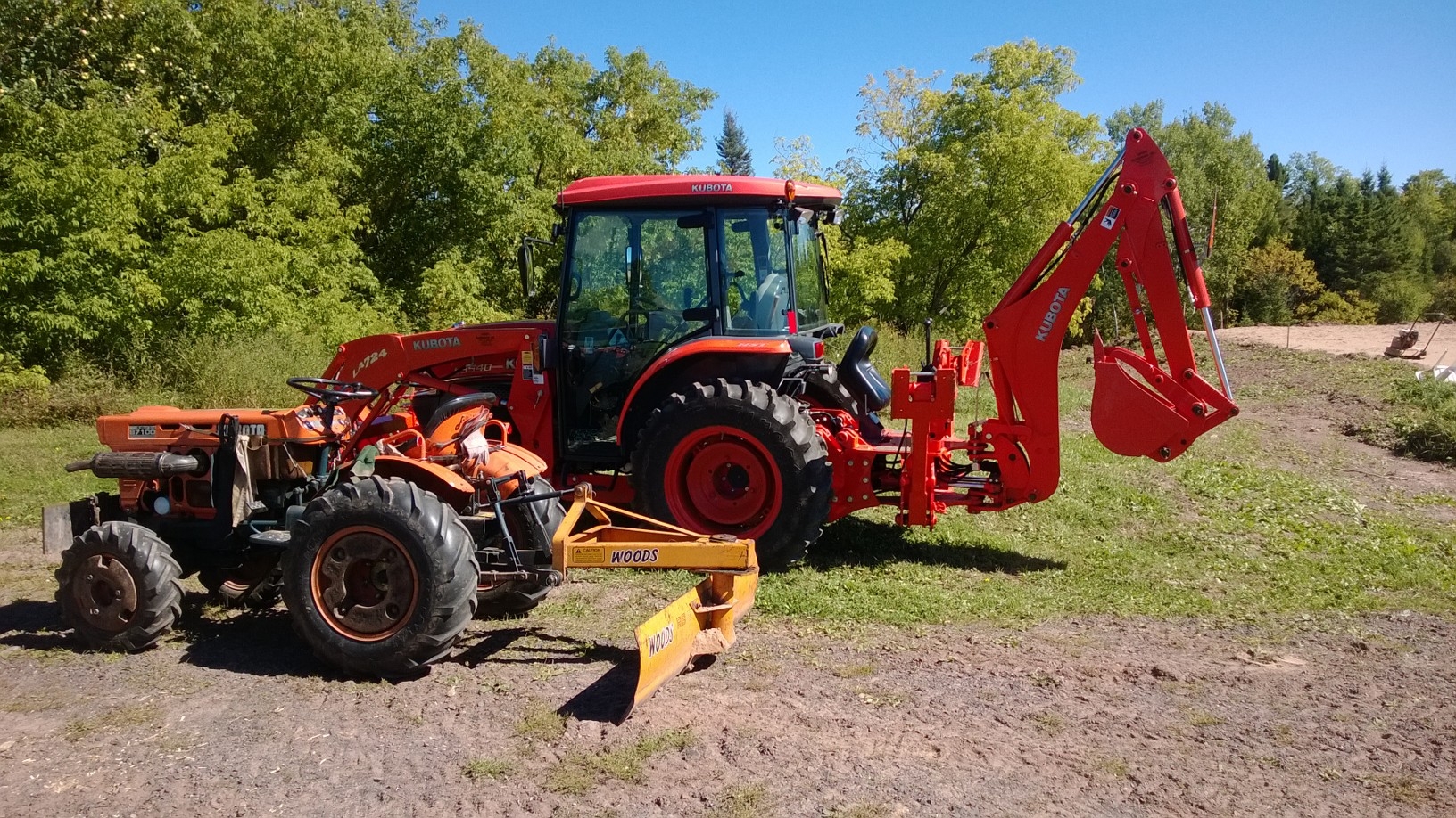

B7100DT has 40 lb in the front and 75 lb in the back. L3540HST-C has 3 55 lb each side in the back, plus loaded.
That gives me about 970 lbs and also the BH which stays on all summer.

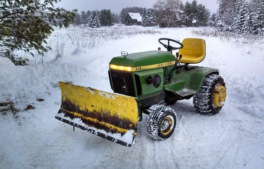

Nope..... Just 500+ lbs on 3PH... Wheel weight or filled rear tires are just not enough....
20190513_134020-jpg.607788
20190513_134501-jpg.607789
JD weighs in at 520 lbs. according to manual...
I could pick them both up with my M9000 at the same time I might add. I won't buy a tractor (Kubota) without cast centers. I don't fill tires, no need with cast centers.
