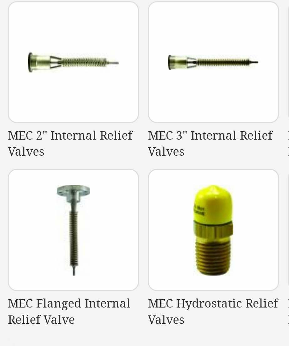

Hi Justman777, yes, similar but not exactly - it only happens with the Woods BB720 Bush Hog attached, not the ballast nor the Igland logging winch. Maybe the Woods BB720 weighs more than my ballast? Only felt that 'jump' with the Woods bush hog. PTO on, or off, attachment high, low, moving fast or slow didn't matter... you feel it right under your butt, like a skip. If you remove the seat there is an access cover to the 3 PT Hydraulic System Group - under that access panel there is a valve about the size of a fist. My dealer is calling it the MEC Valve. He showed me where it failed, there is a knurled screw/bolt on the top of it, it's supposed to screw in and out for an adjustment, the threads on that were stripped and the knurled adjustment screw/bolt would travel straight in and out (not twist on the threads as it should). After replacing that MEC Valve twice, now the arms don't go up or down with old (original valve) or the 2 new ones they received.

I believe the dealer is referring to the MLS. That's the only valve that's under the seat that I'm aware of. Should be similar to (but not exactly like) what's in this video. Kioti CK2S Tractor MLS Valve Adjustment on 3 PT Hitch - YouTube
Note the MLS controls the flow of hydraulic fluid to the three point. With the valve fully closed, I believe it locks the three point into position. I would hope a dealer tech is familiar with how the MLS operates, but you never know...

Yes, that's it, for some reason he keeps calling it the MEC Valve. And yes, they have tried overriding that valve to make 3 pt go up or down, and they cannot override it either. I can't comment on what they know or don't about this valve, other than they've replaced it twice and now can't get arms to go up or down at all.
   / Do you know Brian Faulkner at Kioti - or his manager(s) ? #48
Possibly installed upside down? I'm not sure this is possible, but the workshop manual warns against installing it upside down....which indicates it may be possible.
   / Do you know Brian Faulkner at Kioti - or his manager(s) ? #49
The MEC is a small hydraulic relief valve. Its part of the MLS.
Not all tractor manufacturers use them, and those that do use them, may not use MEC valves in all their tractor models. If one of these failed, it should be quite simple to replace....unless it was stripped by over tightening.
