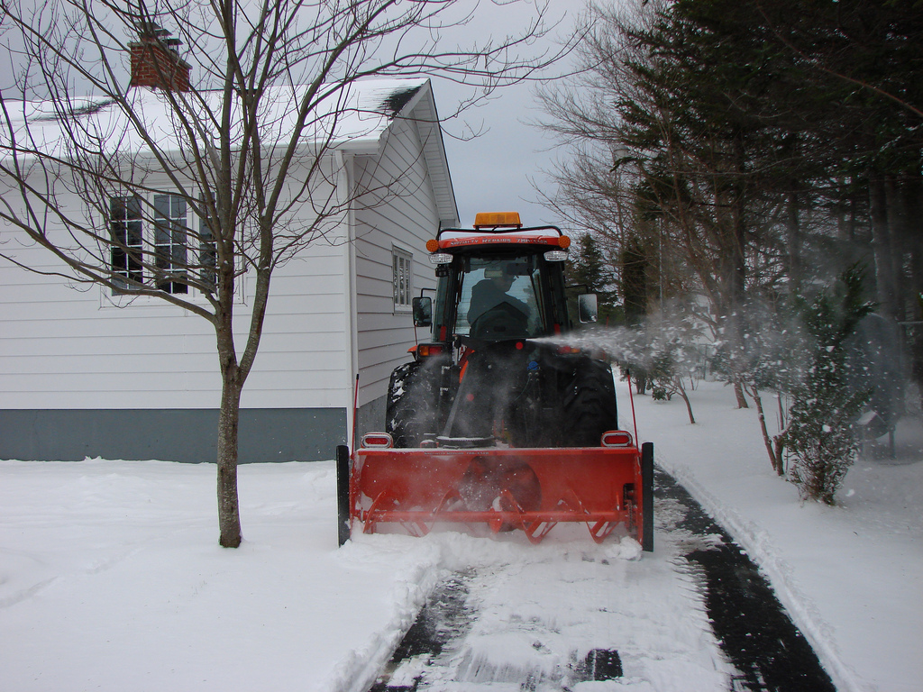

Im in New Hampshire and switched from open station to cabbed primarily to get out of the cold during snow blowing. Put me in the group that wished they had just bought the cab in the first place. It is hard for me to overstate how much more enjoyable chores are in the cold/hot/wet/bugs of New England when there is protection. I dont have a sense of being disconnected except when the wind shifts while Im snow blowing and it melts on the glass instead of on my face and clothes.

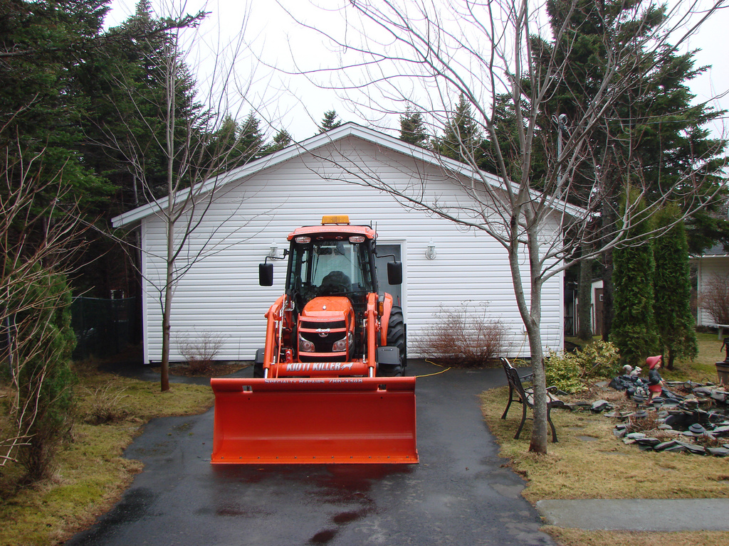

My R4s will be at the wide setting, but no spacers as that would take away the ability to muck the sheepshed in the hands free style I am eagerly anticipating. No backhoe, as I have a mini-ex. The cab height is about two inches less than my garage opening, but I never shut that door anyway so might just remove it and the trim as suggested. I have a low breezeway that precluded cabs on the Grande L tractors I've owned, but the B3030HSDC will fit with five inches to spare.
