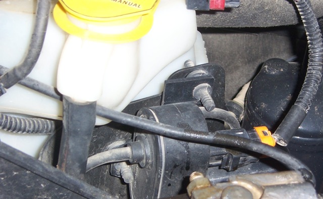

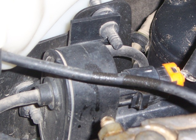

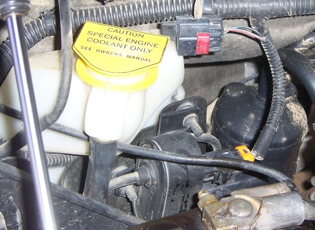

Here'some pic's of it ... its right in front of the plastic tank and has the yellow/orange plug. When you turn on the key you can here that baby running and when the engine is running you can feel it running. I guess it just keeps running ...
Could it be a vacuum pump? Check to see where the pipe is going. My '96 12 valve Cummins has a vacuum pump that is run by the engine, but you only really need enough vacuum for the power brakes, and AC actuators, so I'd think a little electric vacuum pump and an accumulator would be all you need. Diesels don't do intake vacuum like gasoline engines, so an aux vacuum pump of some kind is required for the brakes and AC.

jinman ... it is a vacum pump however they could not advise if it should be that loud and keep running. One guy at the auto parts store stated he would think there was a leak or the relay in it may be bad cause he didn't think it should continue to run ... advised me to talk to Dodge.

Here's some pic's of it ... its right in front of the plastic tank and has the yellow/orange plug. When you turn on the key you can here that baby running and when the engine is running you can feel it running. I guess it just keeps running ...
That unit is the vacuum pump that I believe is only used for the cruise control since they use the same vacuum operated cruise that the gas engines have. If it's constantly running then there is most likely a hole in one of the vacuum lines going to the cruise control servo. It's very difficult to see any holes without a good vacuum hand pump or smoke machine so either take them off and check them closely or just replace them. Their cheap and easy to get to. :thumbsup:

Yes thats the way I read it. I messed with the lines on that pump. About 3 ft down there is a "T" its rubber and the hard line slips in, I didn't pull the line just pinched the soft "T" with a needle nose and the pump stops ... I assume I have a leak in the vacum line.
I am going to pull the lines at the "T" and see which direction I have to go to find the leak ... hope its not the one that goes thru the fire wall !!
It makes me wonder, cause everything is working on the truck, you would think if it was leaking something like maybe the cruise would not be working

As long as that pump is running the cruise will work fine, BUT you are over-running that little pump and it will die much sooner than normal due to that leak if not fixed.

Well I can not find a leak, when I pull the lines apart at the first T and plug it the pump stops, add the line to the dash or the line to the valve and it keeps running ... pulled the dash apart and nothing, pulled the other and nothing. Still waiting to stop beside another 04 to see if there's runs all the time.

By the sounds of it, you know the leak is after the T in the lines so as much as a pain as it may sound I would just replace the lines after the T. It's easier said then done but if you drive yourself crazy looking for a pinhole leak in one of the lines, you could have replaced both lines and saved the hassle.
