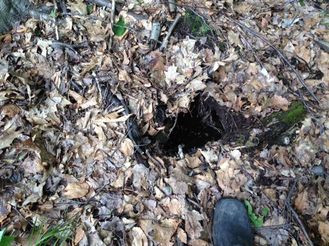

It looks like your foot is close to where you "went in", in the one photo. That is probably too close to be safe. Be careful, please!

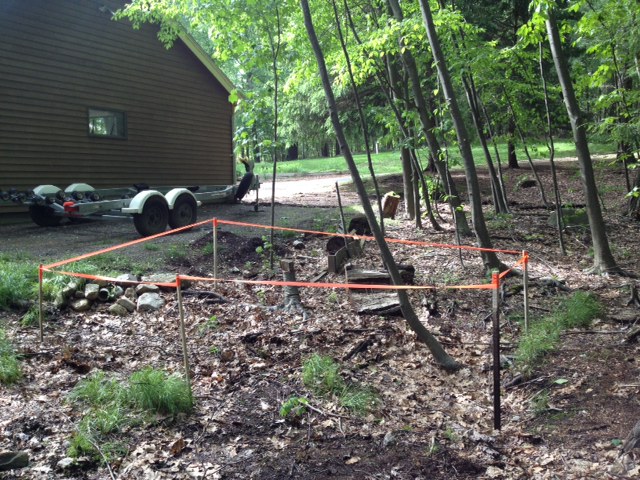

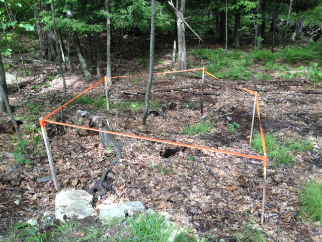

I did some poking around in the area today, though didn't get a chance to excavate (I had to move a big pile of dirt first). The water in the hole was crystal clear (so maybe a spring?), feeling the bottom with a stick there's rocks in the bottom, some areas are gravel and some are much deeper and mud on the bottom. It extends about 4' in one direction and there are some areas around that are 5' deep mud (can push a stick in 5 foot with minor effort). I think it's been developing for a while now that I look at it. Last fall I cut a tree (you can see the stump in the pictures) because the roots had just pulled out and it was lifting out of the ground with the wind, other trees around had started to die and I lost a couple of others. The whole area is slightly sunken vs the other ground and there's a thick mat of tree roots, which is what's holding the surface up, where I fell through I stepped between the roots. I've roped the area off with flagging tape and will wait for it to dry before digging in further. The stone wall near it is my property line, so I probably will be unable to drain it - but maybe I can fill it with rocks and get a stable surface, my hope was to use the area to park a trailer.
The area of the sinkhole. The hole in the center is where my foot went through.
Another view showing where the area is. Note there's a compacted Pad for parking right next to it. The drain pipe is for my downspouts though due to a gutter problem (tree hit it), almost nothing drains out of it, it runs out the other end.
where my foot went through, looks innocent enough!

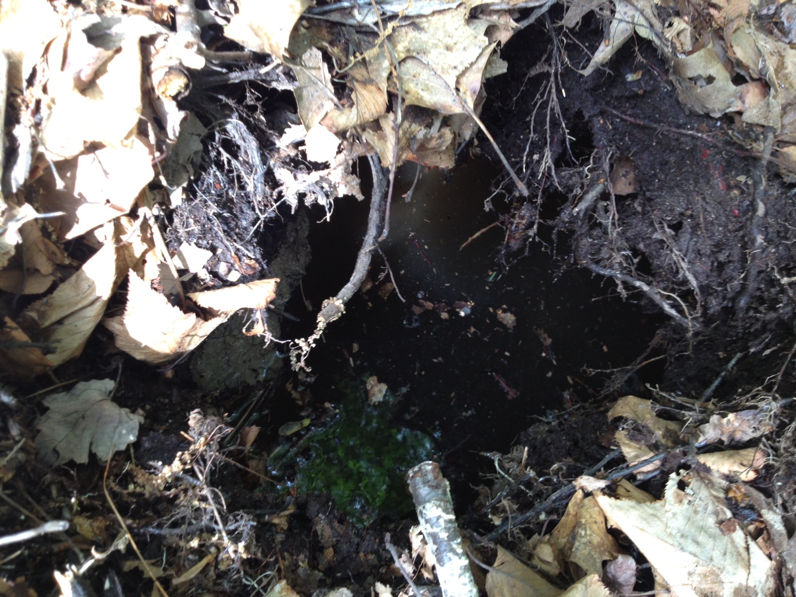

Inside the hole. The water is pretty clear and the level is about 6" under the level of the ground, the top level is being supported mostly by tree roots.
Not to alarm you, but I would be very concerned after seeing the pictures. The next sinkhole could destabilize the building, depending on the flow direction of that underground stream.
I would consider calling in an expert of some sort right away.

In my area we have 13' to 25' dug wells lined with stones all the way dating back to the 1800's. They are usually filled in, some are not. Debris could have capped it off, limbs etc and you punched through walking. A lot of western Mass is limestone, but growing up in the Berkshires, I never heard of anything like caverns. Who knows. I think it is an old well. Maybe the house or barn fell in on it 150 years ago and rotted away leaving vegetation. I always look for stones in a pattern, or apple trees nearbye and a bit of mounding.
-Just looked at your pictures- old cesspool/septic.....? Goodluck Just saw story on a sinkhole in Lexington and another in Holyoke.

Thanks. Im monitoring it, but haven't dug it out yet because its so wet. Its a good 20' from the building with a compacted parking area in between, so a good distance. I checked it yesterday and there has been no change and the water isn't moving so i don't think it will grow. I think an old well or something might be the culprit. As far as i know there is no limestone in the area, definitely no mines and there weren't any other dwelling as it was pasture and an orchard back to the 1700's

When ever you collapse it and go to backfill it make sure to use a high plastic clay/fat clay and plug it up. If you can get a couple of feet if nasty plastic clay in there your probably good for another generation.
