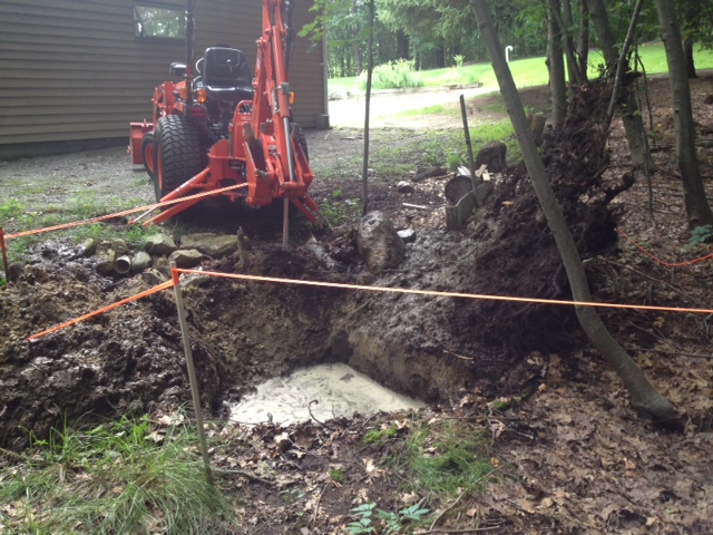

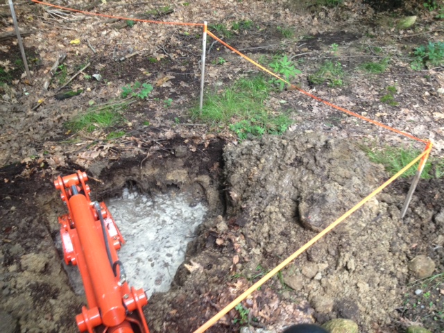

Ok we got some decent weather finally over the last week and the surface water receded enough for me to dig it out at least a little. Here are some pictures, I'm still not certain what it is and there's too much water to see the bottom still.

The hole is probably 3 x 4 at this point, the cavity appears to extend further out from the BH beyond it's reach from the current position, but the hole is smaller and further underground there. When digging water poured in from that direction. The edges are dirt and do not appear to be lined or anything, so this likely is buried material that rotted or a spring (or both). The entire hole seems like it might have been a pit dug out via an excavator as the sides are nearly perfectly vertical and the soil type changes on the site (soil in the pit appears to be consistent with Fill used to build the house and the sides resembles the soil in the area that has not been disturbed)
A view of the position. To the right is a tree that had been falling over last year, when I flipped the stump up I discovered that the root system is what was holding the top of the cavity up. When I fell through my foot broke through the root system. The tree is not that old, but may be 20 years (have to count some rings), which would give the minimum age if this were a dump site for woody materials.

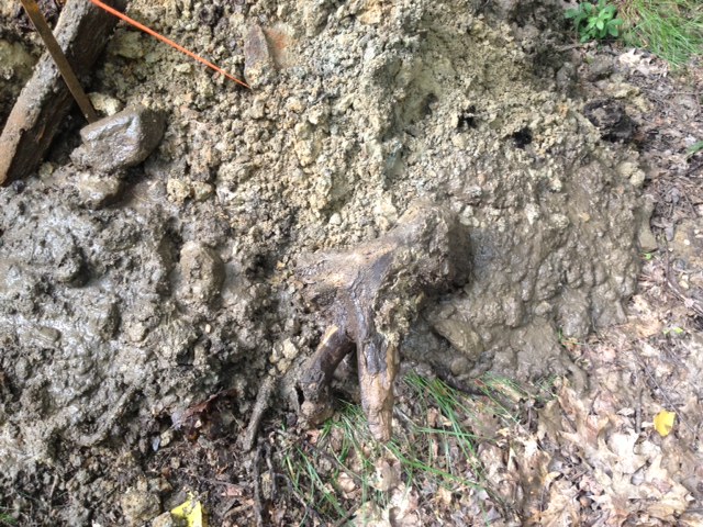

This is my 'smoking gun' in terms of what I think this is. I found a number of pieces of wood, no big stumps or anything, but chunks of wood that appeared to be chainsaw cut and a length of a few feet maximum. Pictured is a small stump, which was found 4' below the surface, so must have been buried, I can't see how it could have gotten there on its own. There was not much woody material, but definitely some rotted pieces. Anyone know what I'd expect to find in the bottom if someone had buried some wood here?

Massachusetts doesn't have a whole lot of karst topography, since it doesn't have a lot of limestone, being mostly granite bedrock.
I'm going to guess that this was an old wood-lined well or cistern. I remember several places around the area I grew up where farmers would sink a hole in a wet or damp spot, line it with wood so they'd have a spot out in the fields to water their stock with.
