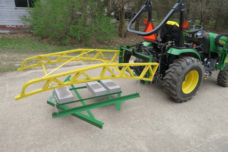

There might be some advantage if you have a big tractor and are working with a hard surface. However, if the surface is already loose I doubt it makes much difference. Mine works pretty well on loose surfaces, was built from scrap and cost about $25.

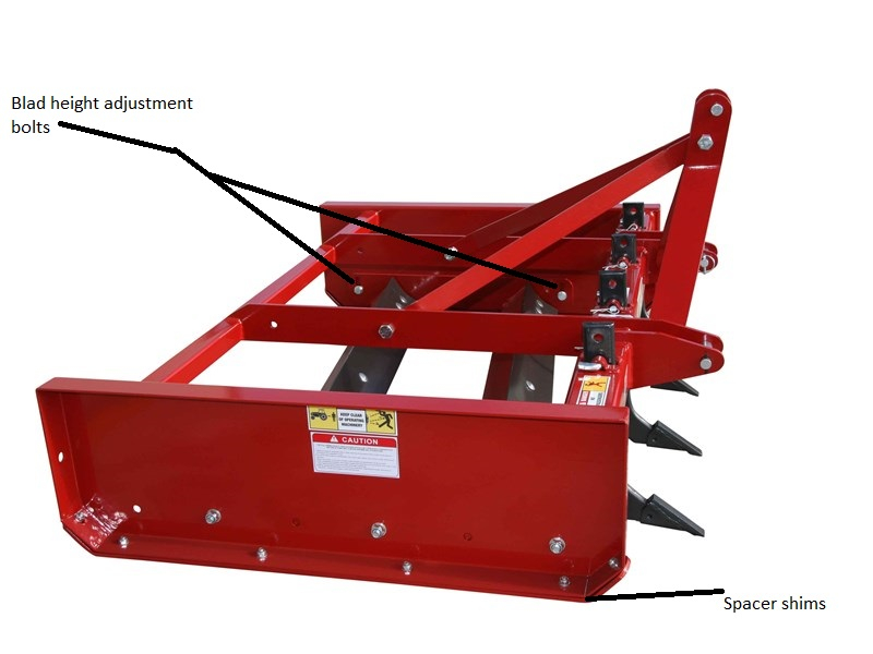

I have placed a 1" thick board between the skid plates and the sides which essentially raises the blades about an inch as mine are not adjustable and I wanted the blades to dig in less. If you want the blades to be even less aggressive just use a thicker spacer of wood between the skid plates and you might need longer bolts.

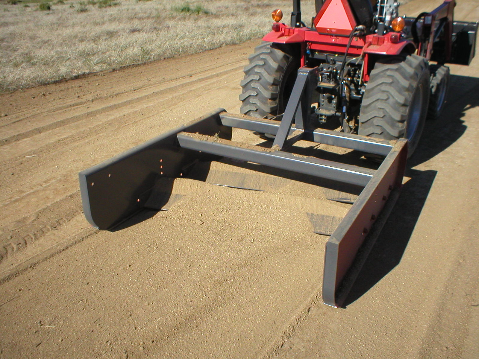

Here is one that has adjustable blade depth. I have just added a wooden spacer / shim under the replaceable ware skid plate on each side which accomplish the same thing.
   / Does a 3ph land plane need to have adjustable blades? #8
The blade height adjustment is to compensate for blade wear. As the blade is worn, one lowers the blade. Some LP's have multi holes in the blade holder to accomplish this. Others have slots the blade holder moves in, Others have both (Road boss)

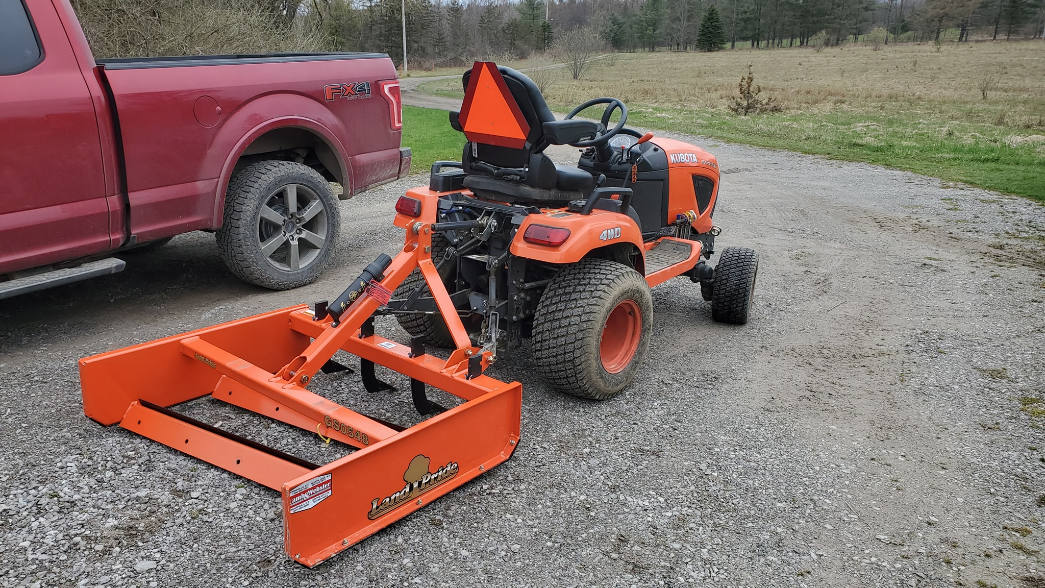

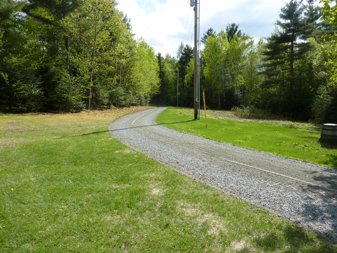

The cutting edges on mine are not adjustable. They are set 3/4" below the runners. I have over a mile of gravel roads I maintain and I have not turned the the dual edged cutting edges over yet after 8 years of use but I have replaced the mild steel runners.
The LPGS works beautifully for me and I don't feel the need for adjustable blades. Maybe just luck, I don't know.....

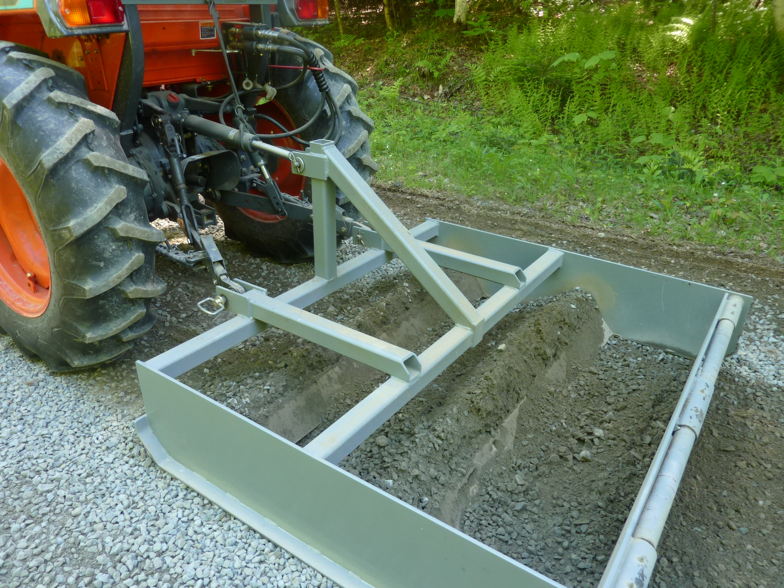

Fixed cutting edges on both of mine also, never needed adjustable ones or scarifiers for that matter.
