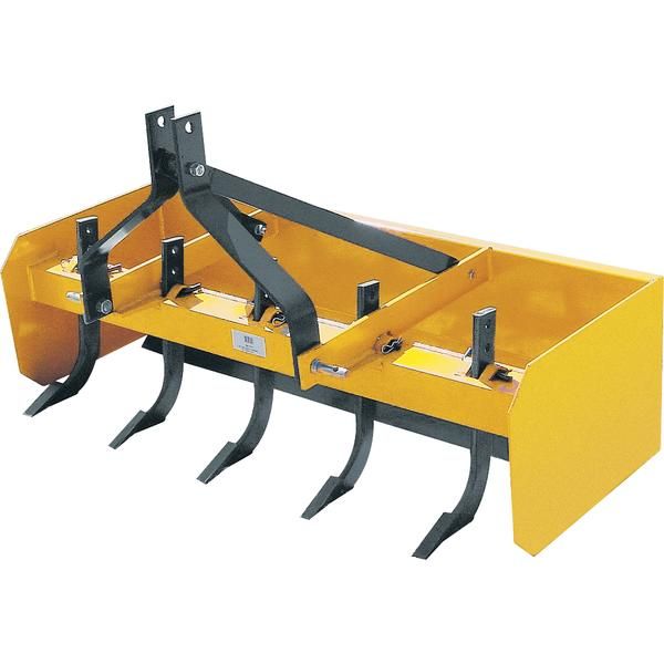

I have been looking at a TSC 72" KK box blade, is that one heavy enough?
The 72" BB would weigh more, but that weight is spread out over 6 feet. Would the 60" one work better? (I have a Ford 6610, so I figured I'd get the biggest BB I could find.)

Decent BB's have about 100# per foot of width.
Good ones are 125#
Industrial ones are 175 and over# per foot.
The TSC one maybe 350-400# for a 6'.
Weight does two things. It makes the box work better by digging in and being in control of the ground. Less bouncing, sliding over the dirt, etc. It also makes it more physically robust. Meaning it won't bend up like taffy on the first root or rock. Light duty ones are ok for pulling loose gravel or dirt, but not for demanding jobs. Choose your job, select your box, check with your wallet. It if all lines up - go for it!

Thanks john_bud, and I mulled over it, that's what I came to as well. The 400#'s looks about right for the TSC version, not a very strong top link section as 3RRL found out.
This picture is the 60", but the 72" is $469 with one more scarifer:

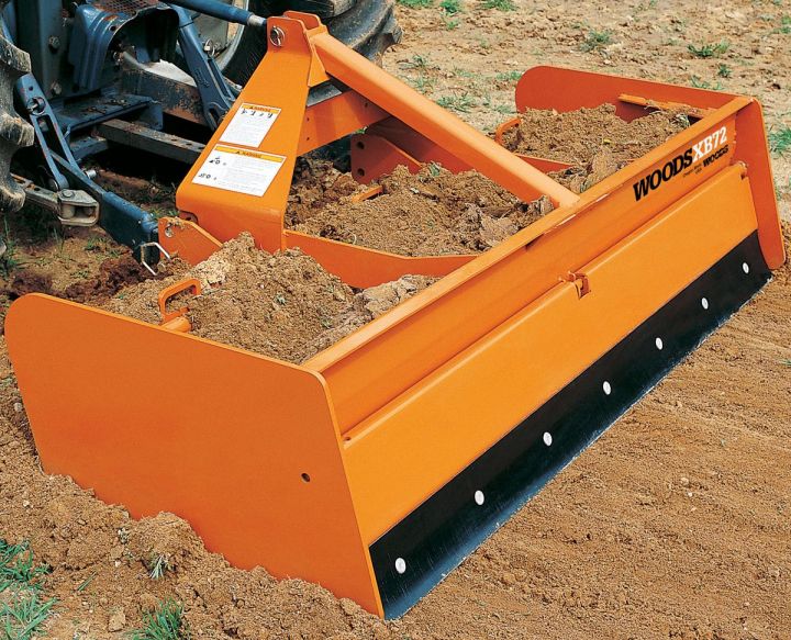

I talked to the guy who's putting the FEL on and he has a couple of options for me in the industrial range, 84", weighs about 710#'s for about $700 and change. Similar to this Wood's version with the beefed up top link section and a floating rear gate:
It's a bit of a stretch for me, but I've never been sorry to get something made better.
