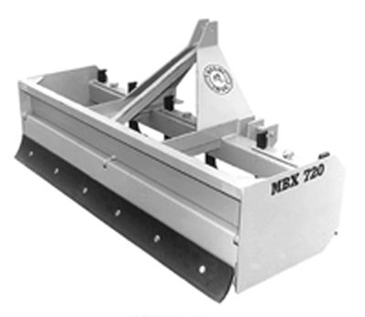

I was acused of being able to tear up a steel ball bearing with a rubber mallet. With that in mind, realize that the only problem I have had with my box blade is bending the pins and the part where they mount. The second picture of the Woods XB72 has the lift arms centered between two brackets, instead of a pin extending from one side. That is what I intend to do with my box blade, to prevent bending the pins and their mounting bracket. The pin going thru two brackets is superior to the pin coming out of a single side.
However, you have to make sure the boxblade fits, as you can't turn the pins around to the inside when it is the other way.
Buy the heaviest, strongest one you can find. You may regret spending the money on it later, simply because you won't know better. If you buy less, you will soon find out why you should have bought the more expensive one, and why they are more expensive.

Great point about the hitch points! Bush Hog uses a "triple lug" that you can see in this picture. There are three lugs with holes, the outside is Cat II, the two inside are Cat I. The pin is both Cat I & II, which is nice because you don't have to use bushings for Cat II, and you get the strength of the Cat II pin rather than just a Cat I with a bushing. I have a heavy duty boom pole like this as well.

Captured lower link pins are easier to attach and appear to provide additonal support. At least with my GB60. Jay

I agree with the last few posters. My united HD box blade has the same type of mounts. and I have never had a problem. I have several buddies with lighter duty versions and have welded, hammered and hot knifed on all of them. The box blade leads a terrible life, all you ever do is abuse it, drag it through the dirt, slam into stuff with it and see how much dirt it will pull until the tractor tires spin. Find the strongest one you can.

Also, I strongly support the comments about the benefits of a clevis style hitch, at least for strength. I have a scarifier (alone, not as part of a BB) with the other style that's only supported at one end of each pin, and I am constantly bending pins. In one case I also bent the 3/4" steel plate that the pin bolts into. I don't think this would be happening if the implement had a clevis hitch. Curiously, the other brand's version of the same implement does have a clevis attachment. Go figure! Wish I had bought brand Y...
