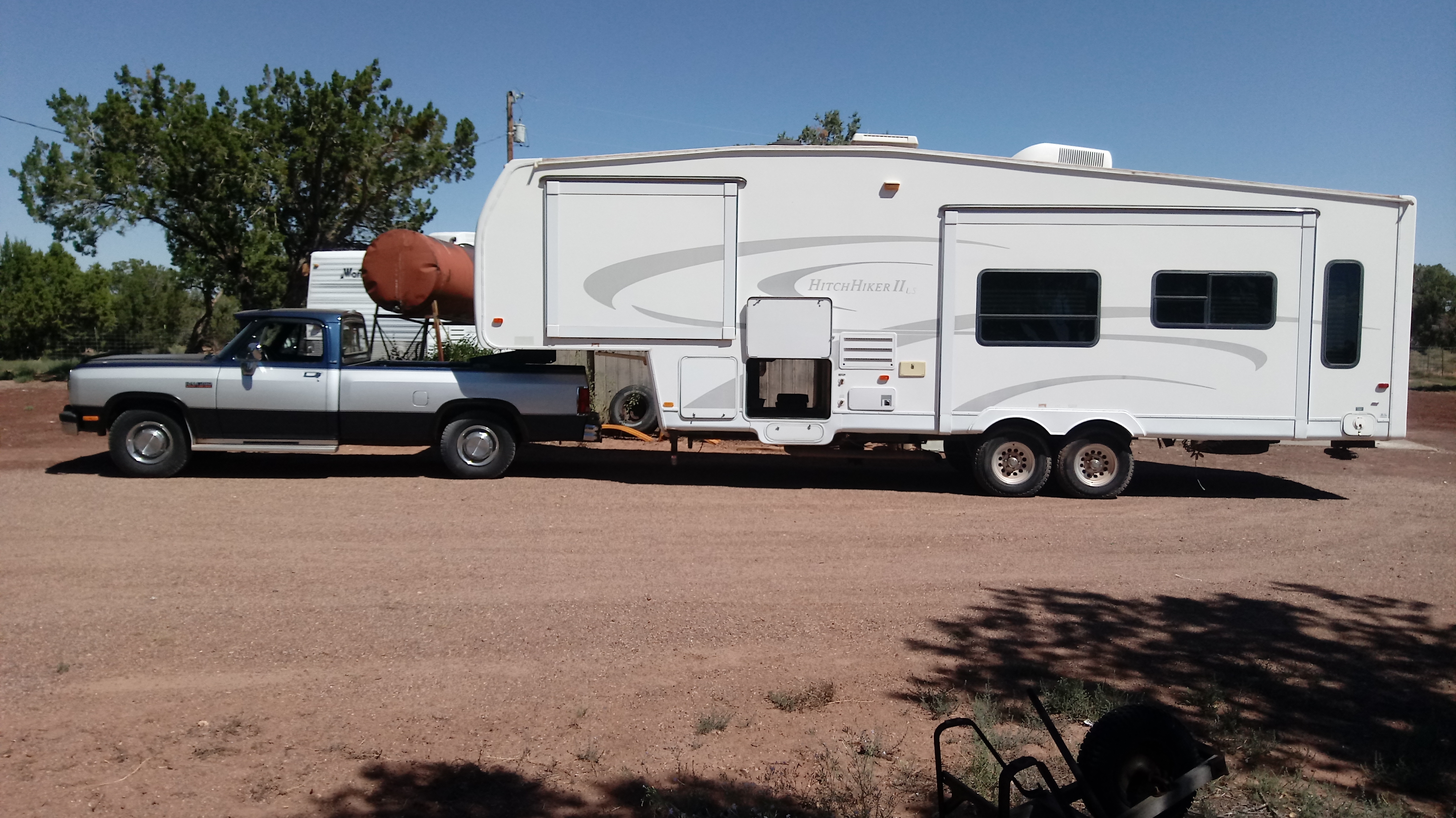

This is what 10k looks like, my '91 D-250 is barely big enough. However, back in the day when I was young and dumb:) my '70 F100 4x2 towed trailers like this...

10k on a 5th wheel is close to 2.500 lbs on the pin.

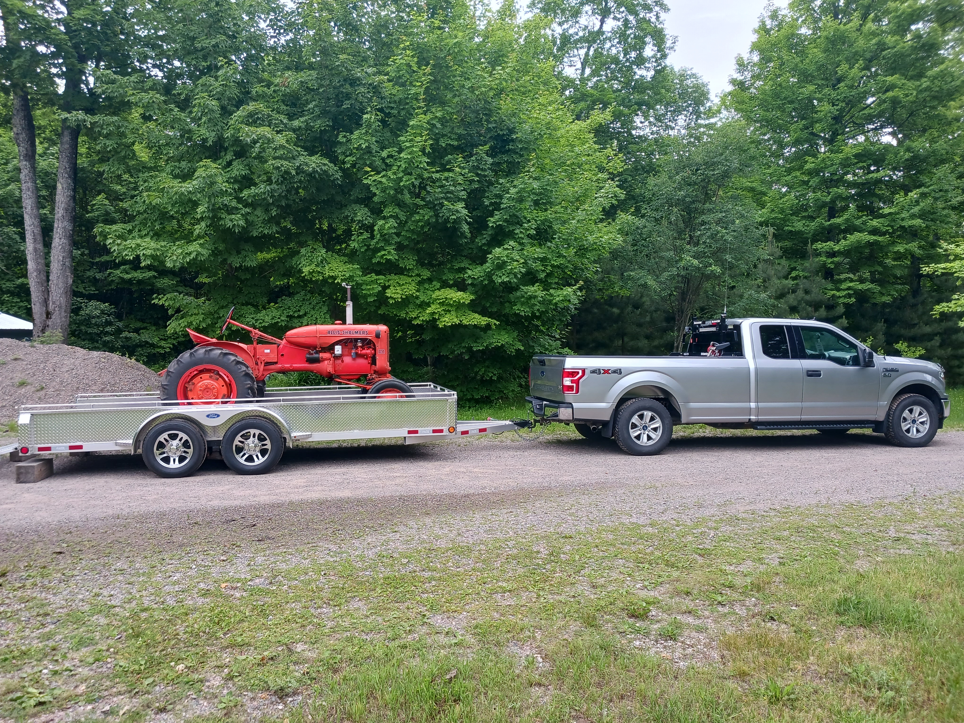

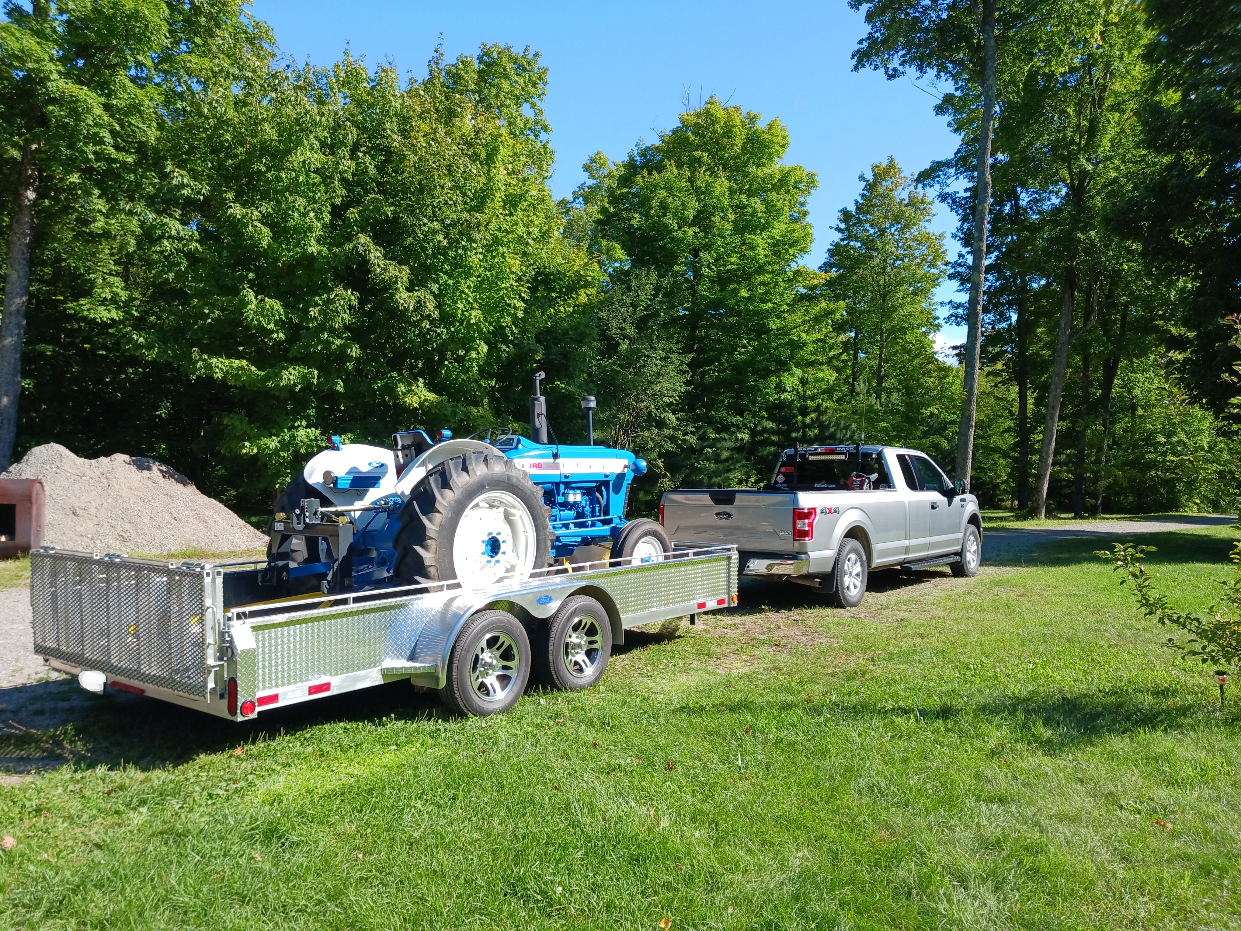

I don't tow that much, but I can't imagine hauling two of my antique tractors even on a gooseneck with my F150. Although my brakes are way better now after going to aftermarket.

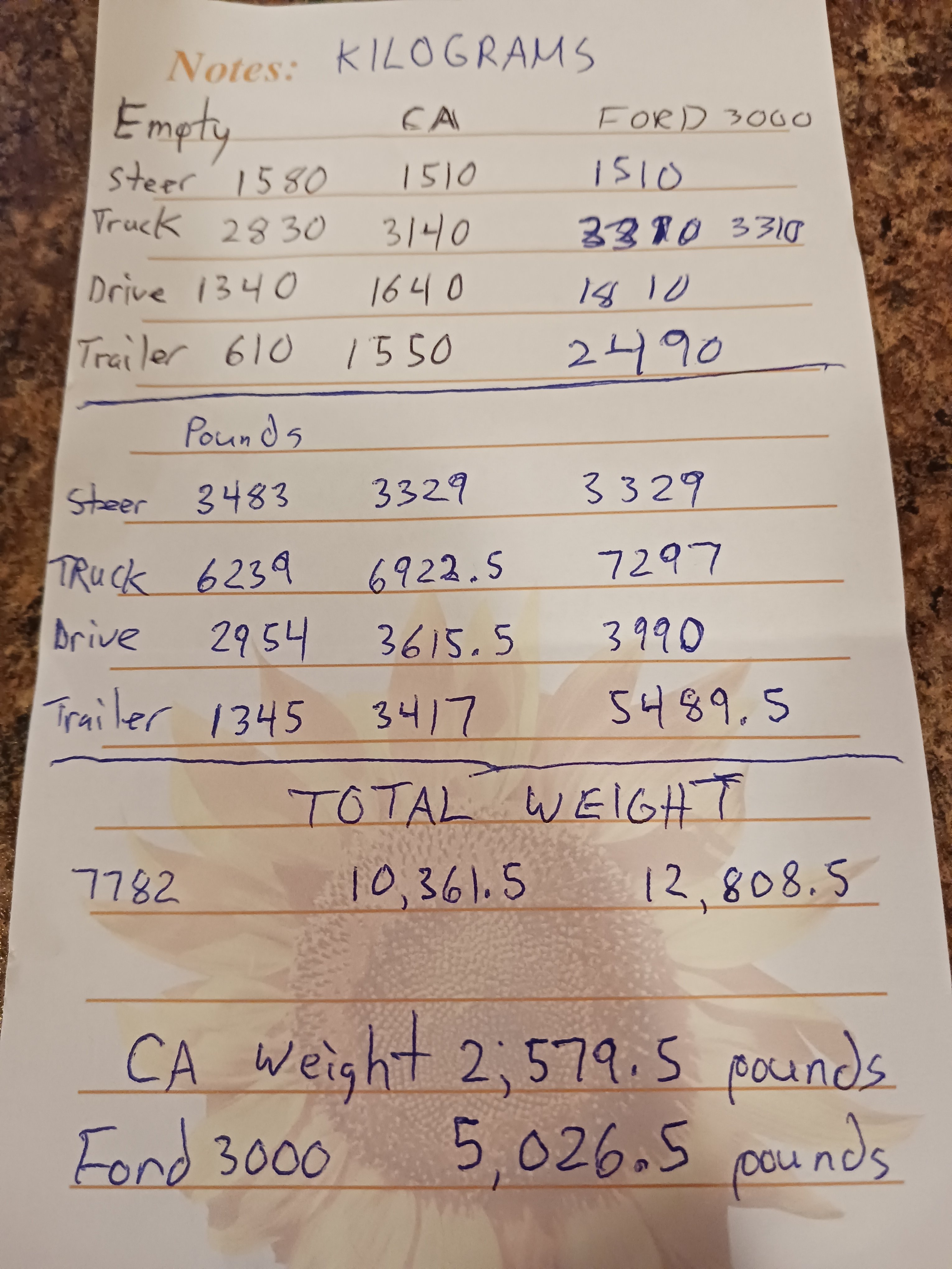

Here's some scale weights I got. Where it says truck, that is front and rear axle of truck only on plate. All the rest are the axle weights. This was the first time I axle weighed it just to see if I need to load different next time.
