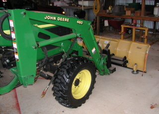

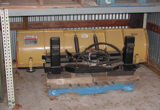

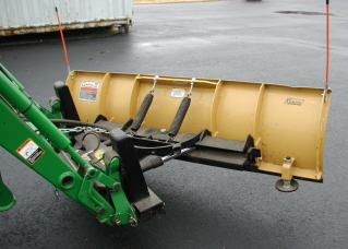

Here are some pics of the Curtis blade. My wife said it was time to get the winter equipment on. We don't get that much snow in OK, but she wants to keep the driveway clear. Last year got several inches and kept it clear - the UPS driver said we had the cleanest driveway on his route.
Pics 1 & 2: I keep the blade on a pallet for storage - take it out with the forks.
Pic 3: After driving up to the blade and attaching it to the FEL, it takes about 5 minutes to hook up the hydraulic lines and stabilize them, and hook up the chain in the middle of the loader.
Pics 4 & 5: Side view and front view of blade & tractor.
All of what I blade is asphalt driveway so the 4WD does well on it without chains. I use the box blade for ice - we seem to get a fair amount of ice here through the winter at times.
