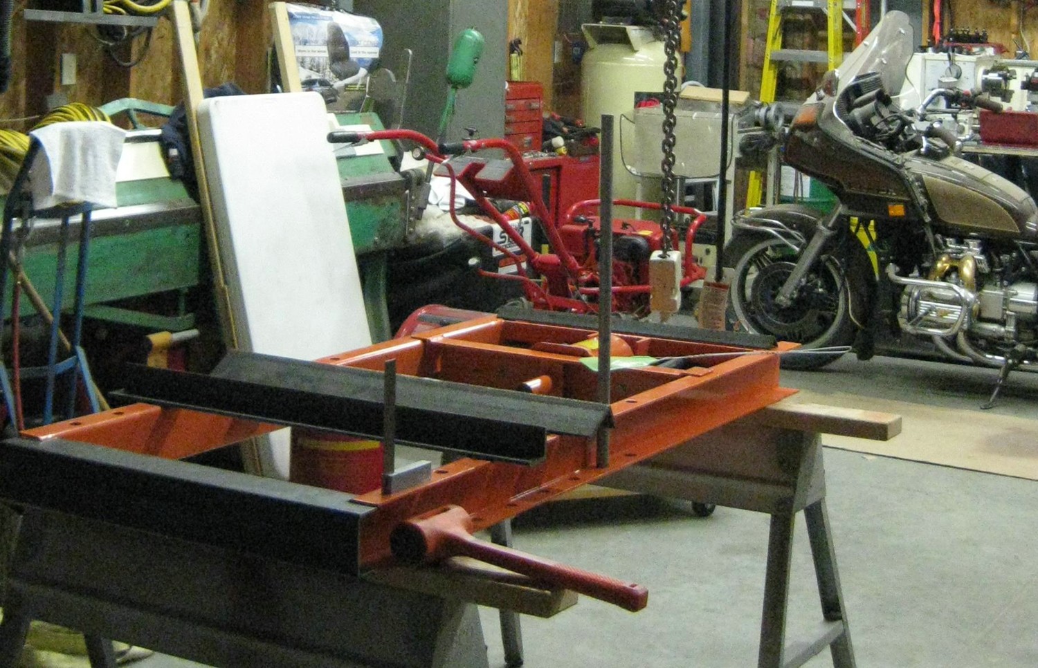

DFKRUG; I can't tell you how much welding up a replacement bottom for my 20ton press helped the stability and just made it so that it won't move around while setting heavy pieces on the table. I needed to extend the bottom by about 2" so I used a piece of 4x4x3/16 wall square tube and a couple of pieces of 1/4x2x3 angle for the bottom, then used a 1/8x1 1/2x3 rectangle tube for the feet, then welded it all up. Here are a couple more pictures:
Stan I can see that. I suppose the first time it misbehaves it gets stronger feets.
