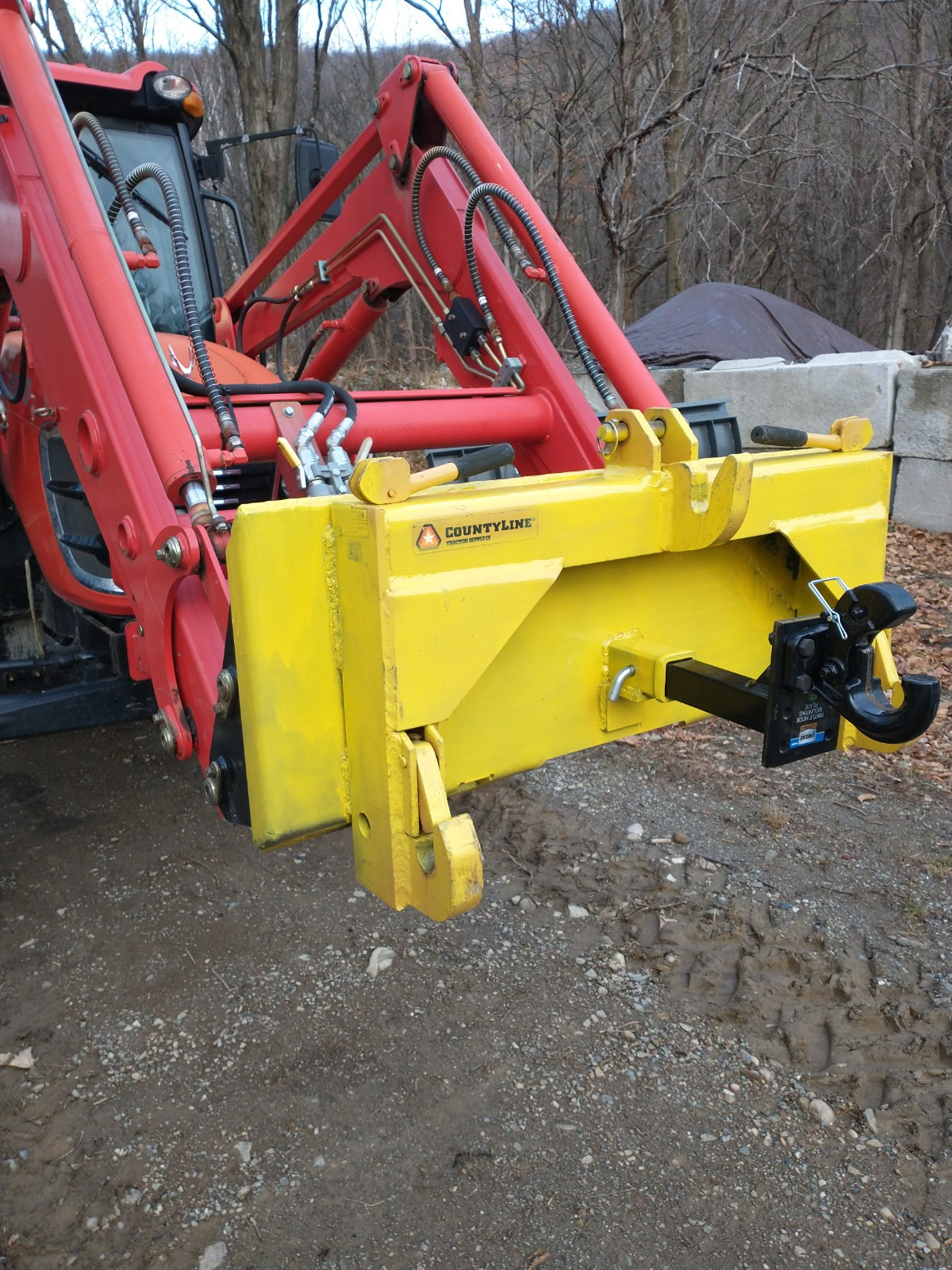

The few that I have been around and used or seen used had a pinch bolt to hold the lower sliding attachment points somewhat in place.
They are handy for a few items.
I made one for Cat 2 implements using an old quick hitch that I wasn't using.
I use it mainly for moving equipment around and with the receiver hitch mount it works good for moving trailers around into tight places.
It doesn't work that well for most implements to use them but is very handy for working on things.
