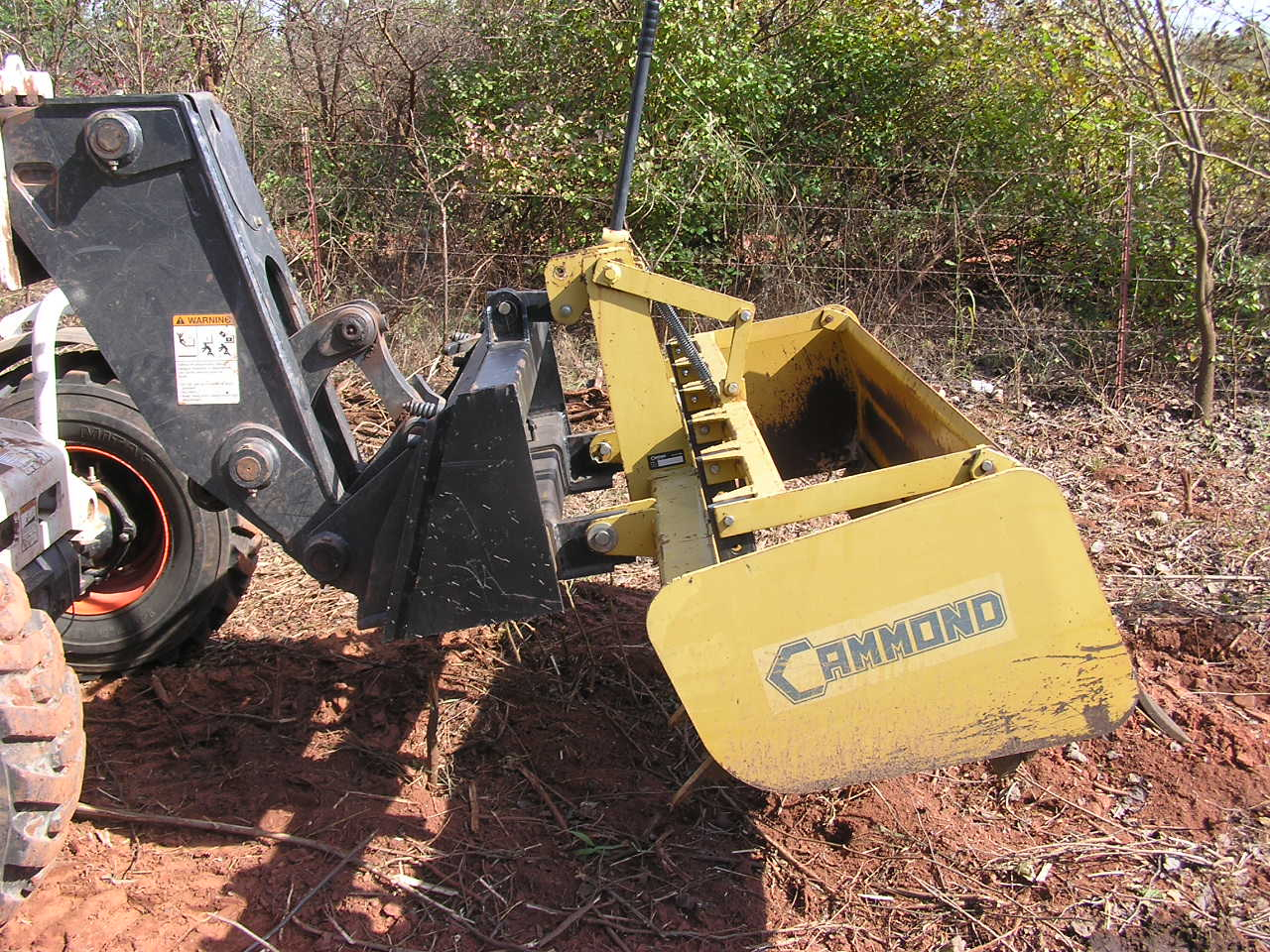

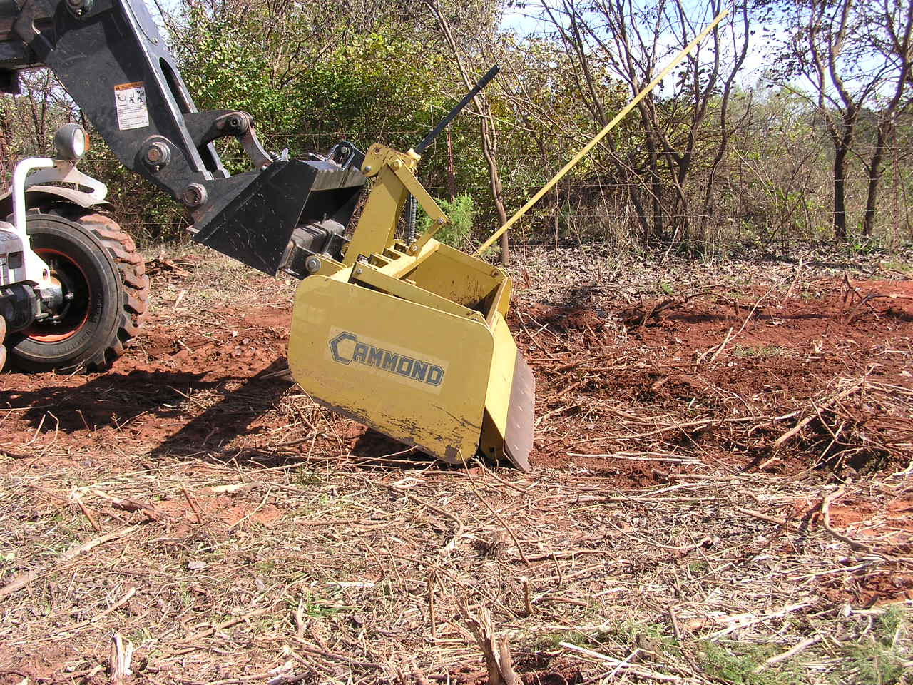

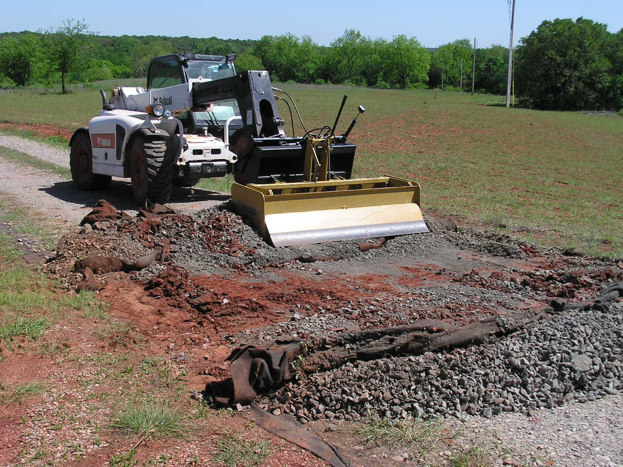

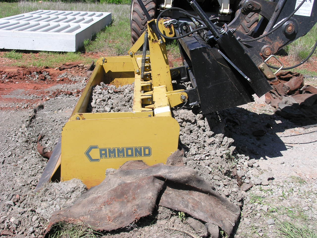

Wrong on the pressure and force to the ground for my 3PT Adaptor:
No play, slop or "slinky syndrome" on mine:
View attachment 764319View attachment 764320
That's awesome!!! On my L3560, that whole assembly works like there is a coil spring between the tractor and the plow I connect up to it.
The flex of the FEL, the SSQA, and the 3 pt plow that sticks out another 3 ft past the SSQA in the front of the tractor makes it feel like I'm playing an accordion, not trying to plow!!!!
If I touch the soil with the tip of the plow blade, and then apply downward pressure, I can drop the FEL about 9" or 10" before all the slack is taken up and the pressure of the equipment hits the ground.
Then as I'm pulling (or pushing depending on the orientation of the 360 degree plow blade) that slack will allow the equipment to ride up and down. So it's really not too useful.

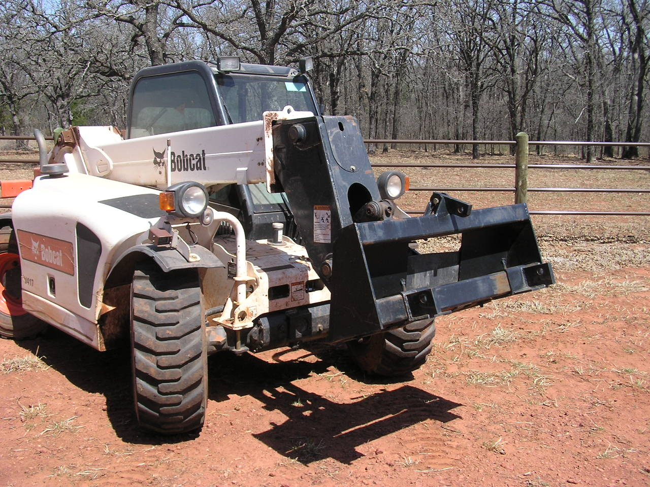

On this machine you have pictured, you can tell that the business end of the boom that the adapter mounts to means just that... business. It's made to do that. And it appears it does it well.
As for the L3560 Agricultural tractor ... I have asked it to do a lot of stuff, some things it does better than others, but for this type of an application... it's not well suited.
