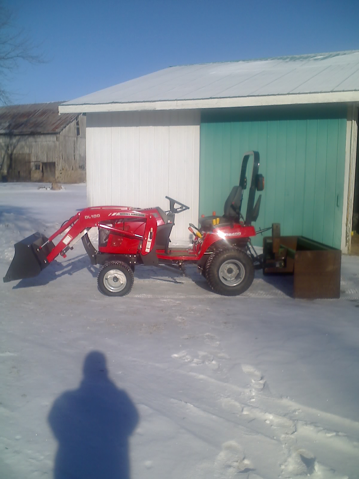

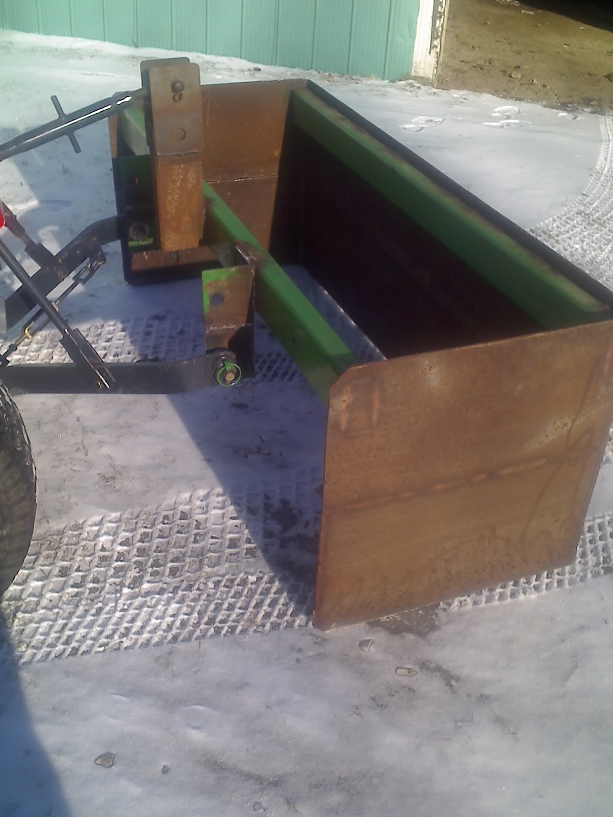

Here are a few pics of the box blade I am making and it is working well for snow removal
Looks good, maybe a bit large, but I was thinking that box would be sweet if you could mount it to your loader in place of the bucket, then you could move some snow!
JB.
I was thinking the same thing about the size after I built it. I was just using scrap material I had laying around. I am glad now of the size because it comes in handy when moving snow. Sides of the boxblade are 26 inches high and it is 54" wide. Gathers up alot of snow and makes snow clearing time alot faster.:D
