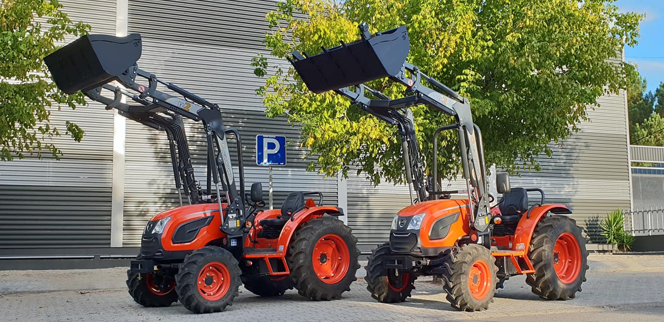

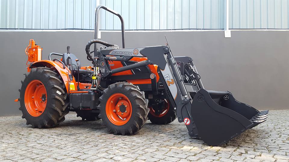

Here in Portugal we have two ways of getting a self leveling loader, either mechanical or hydraulic. The hydraulic is done by using two additional cylinders just above the lift cylinders that are tied into the dump circuit. I believe this way, avoids some of the issues mentioned above.
We the proper math and geometry it could be done in a Branson loader and probably could be done under the 600$ that Kubota charges for their self loading system.
Here is a couple of pictures as example:
17191512_1284153608346951_3920405246320148698_n.jpg41937291_1893425230753116_6823055492479188992_o.jpg
We don't get the Branson loaders here since the tractors come with a mid mounted ROPS. So the only alternative is to use aftermarket loaders custom fitted to the tractor. In Spain they use aftermarket loaders re-badged with the Branson logos. In the rest of the Europe, they use Branson loaders. 95% are self leveling loaders.
To be honest, I don't really understand why there is the need to have so much differences between US and EU models, at least in the loader part of it. The lift arms, DPF, lights and a couple of other things I can understand.

Interesting concept, I'm running it through my mind as to how that would work? Any information?
In my mind it seems almost like the extra cylinder is acting like a hydraulic pump to push fluid into the dump/curl cylinders to slowly roll the bucket downward as the loader frame goes up.
It would be interesting to see the entire functional operation of that system.
   / Does Branson Offer Auto Bucket Leveling ? How Important Is It ? #35
Yup. That's exactly how it works. The cylinders are just tied into the dump cylinders, acting as a pump.
I couldn't find any video up close of this working. It seems to be the same principle as the big telehandlers. John Deere just started using this system on loaders for the big boys, but they've put the cylinders above the loader arms.
