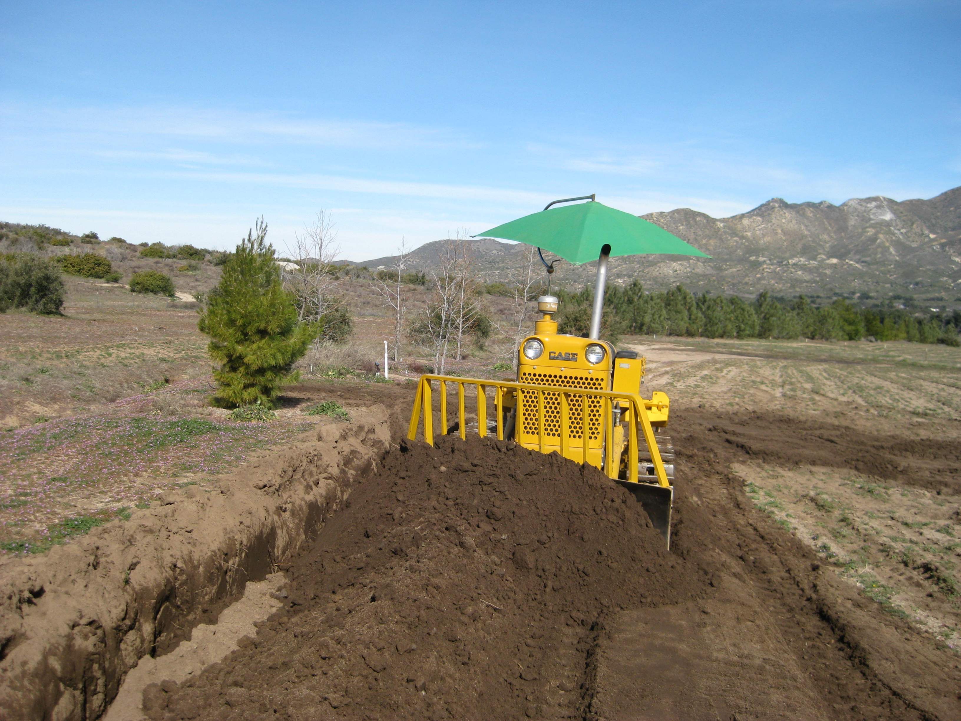

Do you guys think that the 3pt raises inches when plowing, pretty sure it does not unless there are actual obstructions. It does not take all that much to lower the draft load and allow the tractor to continue moving forward.
After viewing your last photo I agree draft will work better for that task because you're moving enough soil to resemble plowing. When I stated blading needed to be in depth control was for smoothing(leveling) an area. I've never measured how much a plow raises in draft but one can see plow move up/down from seat of tractor when plowing in draft setting.
While you can see it move, how much does it actually move, and it should be set for a stiff setting, so it would move more than for a fine sensitive setting. When I use my dozer, it doesn't take much to go from spinning the tracks to moving right along, less than 1/2" most of the time. Draft control simply does that automatically. :thumbsup:
How wide of a blade on your dozer? I like to see a video of your dozer in action slipping the tracks and then blade raises "ONLY 1/2 INCH" for tracks to stop slipping. I'm not stating it ain't so but sure would like to see it in action. Maybe soil is a lot easier to move in Cal. than TX.
   / Does Draft Control have any use for blade work (or is it mainly for plowing)? #29
90" wide, you can see the small lift points in the ground behind the tractor. I don't understand why you think it takes so much to let the tractor continue. It takes X amount to stop a machine, you lessen that amount by raising the blade. Why do you think the blade has to be raised a lot?
As an example, if the tractor can move 1000lbs, and it starts to move more, then it stops, but by lowering the load it continues on. You don't have to lower the load by a lot, just a little so that you maintain that 999lb load.
Anyway, it is what it is, believe it or not. ;)
