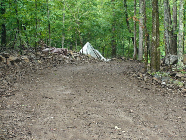

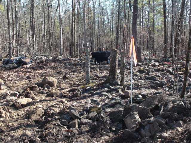

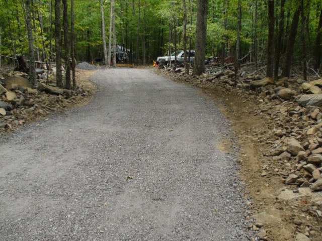

Per some instructions MtnViewRanch posted some time ago about how to setup and use draft control, I created a new driveway in my property I am clearing using a ROBB (6', 725#) and a rake with gauge wheels (7', 725#), along with TnT.
In my scenario starting from scratch, draft control and the ROBB worked wonders for this neophyte for the main grading. I have very rocky property and the ROBB and draft control made the bulk of the job far easier. And to this inexperienced hand, indispensable.
However, for the finish work of spreading and leveling the slag surface, I just could not get the ROBB to do what was necessary and was only successful in creating a mini motocross track. I am sure a more experienced person could have done better.
So I attached the rake with gauge wheels, no draft control and finished the driveway. It came out extremely well and I always get compliments on how professional it looks.
Before, during and after photos: DSC00404.JPGDSC00427.JPGDSC00506.JPGDSC00546.JPGDSC00581.JPG
