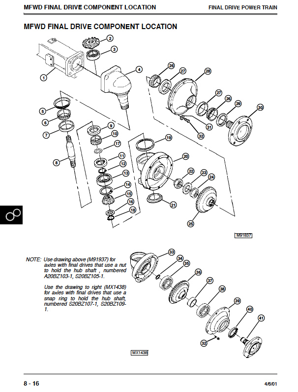

Can't find the 4300 manual, so maybe somebody can help with that (Brother Arrabil)
No vents in the 42/3/400 tech manual...
EDIT: Roy, what kind of vent is that? I hope its a pressure release valve seeing as how it better not be vented to atmosphere that low to the ground!

   / Does Everyone Have a Front Axle Leak? #33
Voila.... vented front axle.
Installation pictures after it stops raining.

What are we seeing in the pics attached? A replacement vent for the yellow dipstick plug?
Some welding on the nut? or fitting? a tube for venting? :confused: :)
   / Does Everyone Have a Front Axle Leak? #36
On my front axle I made it vent ,Its a ford and i juts took out the filler with level indicator, and used a CPVC plumbing fixture with a cap on it drilled a couple holes int he side and screwed it in. (1/2 ") Threads were a bit different but the CPVC just cut itself in.There was alot of pressure buildup in the summer with it working...
   / Does Everyone Have a Front Axle Leak? #37
Yes. I didn't want to ruin the yellow plug because I'm gonna keep it for measuring the correct fluid level. So...
The hole in the axle is 3/4"-10 thread. I bought a one inch long 3/4-10 plug with a hex socket in the top of it ($1.90). I drilled a hole in it. I welded a nut to the top of it ($0.99). I put a barb in the hex hole ($0.99).
I was going to tap the hex hole for the barb threads but when I saw the tap cost $10 (and that I'd need a bigger barb) I decided to grind down the threads some and hammered the barb into the hex hole after coating it in RTV sealant.
I'm going to put an o-ring under the nut just like in the original design.
The hose is going to run up into the engine compartment and the fuel filter ($3.49) keeps bugs and dirt from going down into the axle.
Very nice! I'm going to do the same thing before your patent kicks in.
Thanks. No patents! :)
