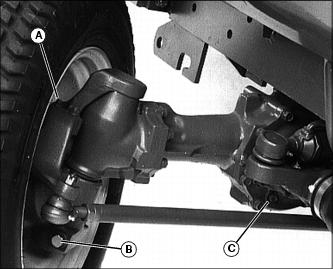

   / Does Everyone Have a Front Axle Leak? #24
suggests that some leaks are related to the spring warmup in temperatures the and related expansion of oil & air in unvented axles.
I'll third this opinion and add that the extra snow/cold this winter may have caused extra havoc on the rubber seals.
Roy, are you sure you're thinking of a 4300? All the axle variations are the same 42/3/400 and mine is also unvented.
My 4200 @ 1000 hours has evidence of a seal leak being repaired prior to me owning it (oil leak marks on the wheel).
Sounds like a common problem on the 42/3/400 models more than anything. Makes me think I should convert to vented. In fact, I'm going to True Value right now with the plug to see if they have something that screws into there I can drill and weld a nipple to.

Just to make sure we're all discussing the same thing, see the attached picture.
A indicates the vent location, B is the drain.
Picture comes from the current 3005 (790) manual
BTW, the 3320 manual does NOT show a vent. Can't find the 4300 manual, so maybe somebody can help with that (Brother Arrabil)

   / Does Everyone Have a Front Axle Leak? #30
only thing i see in my 4300 manual is the 3 drain plugs.
