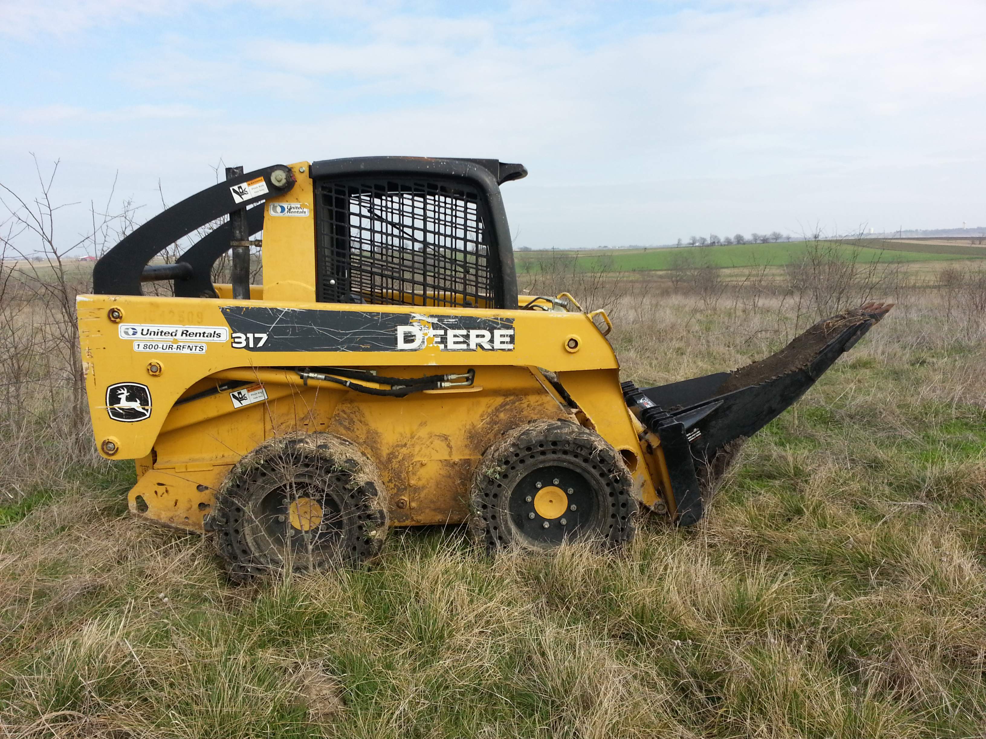

I have 30 acres of neglected range land that is full of 10 year old mesquite bushes. I use my skid steer and root bucket shown in the picture. I can clear about an acre in 2 - 3 hours. Pulling the bushes out is almost fun, smoothing out all the ruts and stacking the pulled bushes is less fun. That grubbing attachment link above would take one **** of a tractor, at least on my clay land.

I can't imagine using a sheeps foot on FEL unless it was offset, I'd never be able to see it. Don't see how it could damage it though since the FEL would go into relief first wouldn't it?
Do they make a 3pt sheeps foot? Wondering if I could achieve similar results as a SS with my hydraulic top link to angle down then do a vertical lift with 3 pt? Even better if there was a hydraulic clamp to hang on to it after ripping out so I could drop off in a burn pile. :)

You are right, The sheepsfoot grubber was designed for use on a skid. You can see exactly where you are putting the grubber, not so easy on a tractor. I sure don't don't think I would want to offset the grubber an put an asymmetric load on the FEL on a tractor.
