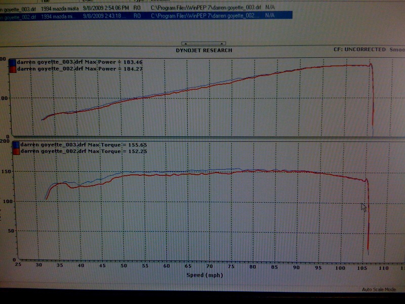

Well here is a dyno that is part of the basis of the opinions I have gathered over the years. This one is based on speed and not RMP but the car hits just under 60 mph in 2nd gear at redline.
You will see that at about that time it is making peak torque and stays linear even as HP increases. In addition there is a point where HP increases and Torque actually decreases. This is in a 1.4L Mazda engine.
Torque limit or peak on an engine will always come first. Power can still increase in a small window because the torque drop off is small (as seen on your dyno chart) and not enuf to effect increasing rpm so overall hp can increase at this point. The torque eventually drops off and so much so that it countermands any gains seen with increasing rpm and that's when you see power start to drop.
