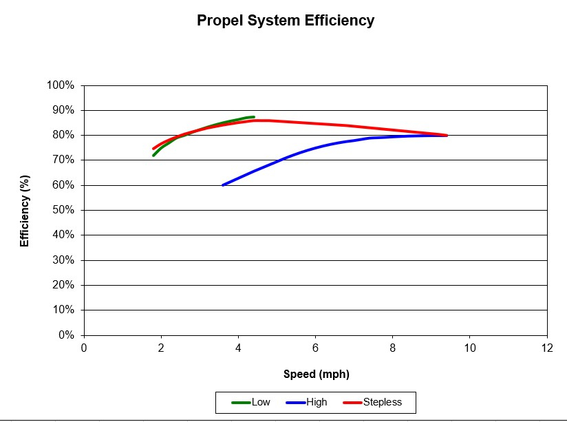

Here is an efficiency curve I had created by a hydrostatic system supplier when trying to resolve customer complaints that they needed to go faster than 4 mph (max speed at the max displacement of the propel motor) but the unit would not drive up slopes in high. This system introduced a variable control in the motor that varied the displacement depending on speed. What the graph really provides is the loss of efficiency of a hydro system throughout its range (this graph is at full system pressure 420 bar (about 6,100 psi). This is just the hydro system - following the motor there are gear reductions (just like in a hydro tractor) of which we figure 3% loss per gear set. In this cast it goes to a 40:1 gear reduction through a bevel gear and planetary so 6% additional loss due to the gears. In this case, the 107 HP engine will be putting about 77 HP to the ground not considering other parasitics (power steering, cooling fan, alternator). On the other hand, this machine (pneumatic tired roller for compacting asphalt) needs extremely smooth starts and stops to prevent ripping up hot asphalt and gears just don't cut it. The compromise is to sacrifice efficiency for performance. First prototype went to a crew that did have a mechanical transmission. They had converted the foot clutch to a hand clutch for the operator who had wore out his knee on the frequent shifts. It had a shuttle transmission but starts and stops were to abrupt so the operator needed to de-clutch at each end of a one minute pass. My Kubota L6060 would be similar to the green and blue curves - 2 motor displacements with no stepless shift.

Tractor PTO is mechanical/gear all the way through.
Engine power transfer to the PTO will be the same whether tractor has a gear transmission or an HST transmission as PTO does not interface with the wheel transmission.
Engine power transferred to tractor wheels will be higher with a gear transmission.
HST is easier to use and speed choice infinite but it is pump/hydraulically driven, which is less efficient transferring energy than mechanical/gear drive.
Only a few tractor brands offer an HST transmission on tractors generating more than 60 engine horsepower. Over 60 engine horsepower most new tractors are available only with gear + shuttle shift.
HST and Gear/Shuttle are equally reliable.
HST and Gear/Shuttle are more reliable than traditional Gear/Clutch .
VIDEO:
Neal Messick, Messick's Tractor, ( five stores in Pennsylvania )
relates that Messick's sales are 90% HST in tractors of 60 horsepower or less.
All the data I have ever seen show Hydro versions of the same tractor having less PTO hp than gear. I would submit that it's likely that if that small amount of power is important to you, you probably should be looking for a more powerful tractor to begin with, but Hydro machines usually show lower PTO hp.
