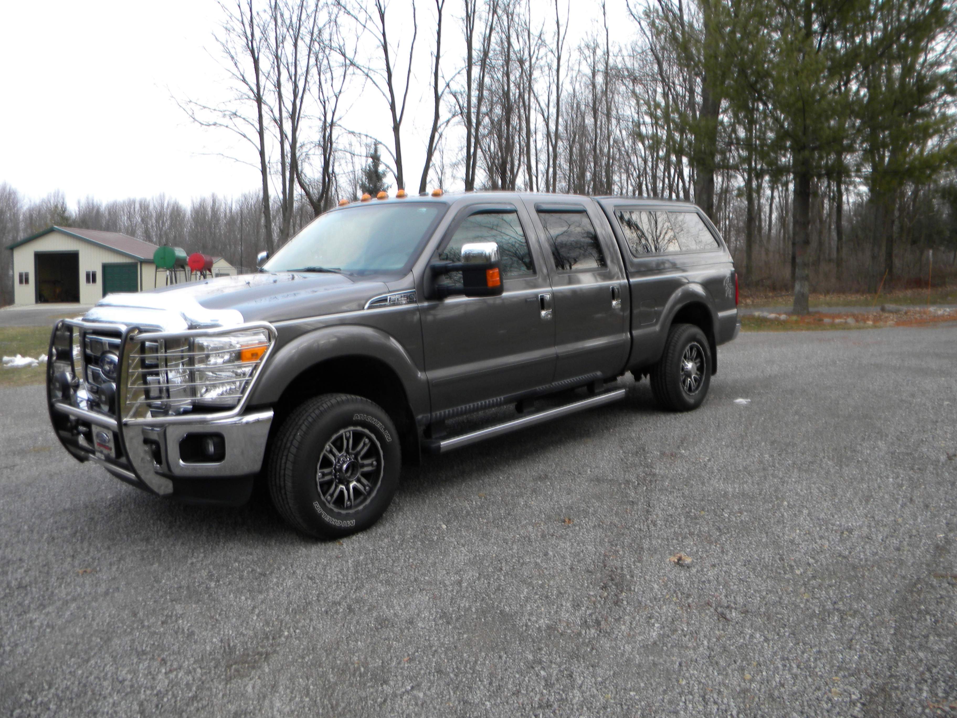

Not on the 6.4 hemi.I owned a 2011 F250 super crew and could not stand they way the rear end sagged when I hooked up my trailer.
