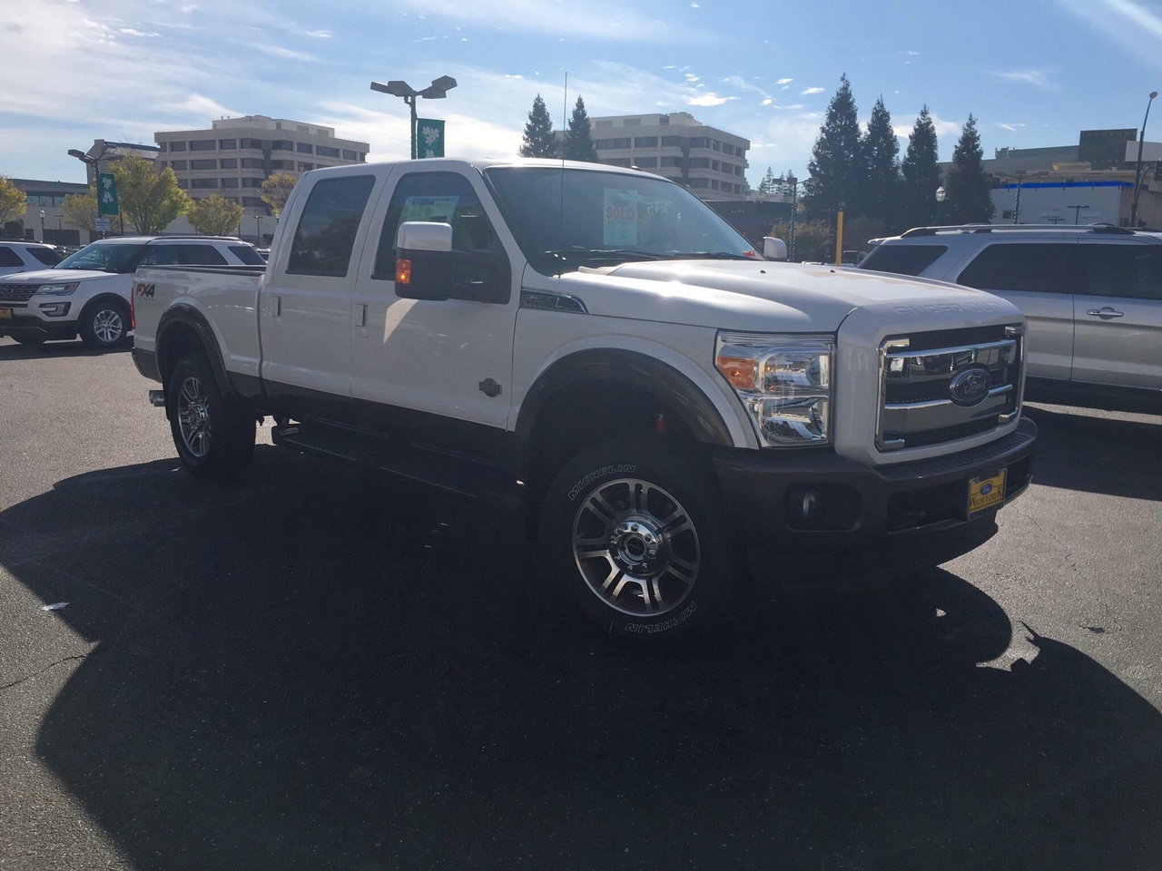

My one and only f250 picture so far... not the best angle as it was late in the day...
As mentioned the GVWR is derated to 9900
Front Axle is 5600 and Rear Axle is 6100 which totals 11,700 lbs
Tire Size LT275/65R20 Load Range E at 65 psi.

My one and only f250 picture so far... not the best angle as it was late in the day... As mentioned the GVWR is derated to 9900 Front Axle is 5600 and Rear Axle is 6100 which totals 11,700 lbs Tire Size LT275/65R20 Load Range E at 65 psi.
Nice.
Axle ratings are just that, ratings. It may have another weak point.
Chris

I was hoping you would reply...
This is my first experience with the Ford derate option to 9900 and the Dealer said the only difference between the derated version and non-derated is the number on the weight sticker.
With the Axle combination at 11,700 and the Michelin Tires set at 15,000 my thinking is there is some wiggle room?
