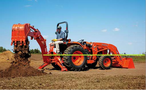

I was wondering if the weight of the Front End Loader gives the tractor more stability if kept low while mowing the law and othe tasks that don't involve the FEL???

I would say that more than half of the weight of the FEL is below the tractor’s COG when the bucket is carried a few inches off the ground. This will lower the tractor’s COG. While the FEL will want to rotate the tractor forward, this would lift up on both rear tires equally, move the COG forward, and only make the rear end a little lighter. While the front axle can pivot, I would say this pivot only plays a part in keeping all four tires on the ground on uneven terrain and that the rear axle is what keeps it from tipping over. While the back end may be a little lighter, having a lower COG, it will be a little more stable. I think this only applies to certain conditions like side hilling and not when you are going up and down the hill. Depending upon the angle of the tractor going up or down a hill the it may be front heavy and lose traction. That's why I only said that keeping the FEL low can help rather than always would.
Edit 1: Also I would say that since the front axle has a pivot and connects at a single point, the down force on both front wheels is identical. Because it pivots, the weight cannot be applied more to one side or the other.

You dont account for the reduced proportion of the composite tractor/implement weight that rests on the rears. COG height may be slightly lower but is shifted much more forward. ... Also, yes the front pivot divides weight equally between the 2 fronts -- BUT only on level ground. On a slope a vertical line to the ground from the pivot shows the actual division point. Thus a lower front pivot would cause more equal sharing on a slope.

Disagree. Let's say you are going across a hill so that uphill is on your right. The pivot point is the outside of the left rear wheel. The COG is at a given height and given position, but certainly inside of the left rear wheel. Now add your FEL. Some amount of weight shifts forward, so the COG moves forward. It may or may not move down, depending on the position and weight of the FEL. But what changes dramatically is the pivot point. It is now up higher and the total COG is going to be downhill from that axle pivot. You moved the COG for sure, but you also moved the pivot much more dramatically by 1/2 the width of your tractor to that axle pivot and made it higher as well. The COG is now to the left (downhill) of the pivot instead of to the right (uphill from the left rear). Now, all of these statements are made assuming 100% of the COG and pivot are made on either the entire rear end or the entire front end, but these are your 2 limits. Anything in between is just a graduation of the effects. The best you can do is 100% weight on the rear end for stability. The worst is 100% on the front axle pivot. Obviously that is not real world. But it's enough to say with 1000% certainty that the physics say to leave it off for sidehill stability.
At some point when you have tipped far enough, the tipping point moves from the front axle pivot back to the outside of the downhill tires, but by that time you'll need new shorts anyway.

I believe you are missing a key point. Gravity not only causes weight - but also causes SHIFTED weight changes when it pulls at an angle. The FEL on a side hill causes a normally balanced 4 wheeled tractor to become a leveraged teeter-totter (SP?). You agreed that the side hill creates a shift in a 4 wheel unit's COG toward the downhill side, but then you'd have to also agree that adding weighted leverage AHEAD of the front axle - not only adds weight in front - but also adds a COG weight shift to the downward direction of the hill just as the tractor itself did. In addition, a single wheel (front wheel on the down hill side) becomes considerably more of a pivoting point (again just like a teeter-totter) - for the whole tractor. The pressure to the ground is greatest at that downhill sided front wheel when sidehill cutting - which is why you mark or impress the ground (and the grass) deeper on the downhill side when sidehill cutting. And the wheels doing the most shifted impacting of the ground "without" the FEL would be both wheels on the downhill side (front and rear) - but "with" the FEL attached it becomes 1 wheel gaining substantially (front downhill wheel).
