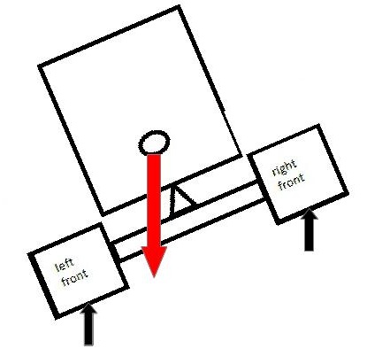

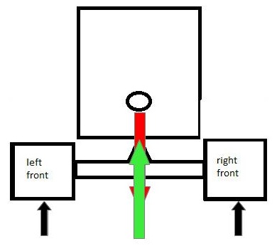

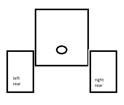

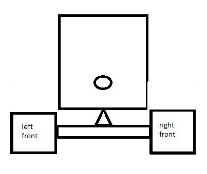

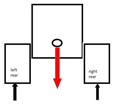

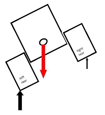

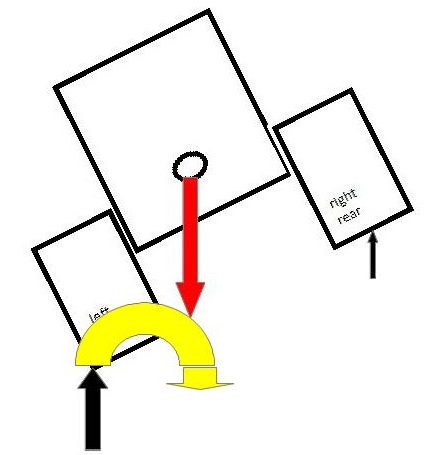

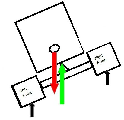

OK, last time I'm gonna try to explain why this does not work. With every ounce of my artistic being on display :) It's been 33 years since I took my statics & dynamics class, but I'm pretty confident of my analysis.
Again, I used the 2 extremes of only back end or only front end to illustrate. Anything else is in between these extremes. My assertion is also that if the FEL is heavy enough to lower the COG to any significance, then it is also heavy enough to cause weight transfer from the back to the front. So, let's get started.

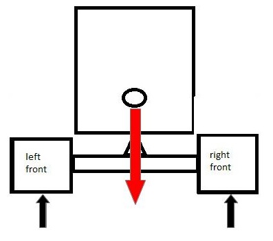

The first 2 pictures are of your tractor on level ground, front and back. This shows your basic wheels, body (rectangles), and most importantly, the front axle pivot (triangle) and COG (oval). All other images are derived from this incredible artwork base.
Now, let's look at where the forces are applied. The next 2 pictures show forces from all 4 wheels and how it holds the tractor up. The black arrows represent the ground holding up your tires. The red arrow shows the COG pushing down. The third picture adds a green arrow pushing back up on the red arrow, because that is where the up force is really applied on the front axle (the 2 front blacks combine to form the green). Again, obviously part of the red is on the front and part on the rear, but to prove the physics, I'm dealing in extremes.
Next, let's tilt the tractor and see what happens to the forces as we do it. Notice that the COG stayed the same from the tractors point of view, but it moved closer (downhill) toward that outside rear wheel tipping point. It is still inside the tipping point though, so stability is maintained. The lifting force on the rear wheels changes and is demonstrated by the different sized black arrows. The upward force on the two front wheels remains reasonably constant, so the black arrows are the same size. BUT adding back in the upward force on the pivot point (green arrow) you can see the beginning of a problem on the front end: the COG is now downhill from the pivot point.

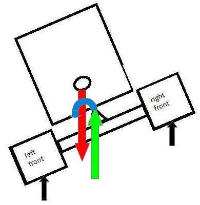

Going the next obvious step, let's look at the rotational force the COG is applying by pushing down where it is located. The nice big yellow arrow shows that the weight of the tractor is going to counteract the hillside and try to hold the tractor down (net effect of the larger black arrow pushing up and the red arrow pushing down). But on the front end, the small blue arrow shows the net effect of the red arrow attacking the green arrow. It enhances the tip caused by the hillside and is applied at a higher point on the tractor.
So, the question is, do you want your tractor to demonstrate the yellow arrow or the blue arrow? When you mount the FEL, you are voting for a larger blue arrow and a smaller yellow arrow.

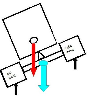

For academic completeness, the only way that adding the FEL can help stability is if it lowers the COG vertically on the tractor's center line to the point shown in this last picture. Once lowered this far, it could actually help stability because it has a (very short) lever arm uphill from the front axle pivot (total horizontal distance from the pivot point to the new COG) as illustrated by the large cyan arrow that would replace the red arrow. And as I stated before, I have yet to see a tractor with a FEL that I believe can lower the COG that far.
If you still don't see it...well... keep your ROPS up and your seatbelt on! Happy tractoring, Fellas!

Nice write up and illustrations Ray.:thumbsup:
Thanks Roger. I won't tell you how long it took me to draw them. :laughing:
And by all means, try what Bluegill2 suggests. Just remember, when you find out (and at least 2 of us on this thread have), now you'll know why.

Nope. As I noted before, the only thing the FEL does is make the yellow arrow smaller and the blue arrow bigger. It transfers the weight from the back to the front. Since it is not in contact with the ground, there are no vectors at all beyond the ones I illustrated. With the noted exception of the oil tank in the uprights, but that is probably not going to be dropped off the tractor with the rest of the FEL. So it shifts the COG to one side a little bit at the outset.
And yes, you can drop the FEL if you get in trouble. But what does that do? It shifts the weight off the rocking front end. It is arguable that it now provides a second (almost identical) lower side pivot point. So what? How did you get into trouble in the first place? Your choice in this situation is to drive with the FEL dragging on the ground and the front wheels in the air or lift the FEL back up and put yourself back into the situation for which you lowered it. Better to not have it at all rather than try to ride the razor's edge.
