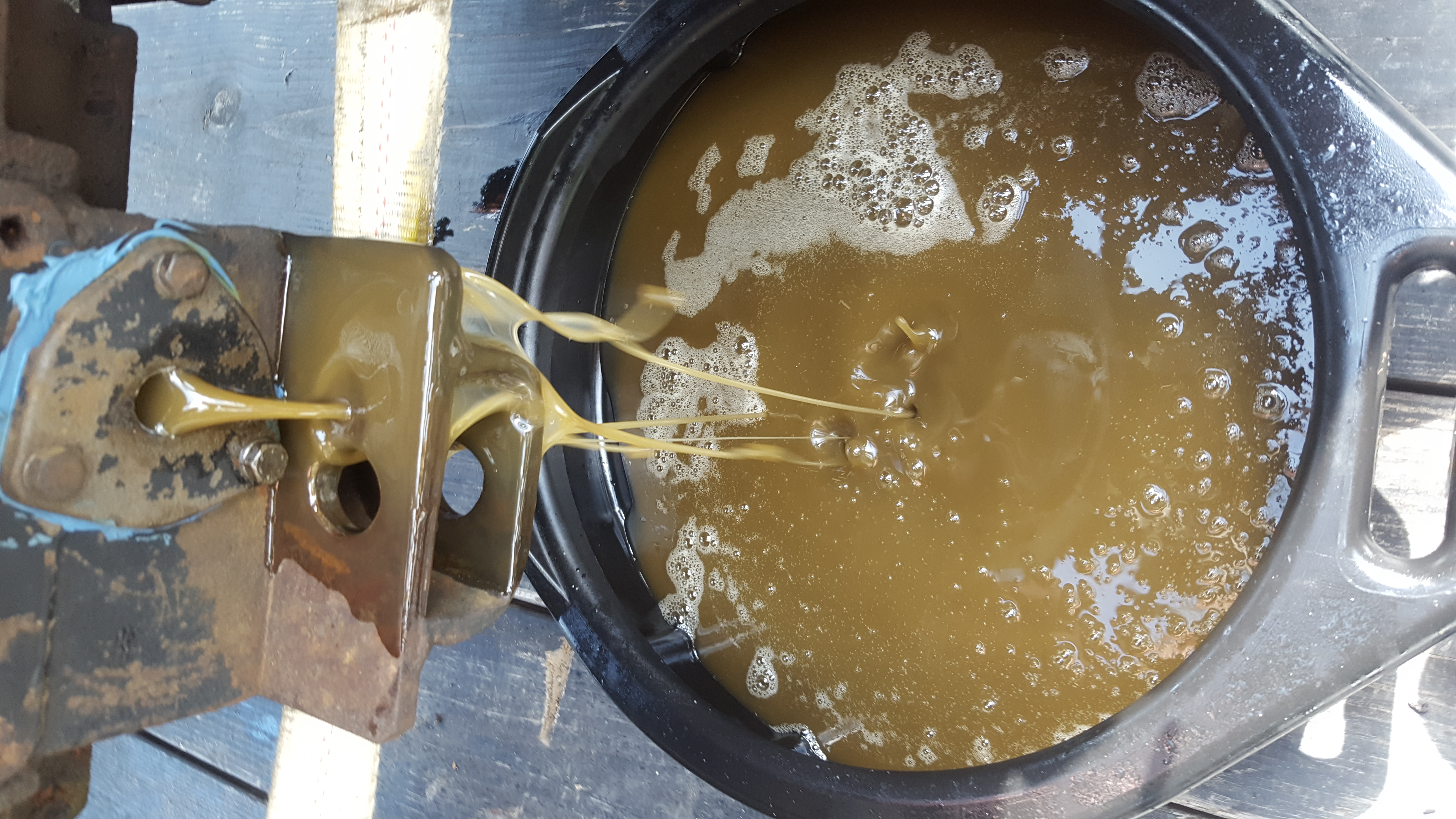

No way I'd use that fluid !! You can buy a bucket for as cheap as $20. And always under $30 and ag stores or TSC usually. Walmart is usually not the cheapest place for "303" fluid.
   / Does this look like correct trans/hydraulic fluid? #14
I would NEVER put that same contaminated oil back in. A possibility is to use a cheaper genetic brand oil (many say TC carries good Hyd. oil) and run that for a short time to flush the hydraulic system. Then drain that oil and refill with what ever brand you prefer.

I ended up changing it. 303 is getting banned in a few states "to protect the tractor". Not sure how legit this is. Sounds like lobbyists or some sort of business involved in politics to me. Why would the Govt. care about the quality of oil in a tractor tractor?

According to what I have read, yellow bucket 303 fluid is the lowest quality fluid in any brand.

The current 303 is such a sub par quality oil that it has been banned in MO, NC and maybe other states. But it is probably an upgrade from what the OP drained out.
Oils claiming to meet the old JD 393 spec are becoming banned in some Ag states simply because there is no such thing as a JD 303 spec. anymore. So quoting JD 303 as a specifiction is too often a scam used to sell cheap oil at higher prices. Don't fall for it, there is no governing body that makes sure that the Trans/hydraulic oil at the discount store has any of the qualities of a name brand. I'd agree that the Fed. gov't doesn't care about quality of oil in a tractor, but some farm states have state legislators that do. That's why you see it as a state issue.
That said, the Yanmar hydraulic & power shift system is overbuilt and incrediably rugged. So it will run on just about anything. From the photo posted by 777funk, It looks like his - like many - ran fine for years on a mix of about half motor oil and half water. The milky detergency is the giveaway. That doesn't mean that particular mix is the best thing to run in them.
Running any kind of oil without the water and crud mixed in has to be better. Running a real trans/hydaulic oil is better yet. How far you go down that road sort of depends on how you feel about gambling on repairs.
