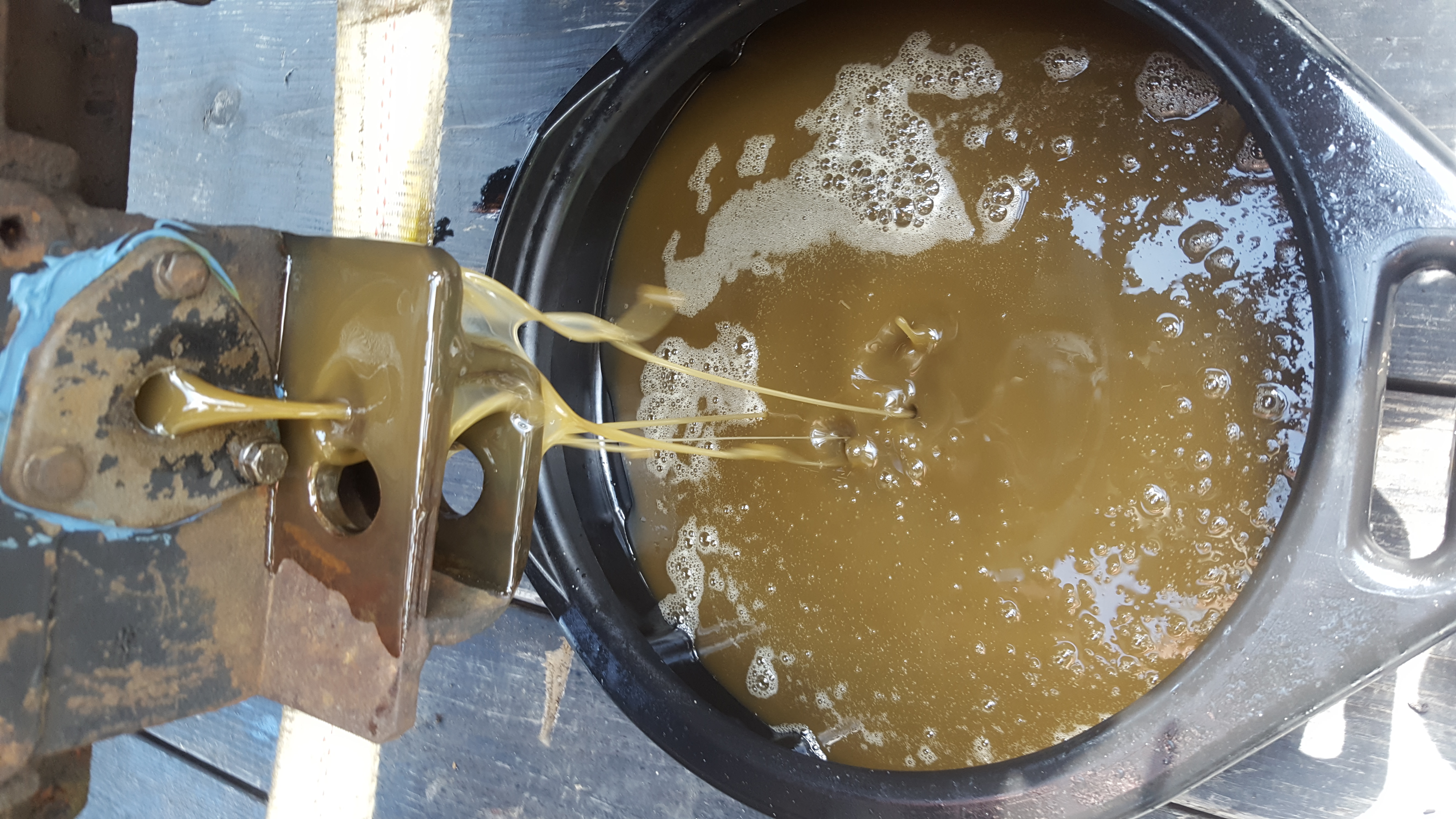

So I'll bet the oil that came in the tractor was generic 303 oil (yellow bucket) with water added from time. I read in reviews at Tractor Supply Corp on bargain bin $20 for 5 Gallons 303 that it turns into a sludgy glue when mixed with water. That's exactly what coated my fluid screen (and probably spin on filter). It was almost stringy.
I will probably get the next step up and read reviews for future hydraulic oils. I bought walmart combination fluid. Seems to have ok reviews.

Here's what came out of the new to me 336D:View attachment 607674
WOW and yuck. LOL
Like Winston said, a bit of condensate water has mixed into the fluid.
For our tractors, J20C is the correct fluid to use. WHY? Because Yanmar has made a majority of the John Deere CUT tractors. In some instances, these tractors are only different by red or JD green. John Deere specifies J20C for the entire range of the CUTs from the Yanmar 1978 to present.
With that all said, you can buy OE John Deere J20C for $$$$ or buy from the normal oil companies the J20C that MEETs or EXCEED the standards. I bought J20C branded product sold by one of the major oil companies. Not the JD green jug for $$$.
