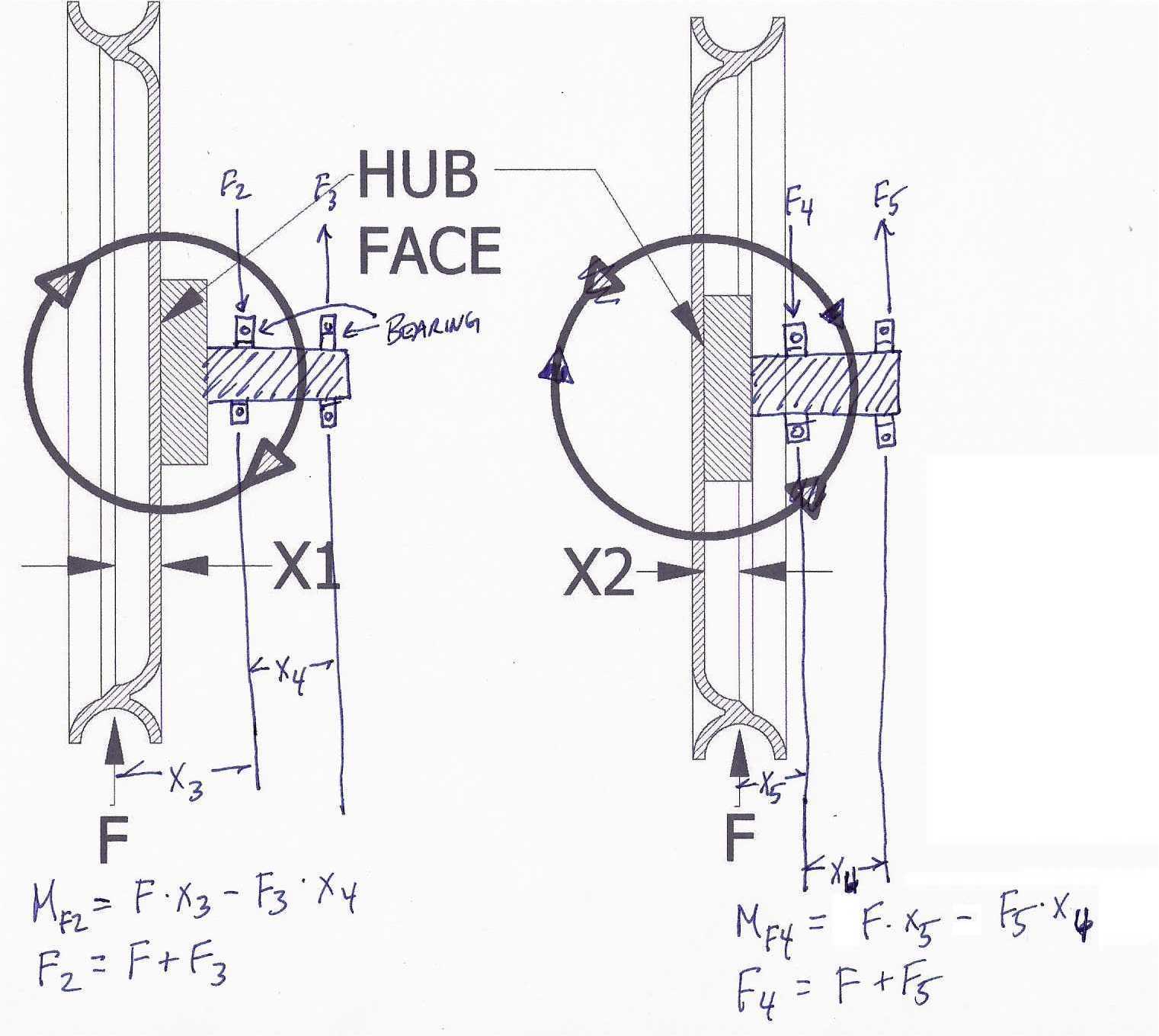

Here's another analysis (isn't this fun???). Excuse the "chicken-scratching" as I didn't want to redraw w/ bearings, etc. Anyway, all "F" variables are forces, and all "X" variables are distances. MF2 and MF4 are the sum of the moments around the bearing closest to the hub in each case. Since the distance "X3" is more than "X5", with "F" a constant representing the weight of the tractor on the tire, the forces on "F2" and "F3" must be higher, and therefore see more stress in the left scenario (wheels out) vs. the right (wheels in). This analysis assumes the bearings can pivot in their race which may or may not be true.

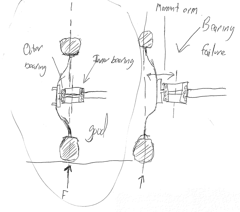

Very good i started reading this earlier and was getting frustrated reading through the thread and made this picture showing pretty much the same thing but you posted first.
In design you really want the centerline of the contact patch to be centered between the bearing races to minimize the moments as you have mentioned. On a side note I work as an engineer at GM my group owns the Brake and Bearing components.

Thanks for the secondary analysis and design tips/goals. I put some numbers to the variables and came up with the attached. I tried running it with your method, but I wasn't sure how to resolve the vertical forces and moments. Anyway, I'm getting an outer bearing stress increase of 63% and inner bearing increase of around 157% based on the numbers I can find for an Iseki TX1300. I don't have exact values for bearing spacing or distance between the outer bearing and tire centerline in each case so I made some guesses. Obviously each tractor is going to have its own unique results. Of course, this could be way off reality but it was a fun exercise. I don't get to do much engineering at work so it's good to brush the dust off the tools once in a while even if the results are wrong :shocked:

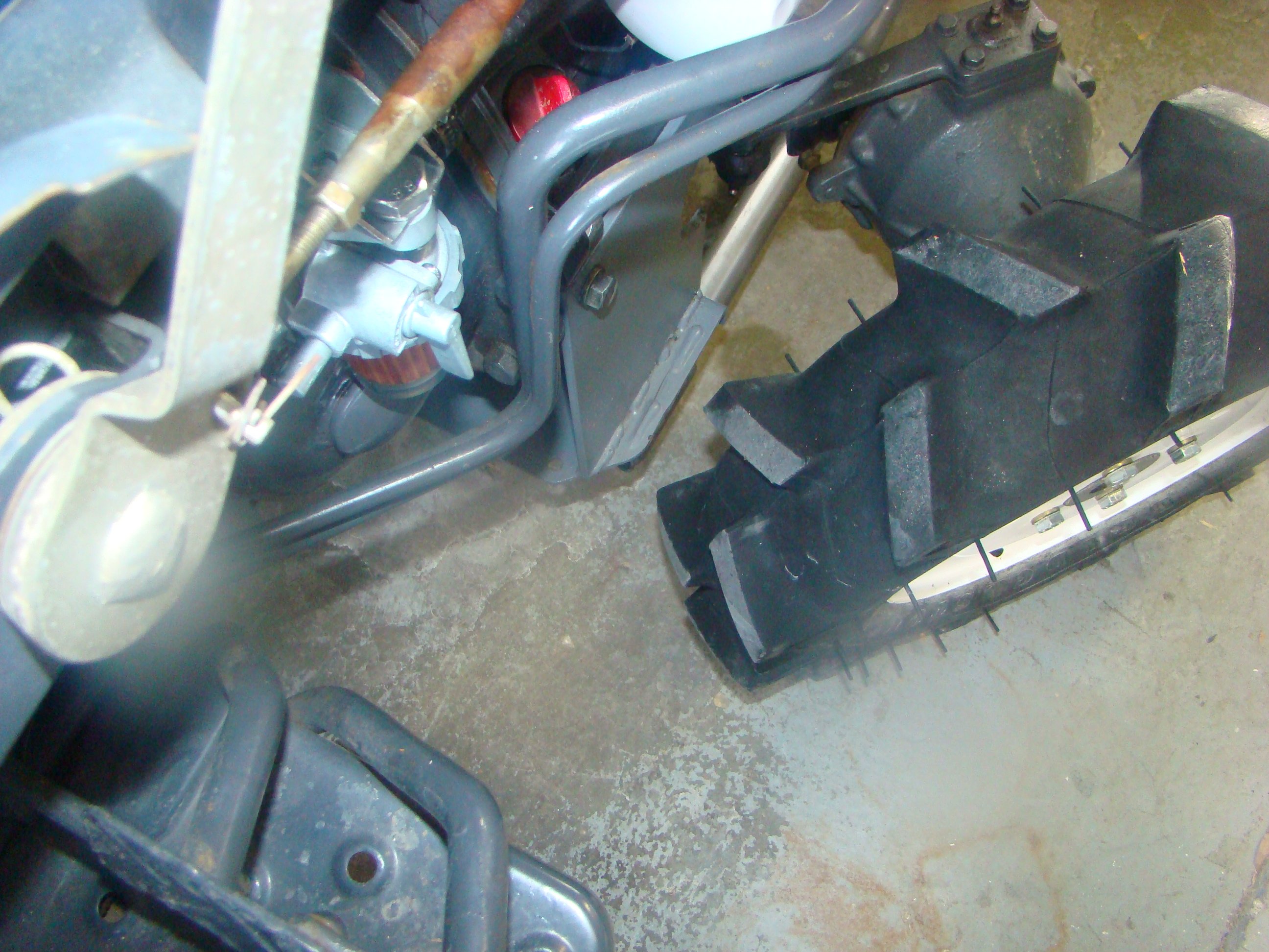

On my tractor I need to move the tires to the outer position to give me more tire clearance while turning. My tires rub if they are in the inner position with a modified blower/plow mount attached to the tractor frame. Instead of reversing the rim, I just made spacers for the added weight and I prefer the dish out to in.
