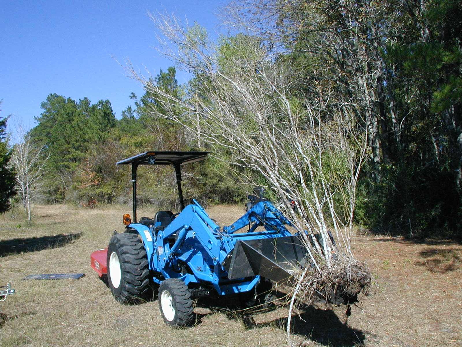

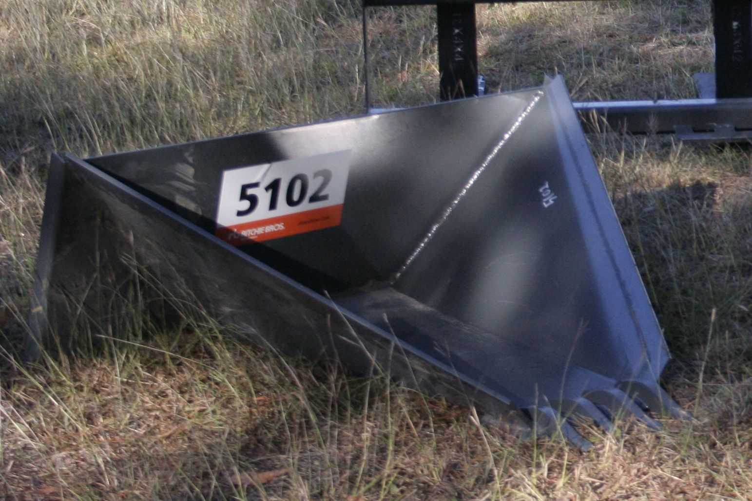

Another option that might work would be a stump bucket like I got last November. I use it more than any other SSQA item. Having a narrow area with teeth makes it easy to cut roots because it concentrates all the cutting/digging force in a small area. It works great on my little CUT so it should be really sweet on a beast like your 7010. I would think rooting out rocks would be a breeze, though you might have to change it out to carry off the really big ones.

I saw those advertised and for the price, I dont know if I could buy the steel and build one as cheap. I dont know how some of the guys on here get so lucky in finding bargain pricing for "scrap" that just fits their needs and then get it at 1/2 the scrap iron pricing or free. I can never find that good a deal. I may have got a small deal on my Kubota 900 RTV @ $8750 but it was not a great deal like some folks here get. As far as scrap steel, I have none, so anything I build I have to buy everything. I guess I will just have to weight the use versus the dollars and see if I will have enough use to justify the cost. My only concern with buying one on the internet is that you cant really tell if they are strong enough to stand up to the 7010. You can put a lot of pressure on something with that tractor without really feeling it.

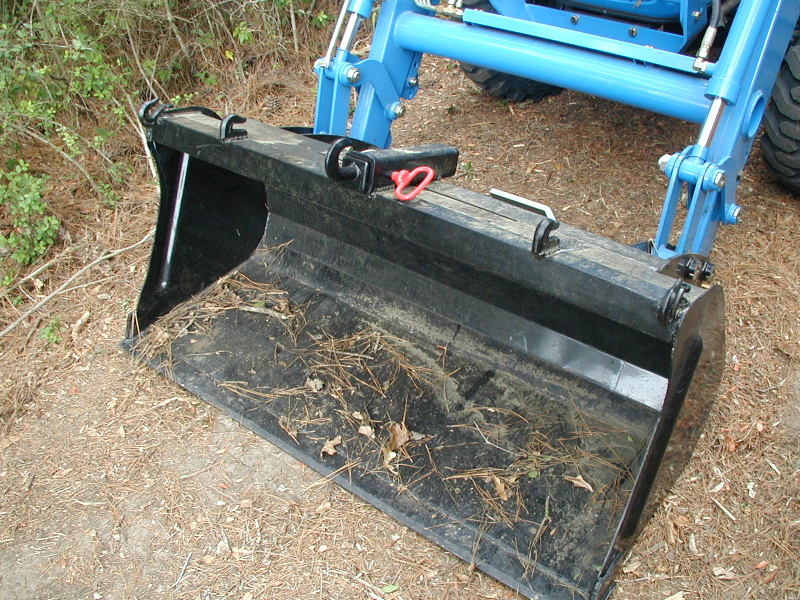

I can't weld either, but I'm going to try to learn. I've got a buddy that can and he's helped me with a couple of projects. (I supply the materials, electricity, and beer while he supplies the skills.) We added 2.5" - 1/4" angle iron to the top of the loader bucket to prevent bends and to provide support for a 2" receiver and some grab hooks. (The dealer added the ones on the edge of the bucket.)

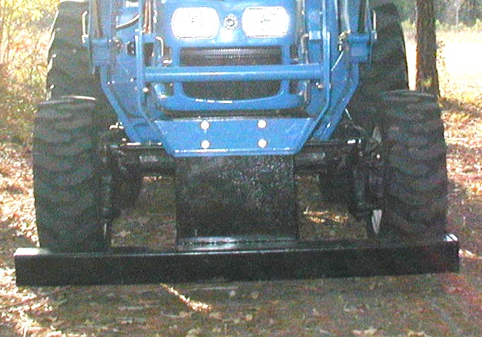

Another guy gave me a 4" square tube - 1/4" steel gate post because I needed something to knock down brush when using the cutter. (I tried using the loader bucket for that but was afraid I'd mess up the loader arms if I accidentally caught dirt or a stump.) There's a place just a couple of miles away that has new and scrap steel. Bought a piece of scrap 1/2" steel plate for the support. We welded it up, drilled 4 holes, primed and painted it, bought longer/stronger/bigger bolts and then mounted it behind the grill guard. I've raised it a couple of inches since the photo because it was a little too low.

The other reason I came up with the brush bumper was because I couldn't see very well with bucket on. Tried using forks instead and that wasn't a whole lot better and not wide enough. When I pulled the FEL off and put the bumper on I had great visibility and maneuverability. And it knocked down all the brush and fire ant hills really well. I hit a hidden 9" diameter stump with it and it stopped me dead in my tracks. No problem as I hog in 2-wheel drive. It even gave a little to cushion the impact. Was totally thrilled with it until I pulled up to put the loader back on and discovered the bumper interfered with the dismount support arms. Had to come up with an alternative method for mounting and unmounting the FEL. I know a lot of people never remove their FEL, but doing so makes it a lot easier to hog in amongst the trees.
