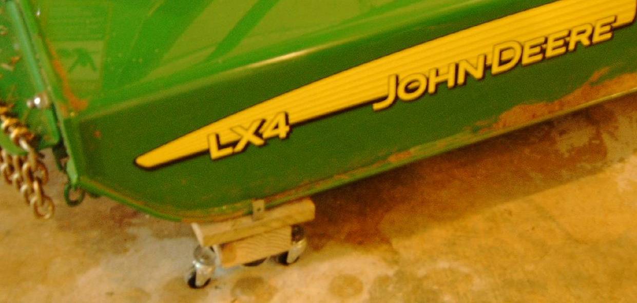

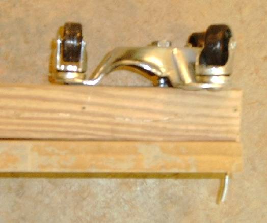

I've heavy duty metal castor wheels attached to 1bys at the end of a 1by that goes the width of the unit. Don't have pictures of this current setup but I'll post pictures of the 3 wheel castors I used that weren't quite up to snuff (wheels broke after a bit of usage).
The single wheels at each end present a slight problem of how to hold them upright while lowering the unit onto the 1by. I just sit a 2by4 on edge underneath one side. There's just enough height to slide the 2by4 back out once the unit sits on the 1by.
Note the dolly shot is upside down.
