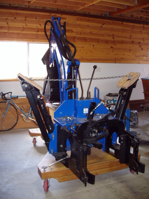

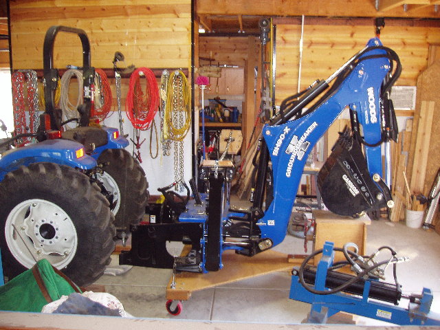

Has anyone made a dolly for a subframe mounted backhoe? I've been thinking of making one based on a pallet and then get a pallet jack to raise and lower the backhoe onto the mounting hooks.
Are you referring to a backhoe with the subframe as part of the BH or the SF as part of the tractor? If you mean the latter, yes I have a Woods BH90-X chained down on a dolly. I use the hydraulic stabilizers ILO a pallet jack to raise/lower the BH for the off/on proceedure. Glad to offer my lumber and plywood build experience, back in my few threads there are two about the build. Not sure if this thread is the place to discuss this, you might want to start a new one or just PM me as needed. Even on a dolly they are sluggish but doable to move around-much easier than no dolly.:)

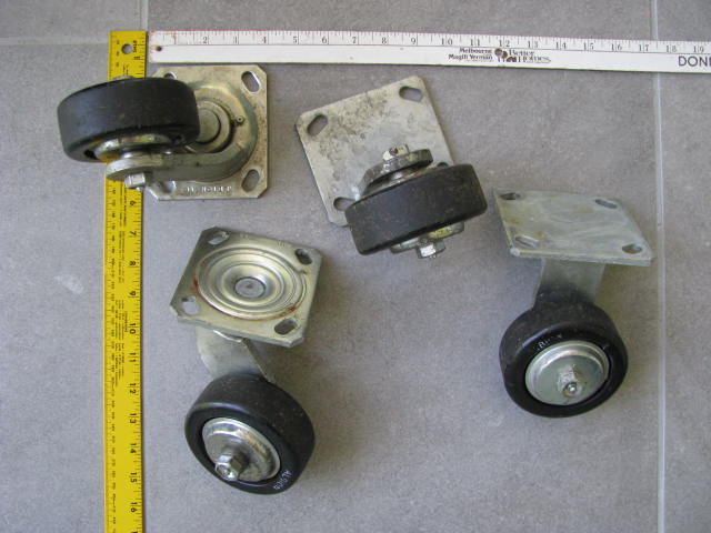

Used INDUSTRIAL CASTERS 4"-5"-6"-8" show up on eBay incredibly cheap from time to time. Type in a search for INDUSTRIAL CASTERS or HEAVY DUTY CASTERS and see what comes up. In April I purchased four, used, 4" industrial casters for $30 delivered. While not specified I would guess-timate capacity is 1,000 pounds each. Mine came from liquidation of a mill in South Carolina.

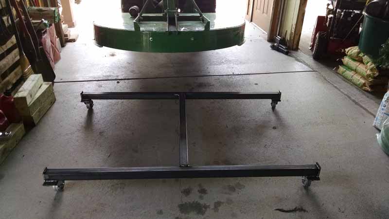

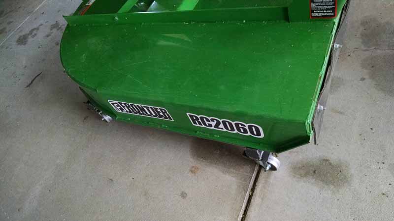

I know this is an old post, but it helped inspire me to build a dolly for my cutter. Had some 3/16" square stock, 1/4" plate, and some casters from another project laying around so I put this thing together, works slick!! No more getting out the tractor to move the cutter around. Thanks for the Post Mike!!
