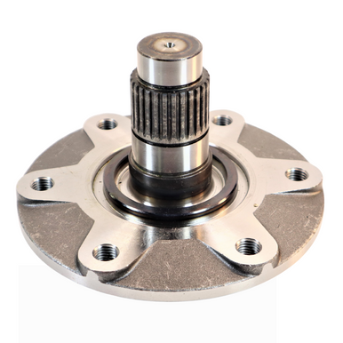

Mahindra warranty isn’t worth the glue they use to stick the 7 year sticker on the side of the tractor with. This is a 2019 2655 hst cab with 300 hours. Front wheel, axle and all fell out while moving sand. It’s been in the shop for 2 weeks and the Mahindra rep, who I can’t talk to, has not authorized repair yet.

Why Lock a thread when we may get an answer at some point?
I like the design some tractors have (mine included) that use a large nut threaded on with a keyed retaining washer that gets bent over a large 6 sided nut as a lock.
For the front shaft to dislodge itself from the housing, the shaft would actually have to break, or the threads would have to be ripped off of the nut /or shaft outer threads.
I think it is also better design than using a circlip to retain the axle shaft.
just some speculation while we wait for Hopefully a positive outcome for both owner and Mahindra.
ps after looking a bit I think this is the design
Notice Mahindra uses "10" bolts to retain the cover assembly.
If I am reading this right it relies on a single snap ring to retain the outer bearing and shaft, in the outer bolt on hub.
The ring gear apparently floats on the shaft splines.
Seal came out on/with the shaft, also in the pic it looks like the shafts (inner bearing) surface is damaged.
