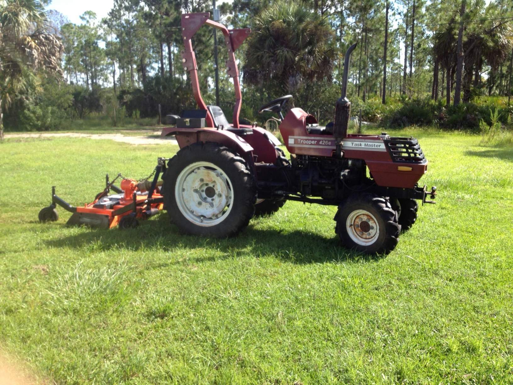

ok got it to run ok then put the 4ft finnish mower on it and ran it up to 2200rpm and in 1st low it loaded it up and had to give wide open throttle to keep it at 2200 and within 20ft it started falling off down to 1800 then 1500 and so on, no power at all and started over heating quick up to 210 and then sputtered and i shut it down even engaging the pto with the mower on wanted to kill the eng no power at all
   / dongfeng tractor with y385t wont start help
#304
here is a pic of the mower

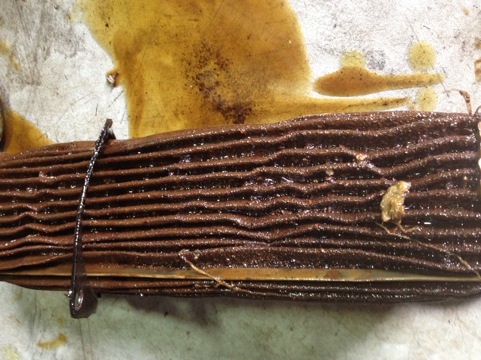

bob I found the problem I am pretty sure, I pulled the hyd filter it has a big one about 9in long and 2.5in wide under the drivers right foot and it was collapsed and slam full of junk (dirt, rocks, parts of jimmy hoffa , hahaha) really it was horrable and collapsed down to about a half in and it poped off both of the end caps, also there was a bunch of garbage still up in the filter holder, kind of looked like it was full of sand and pebbles i took some pics, so I think the hyd system was dead heading but it would take a few turns of the steering wheel or me using the pto and mower for it to go off, rem I would turn to up a small grade and it would happen
#310
here is the hyd filter now does anyone know were i can get one, affordable and circle g dont have them
